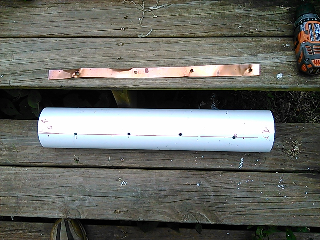

Look through these and see if any of you see any mistakes I need to correct before its WAAAYYY up in the air.
fan-dipole-01.jpeg​

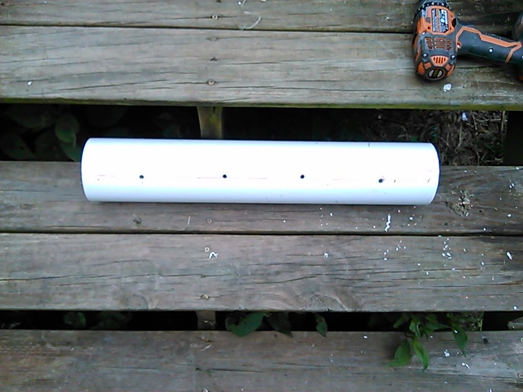

4X24 inch sched 4 PVC. 4 bands, 4 holes, 5.5 inches apart, 4.25 inches from each end.​

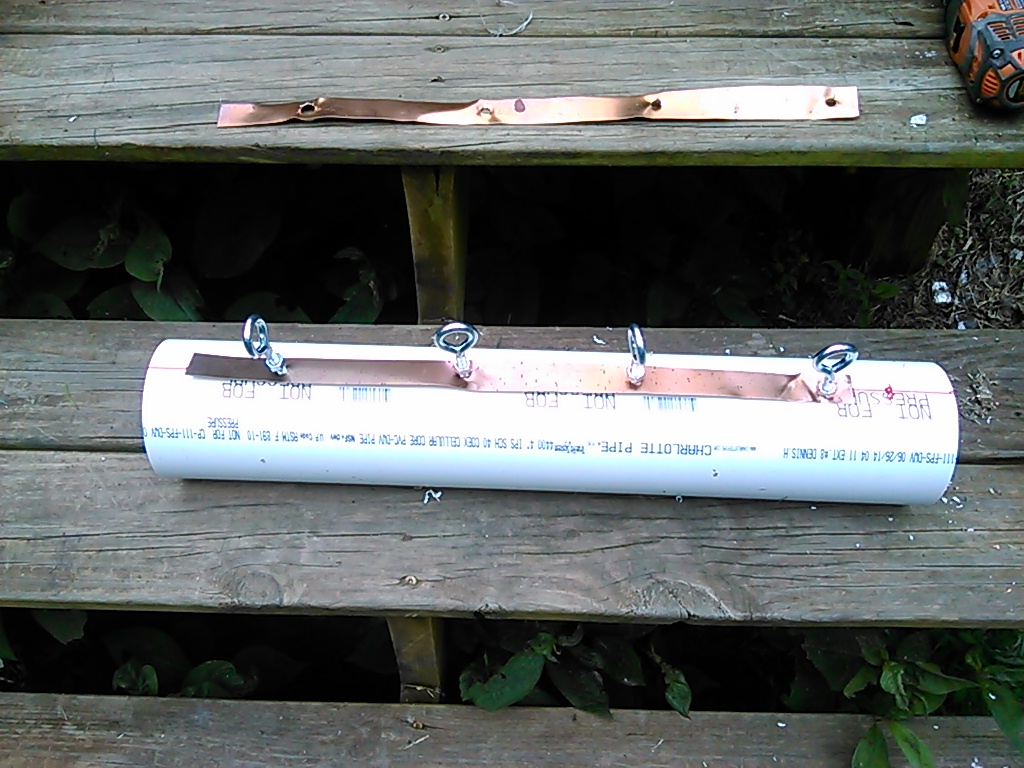

fan-dipole-02.jpeg​
Sheet copper, 2x20 inches, with holes to match the ones in the PVC.​
fan-dipole-03.jpeg​
Second sheet of copper, and 4 eyebolts making sure holes in copper match holes in PVC.​
fan-dipole-04.jpeg​
Holes don't match perfectly, with waves in copper, but are close enough to work.​

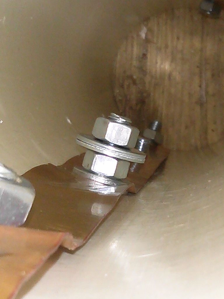

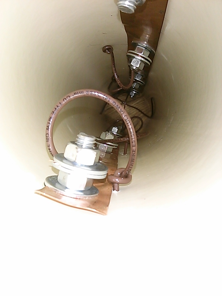

Starting from the outside:
Eyebolt with nut first, then washer, through PVC
Washer
Copper
Washer
Nut
Two washers
Nut
fan-dipole-06.jpeg​
14 AWG stranded copper wire comes in through small hole, and is knotted 6 inches from the end. Wire is clamped between the two adjoining washers.​

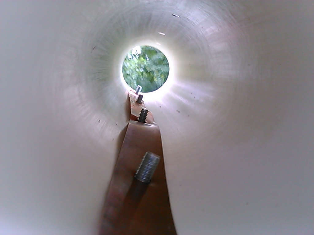

fan-dipole-07.jpeg​
View from the top end of the collector.​

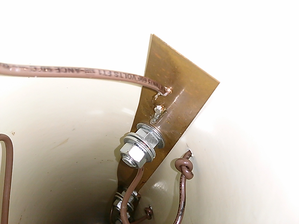

fan-dipole-8.jpeg[/ATTACH]​
View from the bottom end of the collector, a 12 inch wire soldered to each sheet of copper.​

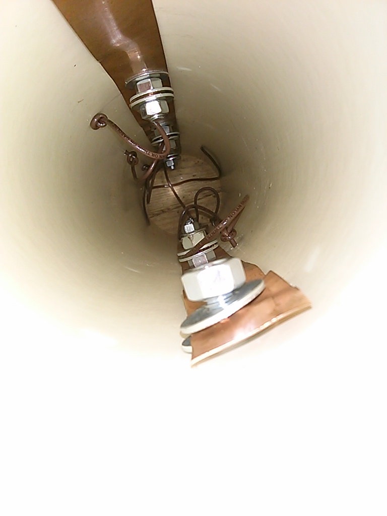

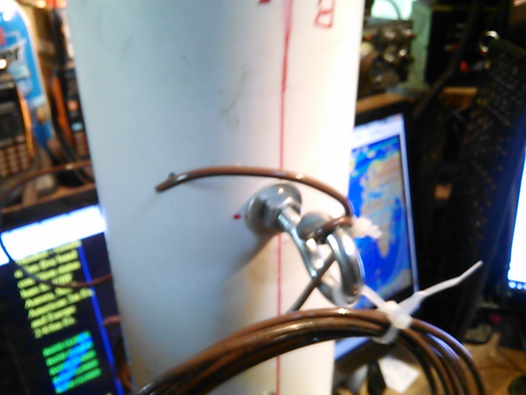

fan-dipole-09.jpeg​
12 inches of wire fed to inside of collector. Its attached to the screw eye with one turn of wire around eye, then two UV resistant zip ties. I hope the tiny coild of wire around the screw eye doesn't cause issues.​

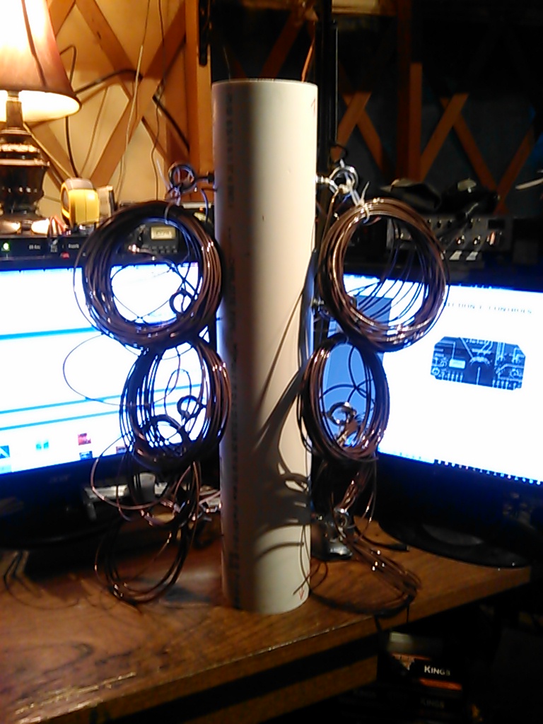

fan-dipole-10.jpeg​
Finished except for closing it up, attaching the balun, and hanging the thing!​
