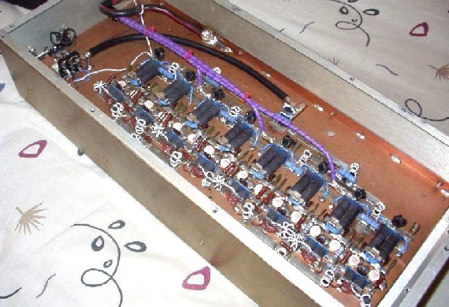

I'd recommend a 16 x 2sc2879 amp with genuine Toshiba transistors or 24 x dei 2879 transistors for breathing room .
For every 10 watts out of the radio I recommend one Toshiba 2sc2879
