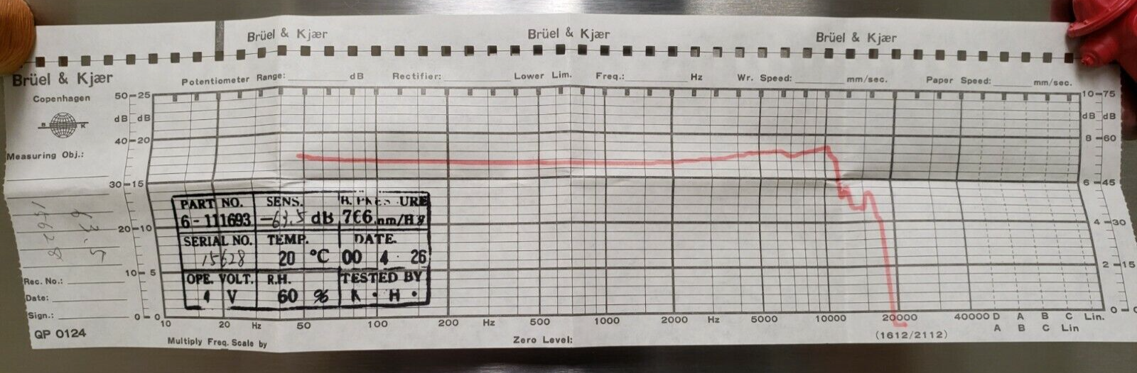

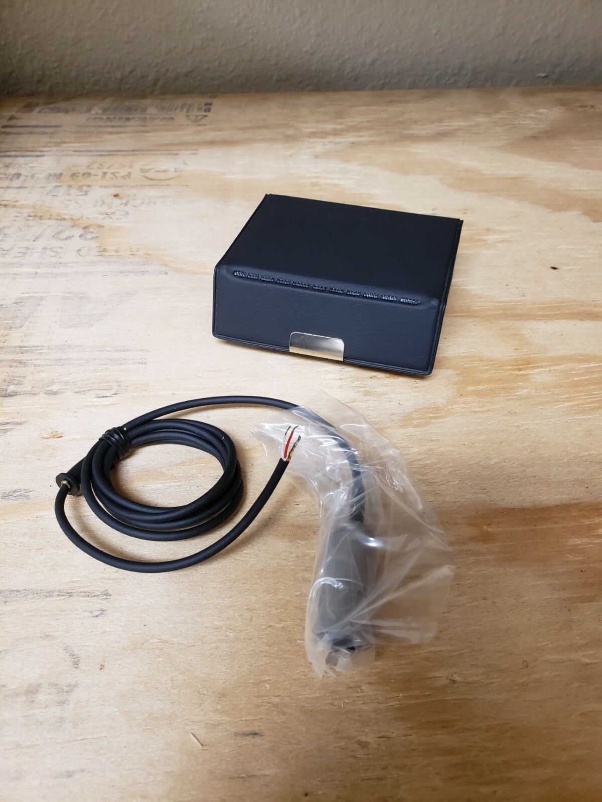

Primo 6-111693 Microphone NEW W/ B&K CAL CERT!! It Bruel & Kjaer
I have been using these for years. I posted about them a few years back. I think I have still have 4 new in the box. I think I paid between $24 to $36 back when I first posted about them. I found them on Ebay and they still have about 13 left!
If you want to build or modify a mic to sound like a $2000 microphone on a budget this is the ticket get them while they are hot. If you do hifi or eSSB and like electret mic's this is as good as it will ever get for you!
You can find them on that famous action sight we all have a love/hate relationship with. They seller is asking $50 OBE.
Given the ever increasing price of things and the true studio quality of this items and fantastic price point I wanted to pass it on a second time.

If you look at the factory certification I posted inside the black inked box bottom left it tells you that the supplied results were achieved @4V. I do not have documentation for them so I do not know the upper limit. So blocking cap and resistor.
