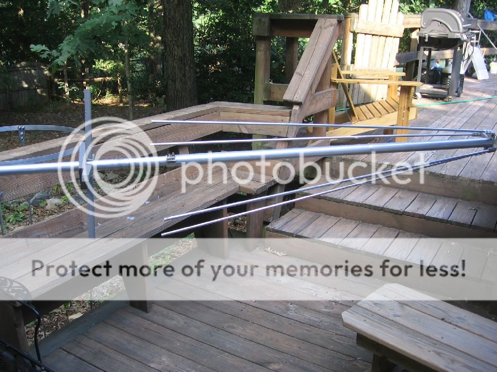

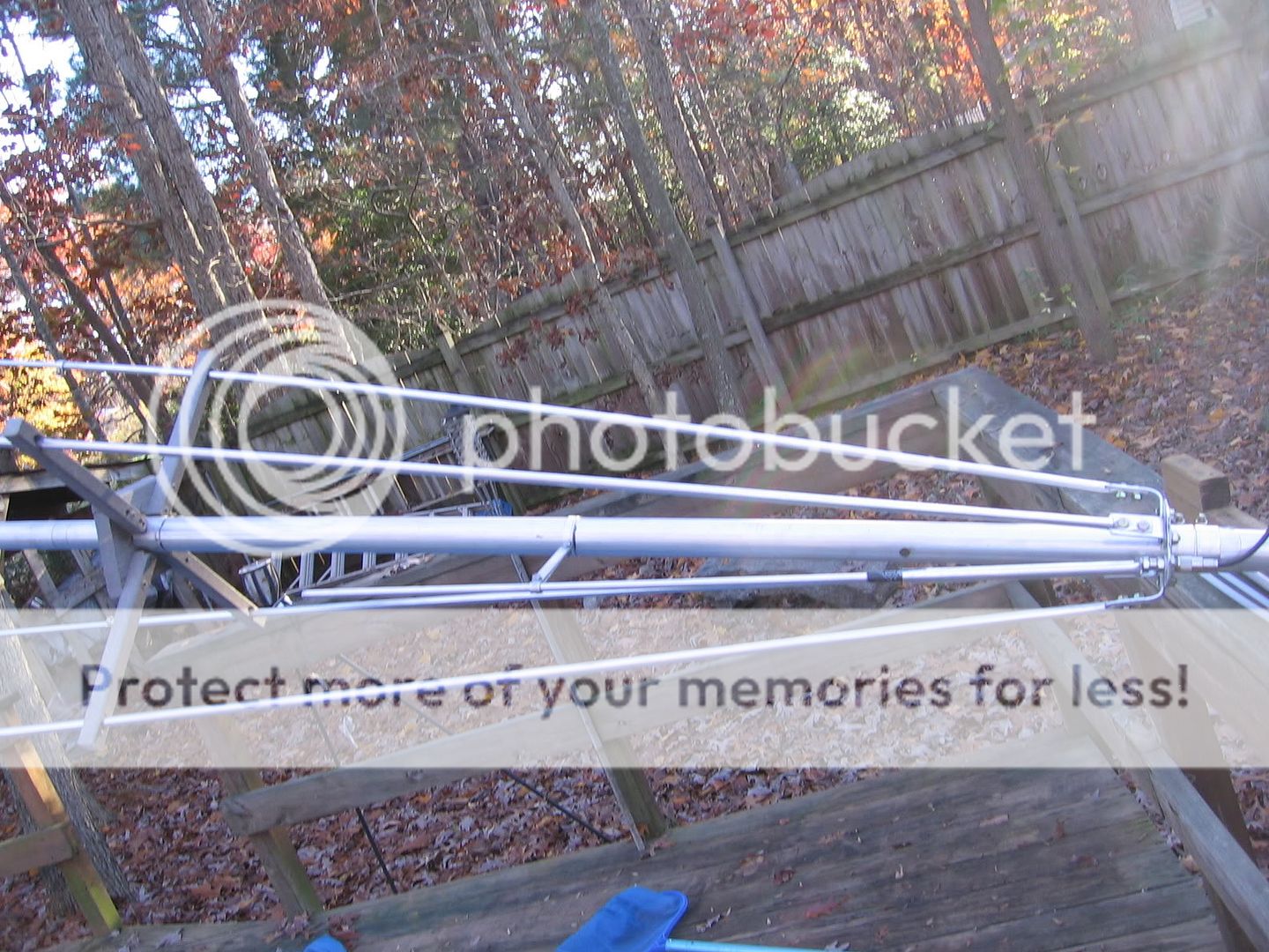

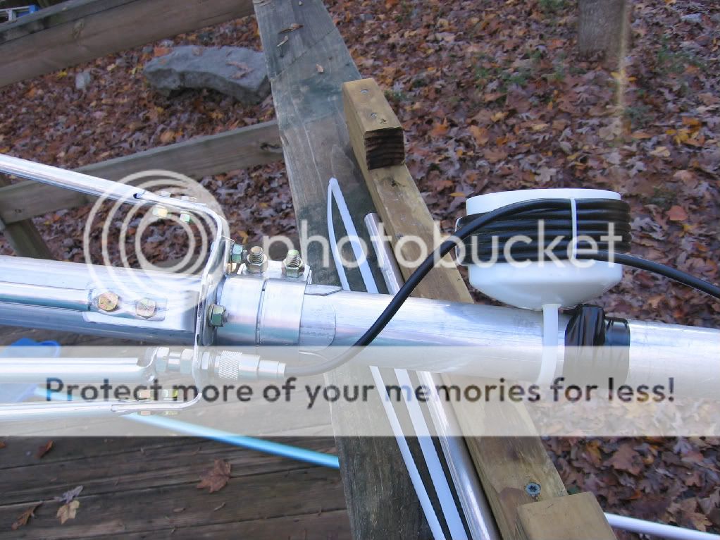

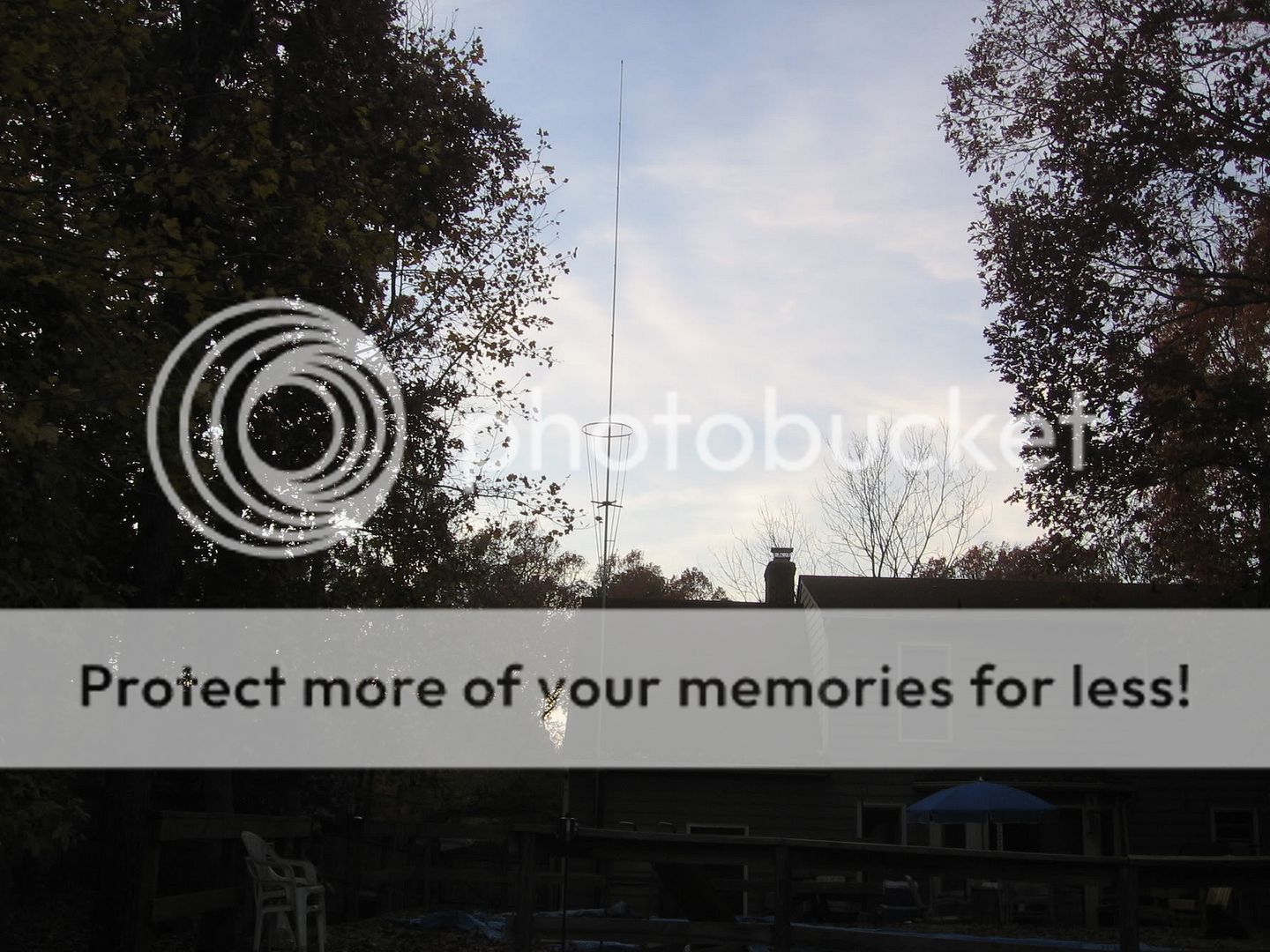

ill be damned if i know . i only run a little 2 pill so power handling is a moot point for me . i'm guessing the weak point power wise is either the mobile stud or the plumbers tape and electrical tape used as a insulator in the gamma . just a wild guess , id say a kilowatt or 2 shouldn't be a problem . the gamma uses 3/8 solid rod and 5/8 .058 wall tube , with a better insulator and a better SO-239 or direct fed id suspect several kilowatts shouldn't be a problem ... maybe even 10k ?????? . i'm purely guessing though .

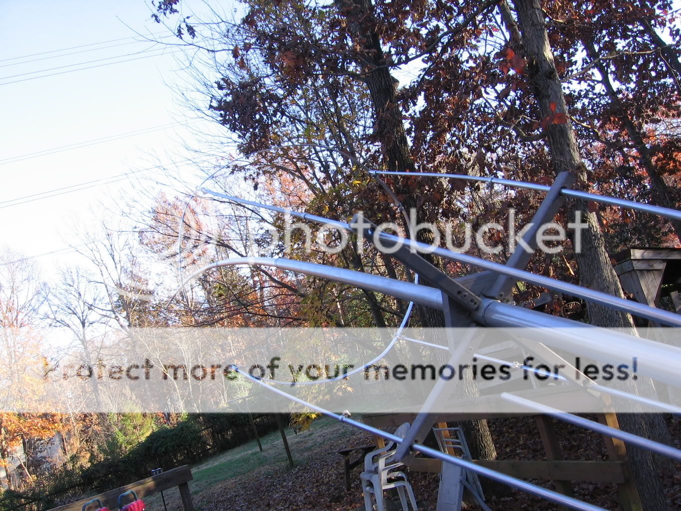

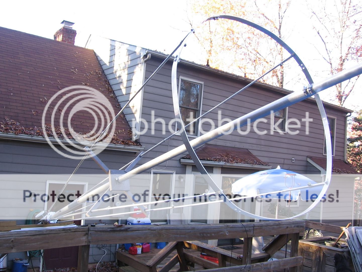

i finally seem to have a grip on it though :thumbup1: changing the bottom L's for the basket elements added a lot of strength and stiffness to them .
and i got the OK from the landlord for my 18 ft tilting mast idea , so this will be up a 1/2 WL in about 2 weeks :thumbup:

its up in the air . no coax on it , im beat , my back is aching , ill get it tuned and on the air tomorrow .
i did make a few changes to the antenna , ill post pics of those tomorrow also .
as long as it's non-conductive and physically strong enough it can be made to work . if you have actual pdl2 hubs i wouldn't modify them .
