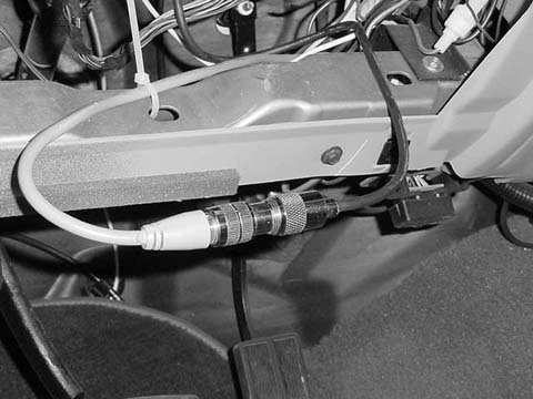

I would like to add if you have the ability to;
- get a barrel connector - two SO-239 so you can put the jumper in with the antenna join the coax together and check SWR - they can join the coax jumper to the one that goes to the antenna and if all that tied together and the SWR is still low - you solved a step and you can rest easy to continue with putting this together...
These, above, are for RG-58 or RG-8 - or 50 ohm impedance systems - like your's
Why the Barrel connector? Because - if you have a problem with the antenna, it's location or the radio doesn't seem to work well or you encounter mounting problems of if the jumper you want to use not of good quality, these quirks are going to cause a reaction or reflection in the system.
It will also help you when you need to remove the amp for service - you can just join the two cables together and continue on using the radio like normal. Like a break point. Take out amp, join cables together - life goes on.

Notice there are two types of coax being connected above...
Can you spot the pre-made and recognize the hand-made one?
See the difference?
