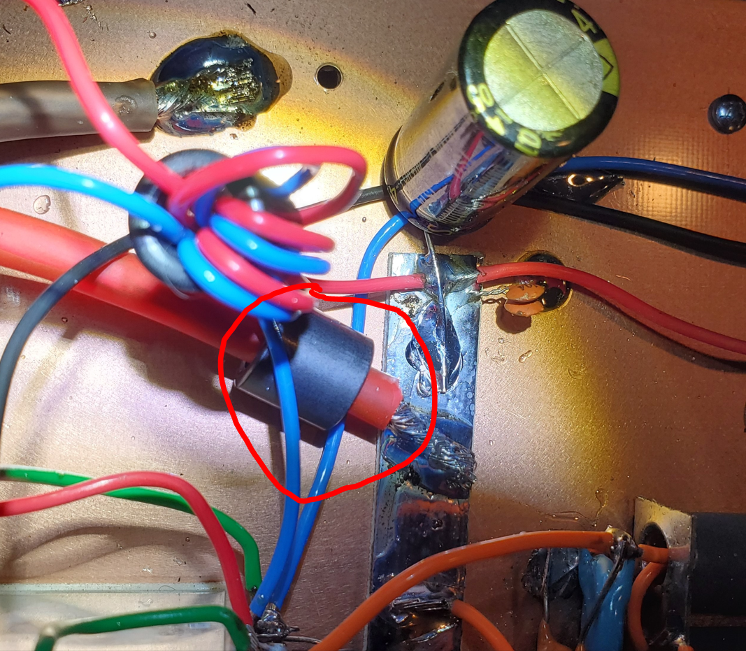

I am in the process of replacing the much-too-short 8 awg power cables on my 200HDC with six foot long 6 awg cables. The outer diameter of the new 6 awg positive cable is 10mm and this is too large to fit inside the ring that the current 8 awg wire goes through right before where it is soldered onto a bar. I assume this ring is important so I want to replace it with the right one that fits this larger OD cable.
Any chance any of you folks know what I should use here?

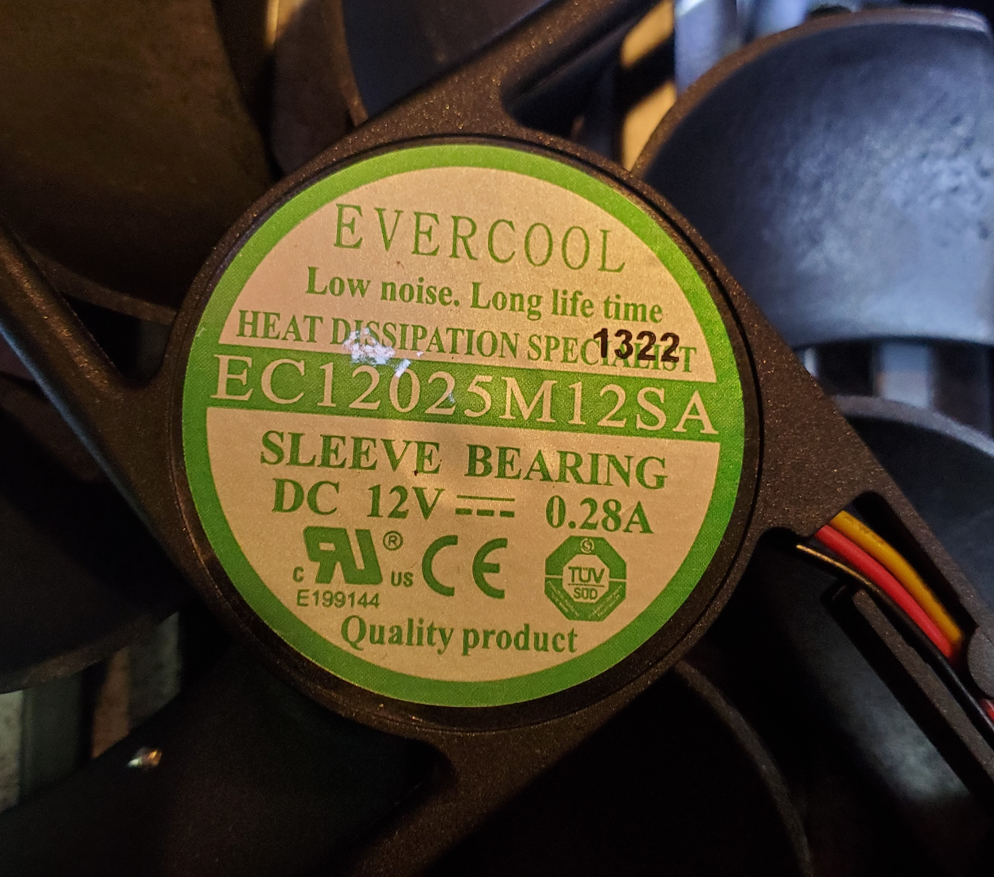

In case anyone is interested/curious, this is the fan that came in my new 200HDC. I'm going to see if I can find a different fan that fits, keeps the amp safely cooled but is a bit less boisterous when doing so. Who knows, this may turn out to be a snipe hunt but I won't know for sure until I look.
its more than likely a type 43 ferrite bead. you can get them in different sizes and different inner diameters. they are called by different names but are bassically the same thing ferrite bead, ferrite ring, ferrite core. just one of many suppliers for an example. https://www.kf7p.com/KF7P/Ferrite_chokes.html
why not just put like a 2 watt series resistor inline to cut the fan speed down. alot cheaper than a new fan.
Thanks for the info. I will do some digging and see if I can find one that looks like it would be a good fit for the new 10mm 6awg cable.
Another cheap Evercool sleeve bearing fan that should not be mounted horizontally. I have seen the same fan on Fatboy amps too.
Mainly because I don't know this type of basic stuff yet. I have a lot to learn.
It's all good. Think of it like this. In your car the fan for the heat or AC has say 4 speed settings for air flow. All the control does is vary the voltage to the fan. So wide open at 14.xx volts the fan is on hi, by the time you get down to the lowest speed that blower is maybe only getting say 5 volts.
So on your fan adding a resistor will slow it down. If you ever blow that fan the other thing you can do is replace it with a 24 volt fan that's the same size. By running that fan at only 13.8 volts it will be very quiet and still move plenty of air. Good luck.

That bead is there as a choke to help stop RF from getting back into the power supply.
It would not hurt to have a couple.

Does the bead have to be inside the case close to the solder point where it is now or will it also work if it is just outside the case? If it is outside the case it looks like it gives me more options for size/length/number of them and also clamp on too instead of just slip on. The clamp-on style looks too big to fit well inside the case plus not too sure if it'd be too hot for it in there.
