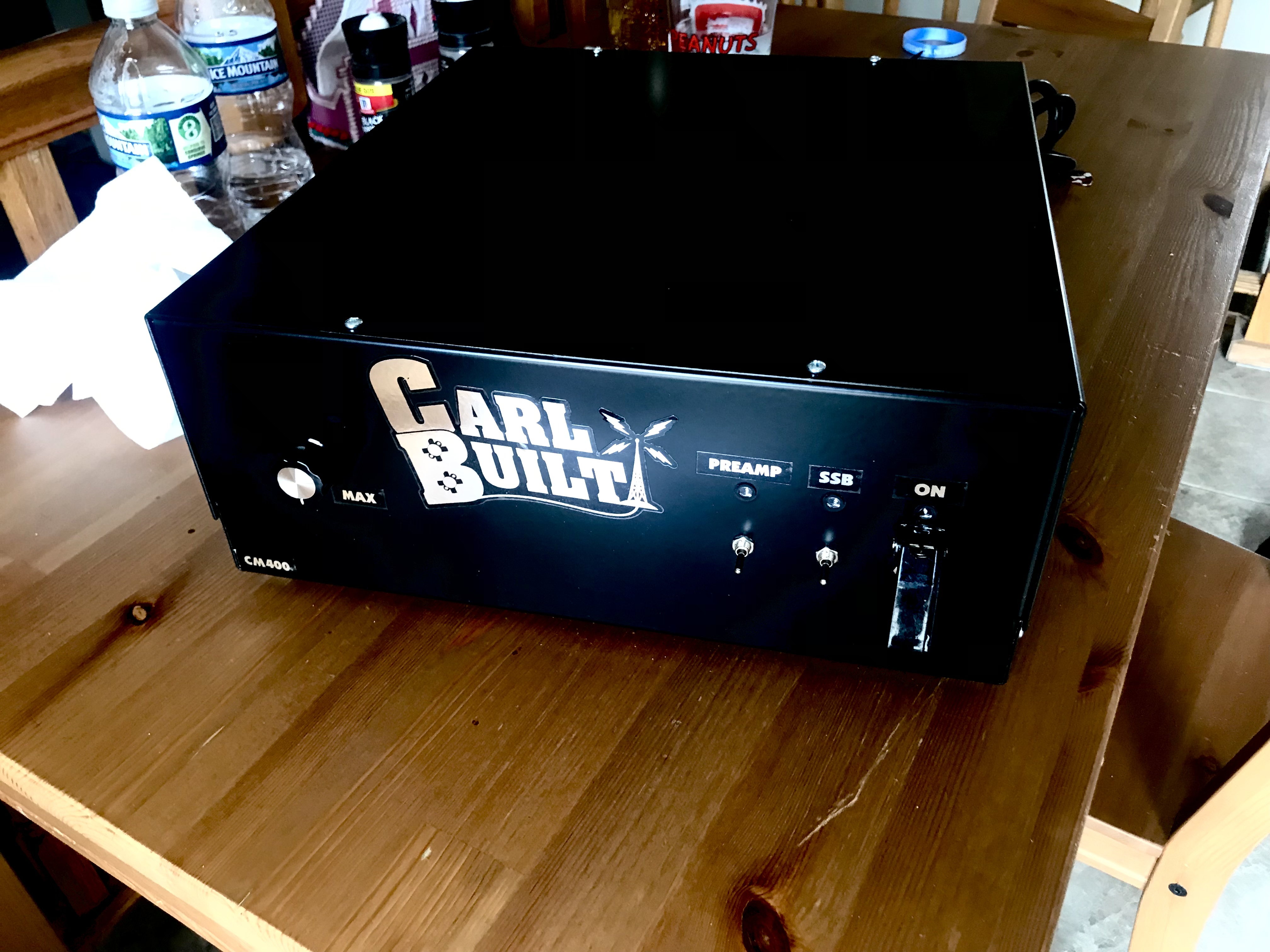

8A6A093D-990D-4975-B3B0-DADA83F9E134.jpegNew Carl Built base 1x4. All 2879’s. Very clean audio, great reports. Everyone says it sounds wicked. And the preamp is the best I’ve ever heard. Very happy with it. Works great with all my single final and tube radios.
