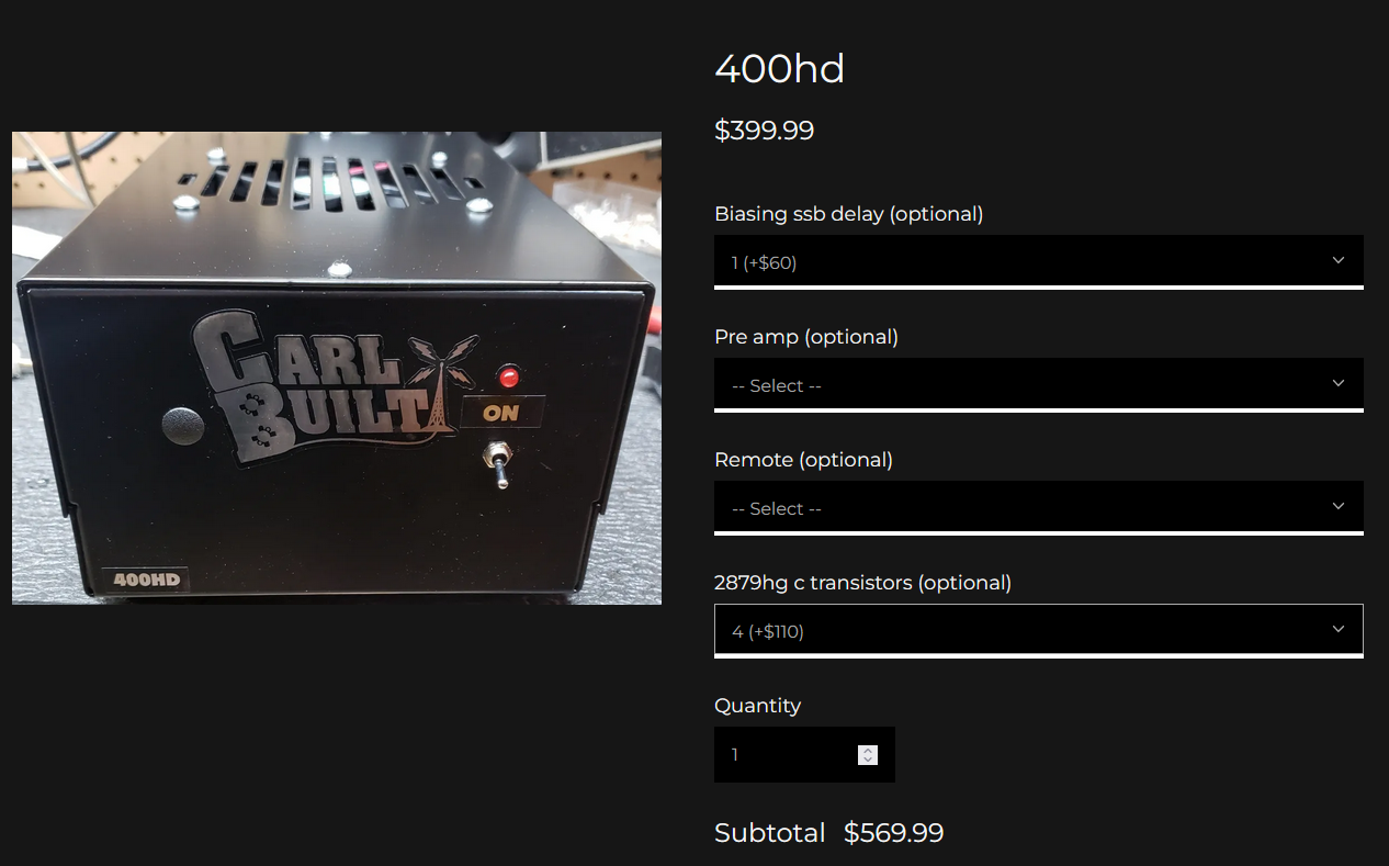

I have an Anytone AT-5555N II and a President Lincoln II+ (V4), both purchased from and gone over by Scott's Radios. Do you think the following amp would be a good SSB choice for these two radios? I don't know if/why the optional 2879hg transistors are worth it for the extra cost but I plan on having this for a long time.
I know the 5555 is a hotter rig than the Lincoln and it really does not matter which one I use since I like them both. The other will just be used as-is out in the truck.

The Lincoln 2+ backed by a Carl Built 400hd is one of the combinations I run. It will run approximately 600pep on AM and SSB. This combo sounds awesome on the air and never gets hot no matter how long its keyed up. Be sure your electrical system is solid, I'm running a 220 amp alternator and a 500F super cap to keep the voltage steady. The "C" pills aren't worth it unless you are wanting to drive the snot out of the box.

It sounds like given my requirements that I would be okay not upgrading to the C transistors. But down inside I can't count the number of times I have regretted not doing an upgrade as part of the initial purchase e.g. new car or motorcycle or snowmobile or, well, really anything. That said, I have no interest in throwing away $110 for the upgraded transistors if it will not even be noticed by me. Then again, maybe they will provide me with a bit more of a safety margin and I have recently proven that I still need that even at my advancing age. Waffle waffle waffle.
I will be ordering this on Monday and right now my decision is to go with the upgraded pills.

I have read, but not tested this, the db gain ratio is supposed to be less on the C pills. Hopefully others who have tested this will chime in.
Two pill 2879C base at 14.5 volts will easily get 450 to 500 watts with a completely stock Anytone 6666. I know because I have one that I just got from a local tech.
It was actually a 4 pill Toshiba 2879 that finally bit the dust, and was rebuilt to a two pill 2879C box with B bias. I was very surprised at the performance of the 2879C transistors. Around about a 5 watt carrier from the radio equals a 100 watt carrier, and it just swings from there.
