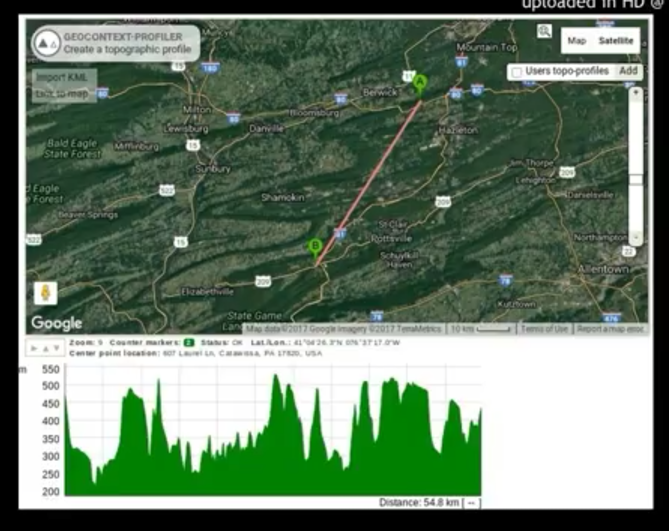

I'd say the majority of the time on flat ground there's no excuse for not being able to hear a stock Cobra 29 30 miles away.
( mobile to mobile and probably greater if someone has a base antenna high in the air)

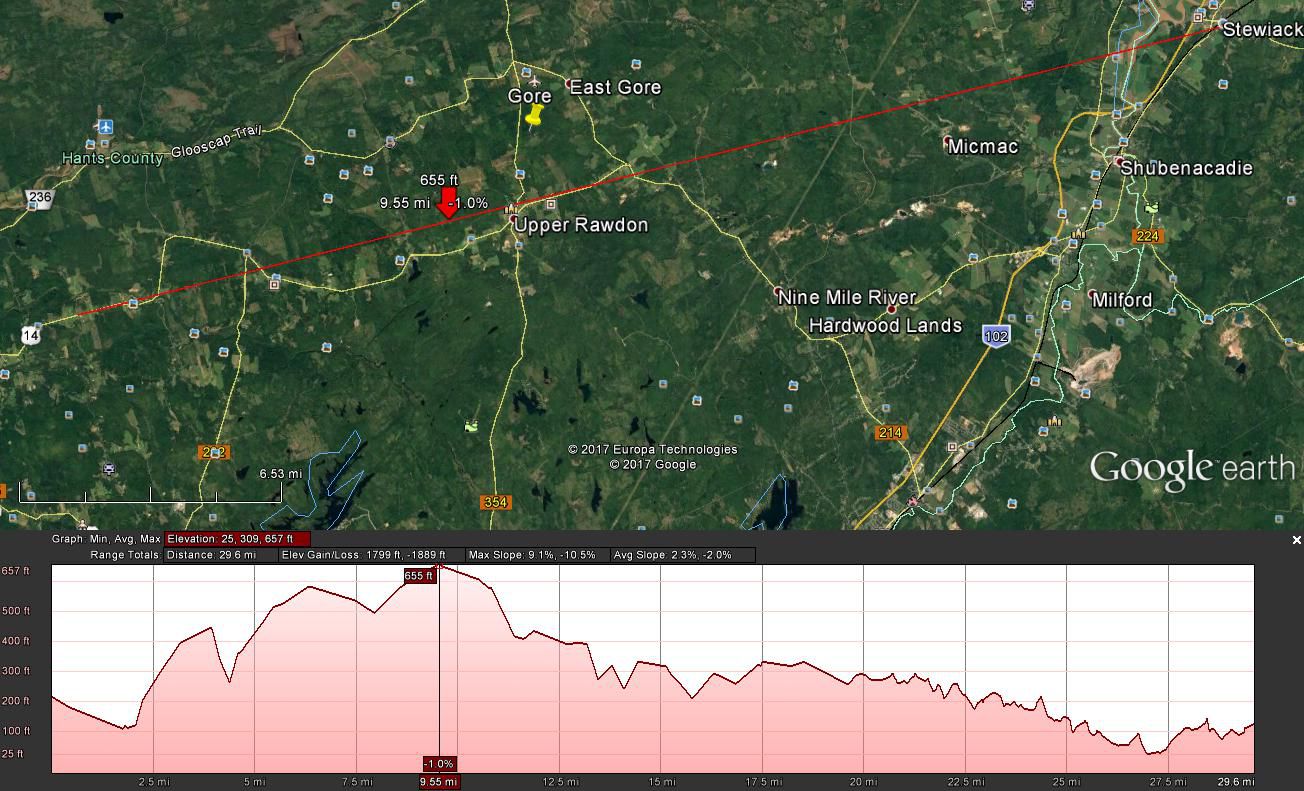

Flat ground yes but that elevation profile you show above is far from flat. You have deviations of more than 300m which is over 1000 feet. From any two peaks I say yes but from a distant valley in that profile I say no it won't happen reliably at all. If you want flat ground try in the western plains area like Kansas. LOL I don't care how quiet it is or how good your radio is you won't do 30 miles mobile to mobile here with stock 4 watts. Just far to much terrain in the way for that to happen unless both were at a peak and were stationary. This is an elevation profile from a buddies place into a town he talks too. He has a 350 foot rise at about 3 miles out. Not a good situation. Again.......it depends on the terrain whether 4 watts mobile-mobile will make it. I know some places around here where 12 watts on SSB and a four element beam would be hard pressed to make 30-40 miles on a good day. Receiver sensitivity had nothing to do with it. Good amateur gear with decent preamps were used. There is simply no path due to terrain.

This is an everyday thing for me.
Sure he disappears when he gets into the very bottoms of those Canyons but I can generally hear him the majority of the time even when mountains are between us that are greater in elevation than my position or his position.

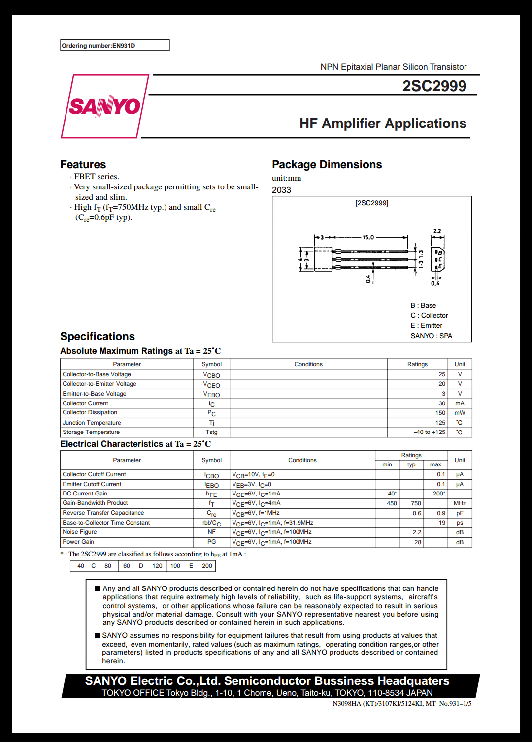

4 Watts at this distance probably isn't going to happen without the 2SC2999.
