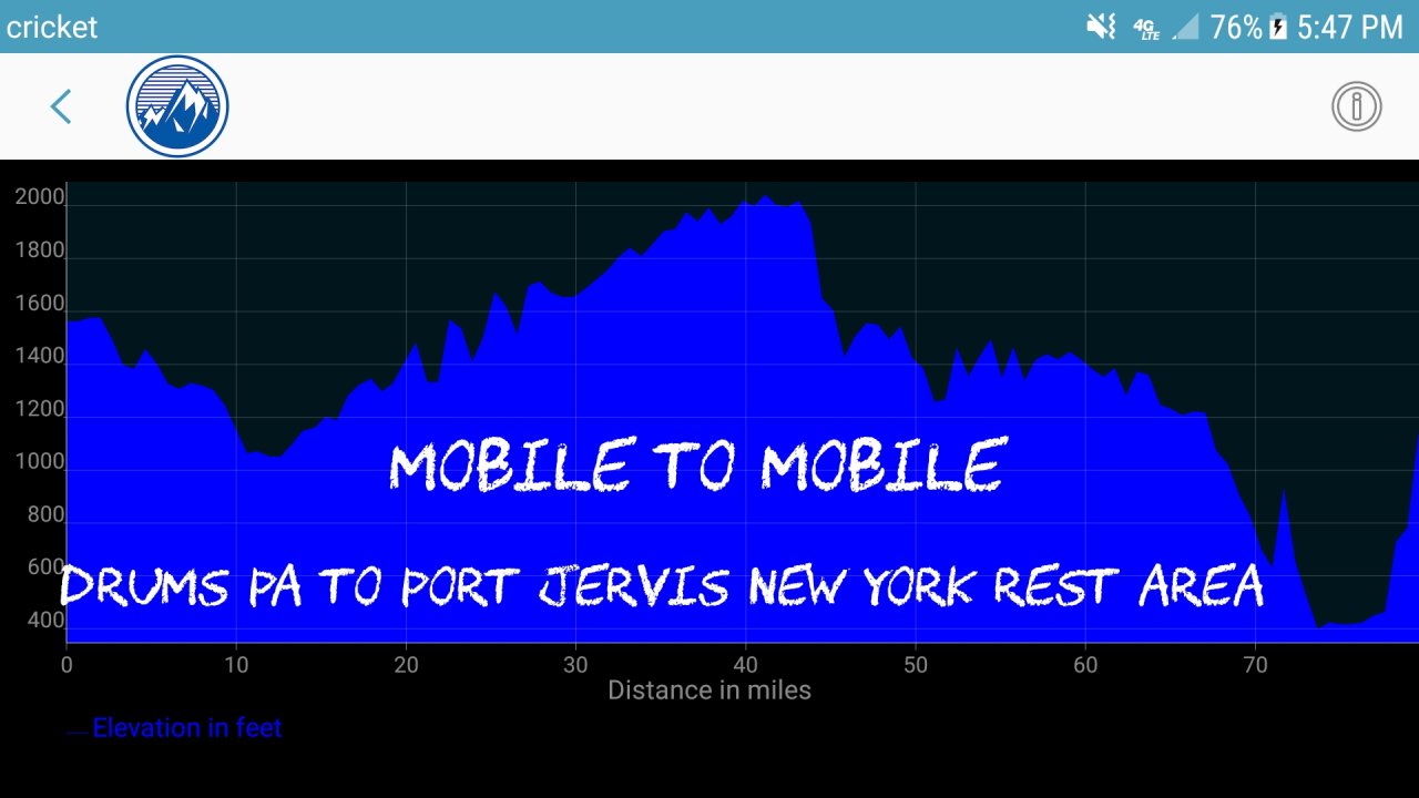

Groundwave is quite common at that distance. Here is the best I've done mobile to mobile on AM.
Reactions: codeman
Actually the term "ground wave" is one of those often used but most misunderstood terms. Technically it was NOT groundwave since groundwave propagation does not occur nearly that high in frequency and dies out in the bottom of the HF range after about 3 MHz. Most CBers however refer to any contact not DX or bounced off the ionosphere as groundwave. The actual mode of propagation was likely surface wave.
