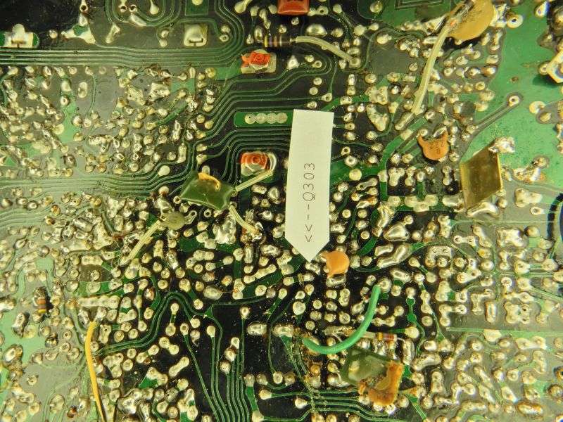

The incredibly weak receive seemed baffling. The output of the 5351 DDS chip was connected to TP311, the output of the VCO buffer transistor. I reasoned that insufficient drive level from that point to the two mixer circuits would hold back receive and transmit signals. And then I discovered that the factory VCO circuits were still running. Yeah, two VCOs. One for AM and LSB, the other one for USB. Removing C305 and C307 took them out of the picture. Two local-oscillator signals together made the 'scope trace at TP311 way too fuzzy. I moved the output of the DDS to the gate of Q303, where the original VCOs fed into. Figured it would improve the level at TP311. Receiver is still weak, and still no transmit.

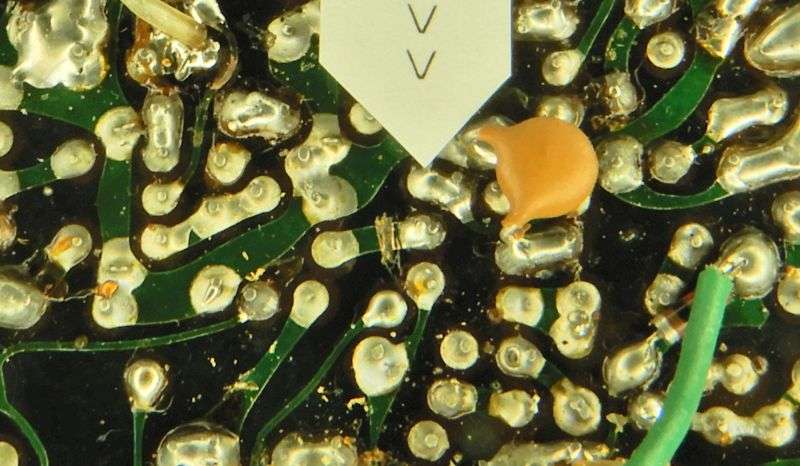

A closer view of the collector trace.
I cut the trace with the power on. As soon as it was severed, the receiver roared to life. Previously had to turn the volume full up to hear much at all. Turns out now it transmits, too.
