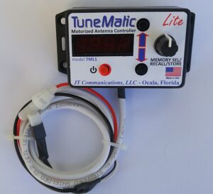

Cool. Found this company in the US:
http://www.tunematic.us/
Price seems right at $140.

That particular model only has 20 memories, hence named "Lite" I figured for the price, you could try it out and see if muti-band mobile HF is for you.
The more expen$ive units have up to 1000+ memorie$.
To be clear, there's a big difference between a TuneMatic or any other screwdriver antenna controller, vs. an antenna tuner (match). The controller moves the motorized screwdriver antenna to the correct length to lower SWR, vs. an antenna tuner/matcher that matches the antenna system to 50 ohms (or close to it).

the way the screwdriver controllers work is they have a base reference point and you adjust the antenna for the position you want and the controller writes the number of motor turns into memory.
when you tell the controller to "tune" the antenna, it counts the number of motor turns and adjusts the antenna back to the position you had set.
