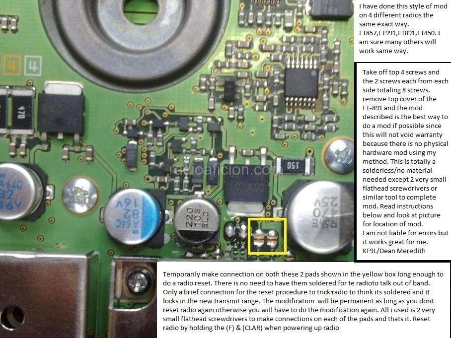

I have done it to my radio. It works. I was confused by some of the pictures posted online because the shorted solder pads did not resemble mine. I figured the pictures were from European models, but the two pads indicated are the correct pads to short.
It is a tight space, so use a very fine soldering tip, or if you have some SMD components and a hot air rework station, do it up right, but I used solder and it works. You can also use a conductive pen, but it was too tight a space for me to do so successfully.
Picked up another 891. I think I'll try shorting the pads as described in this mod. Apparently, it stays expanded until the radio is hard reset.

Just a head’s up on the 891 mod... I had bought my 891 within a year of the radio being released (and got hosed by Yaesu when they dropped the price, as they always do). I have a friend who bought an 891 in 2019 and when I went to do the mod, the arrangement of shorted pads from the factory was different from the photos online.
It’s been a while since I saw the inside of his radio, so I don’t remember what exactly was different (may have been no shorted pads from the factory ???), but due to Yaesu changing something in there, I did not do the mod as I didn’t know what the outcome would be (especially when dealing with someone else’s radio). Yaesu’s recent history with firmware updates makes me hesitant to do any mod that is not well documented.

This is my 4th 891. I've always soldered the pads. I've never tried the temporary shorting mod yet.

Should work...IF you can manipulate the screwdrivers while doing a reset on the radio (I seem to remember having to do a reset after the solder mod). Those solder pads in the 891 are in a tight space.

Yes! I think I posted the results. I tried it a bunch of times. Just couldn't get it work. Finally got bent and whipped the iron out.

It's somewhat easy to mod. The pads are in a tight spot, is all. Just use a small short pencil iron. I have an elderly friend that uses the liquid solder stuff. Just dip a toothpick in it and bridge the pads. He's done two radios so far. It's all he uses now. The FT-891 is a most excellent radio. Just a damn fine rig. Can't beat the price on them.
