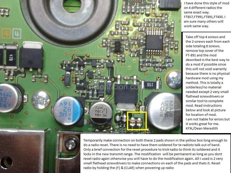

FT-891...anyone try this mod?
It's somewhat easy to mod. The pads are in a tight spot, is all. Just use a small short pencil iron. I have an elderly friend that uses the liquid solder stuff. Just dip a toothpick in it and bridge the pads. He's done two radios so far. It's all he uses now. The FT-891 is a most excellent radio. Just a damn fine rig. Can't beat the price on them.

As gigaparts does this mod I went that route. Amazingly, it’s due here today with the “free shipping” option. Not complaining.

Mine was already done but didnt resemble the online pics. I had to extensively repair mine. The ipo and attenuator didnt work. Blown surface mount resistor. Also burnt up trace on amp keying circuit. Guy hooked a sb200 to it directly. No soft key.

So I have an 891 and I preformed this mod with the liquid solder which was easy to use. When I restart it the radio transmits from 1.8Mhz to 29.99Mhz and 50 to 53.99Mhz. I was really hoping to be able to transmit in the lowband VHF as it is darn near impossible to find low band radios anymore. Have I done the mod wrong? Can anyone confirm transmit in the 30-50mhz range? Thank you
Removing the speaker makes this much easier. The speaker magnet housing is held by a rubber gasket (the speaker just pulls out) and then unplugs from the main board. I just did the mod with a fine tip soldering iron and flux pen. A little flux between the pads and then solder on the tip of the iron joined the pads cleanly. I did the pads closer to the edge of the case first because the space is a little tighter and I didn't want to do the easier pads and then possibly mess that joint up bridging the other.
