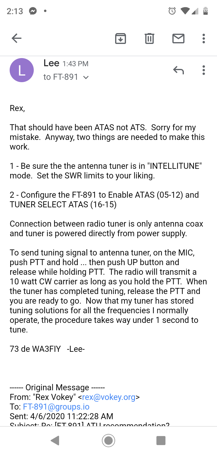

You can select ATAS in menu and intiate a 10 watt carrier to tune. Press and hold PTT, then push and release up button. It will key 10 watts. Release PTT when done.

Tune button won't do anything unless you have an ATAS, I do believe. If you use an interface cable, I believe you must push tune button on the tuner itself. Use the mic method to throw a 10 watt carrier.
