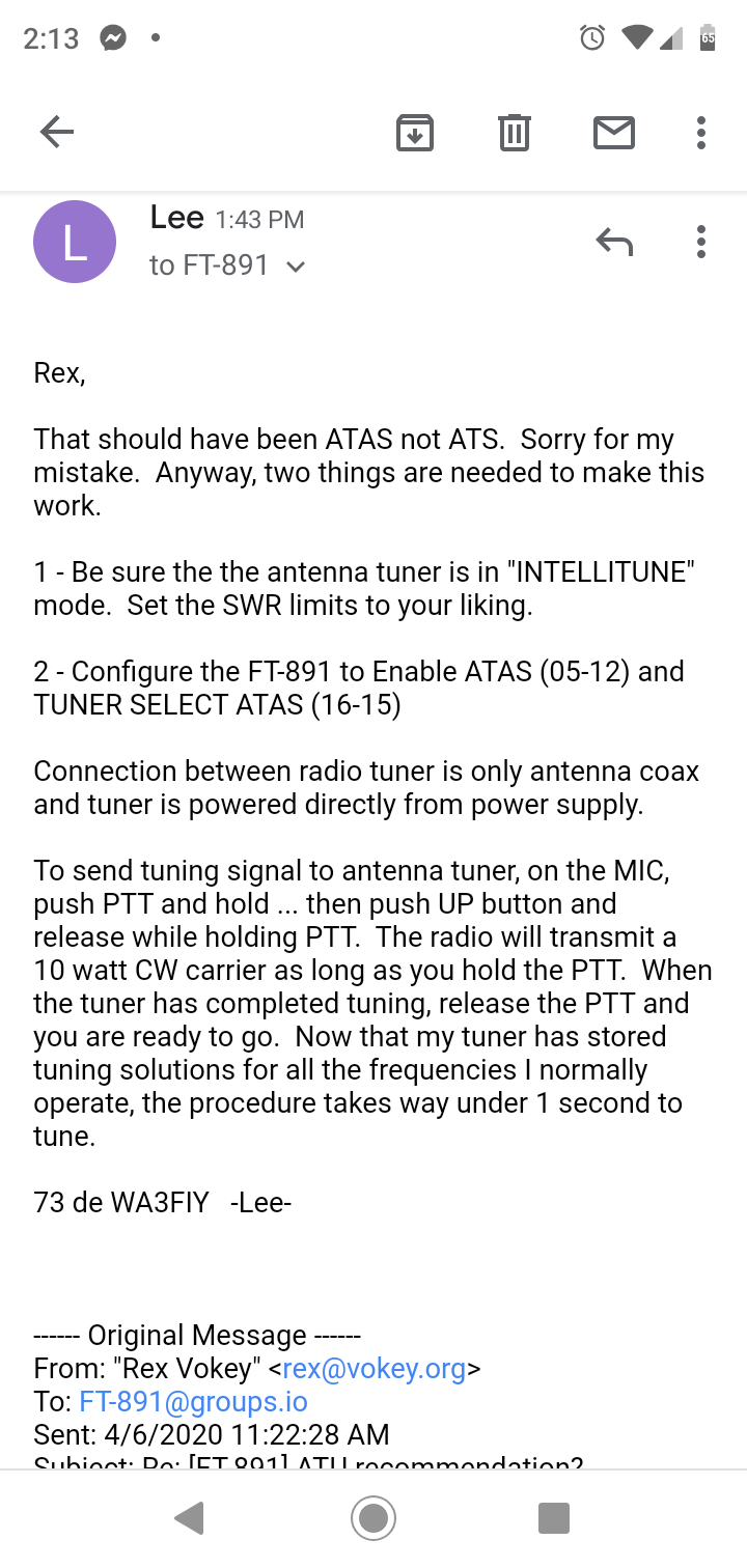

View attachment 36024 You can select ATAS in menu and intiate a 10 watt carrier to tune. Press and hold PTT, then push and release up button. It will key 10 watts. Release PTT when done.
I did a video for this. ATAS set as tuner in menu 16-15. Key up with PTT and hit the channel up on the mic. And voila. Very quick if you had prior tuned the frequencies. (I'm at 82 presets of 99.)
