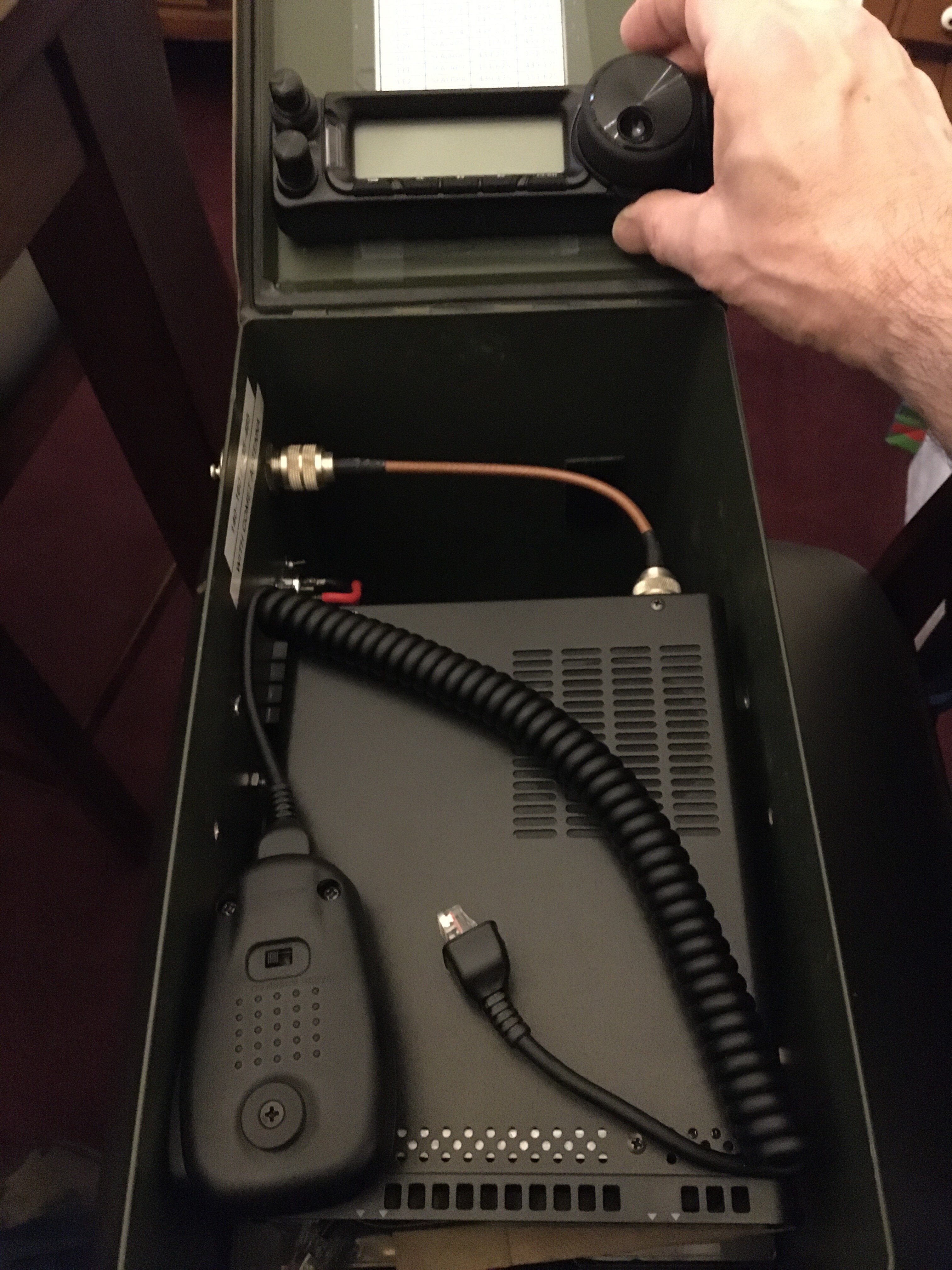

Setting up FAT50 can for field use. Has simple 2x 10ah SLA batteries (under the radio). External pack (not shown) has another 20ah, meter, and optional solar panel input with MC4 connections. Radio will be on slight tilt and ordered a short 3' head unit extension cable. And yes will be operated with lid open for heat dissipation and such.
You probably already know, but there's a fan speed in the menu. I set mine to contest, and it basically runs anytime the rig is on. Pretty cool setup there, CB590.

I did turn on the fan full time. Whisper quiet and it does seem to keep it cooler when in standby all day.
