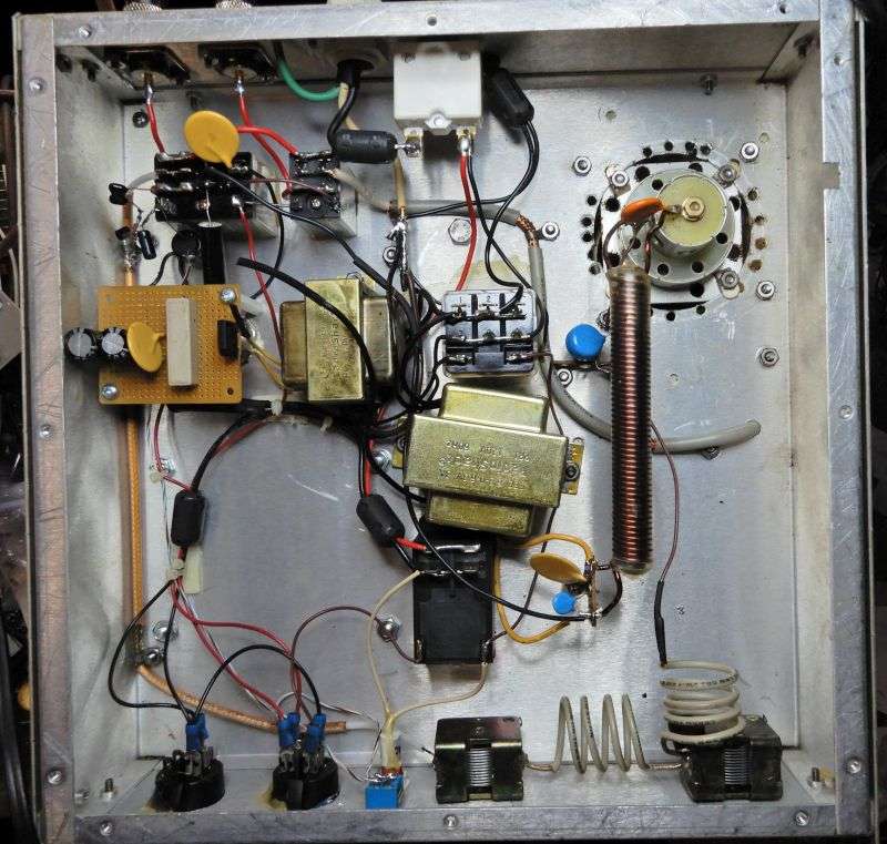

This amplifier had a persistent "AC hum" on the carrier it amplified. Turns out that using the filament transformer's center tap wire for the tube's DC circuit return modulates about 6 Volts AC onto the tube's grid circuit. Caused a 60 Hz modulation "hum" added to the radio's carrier.

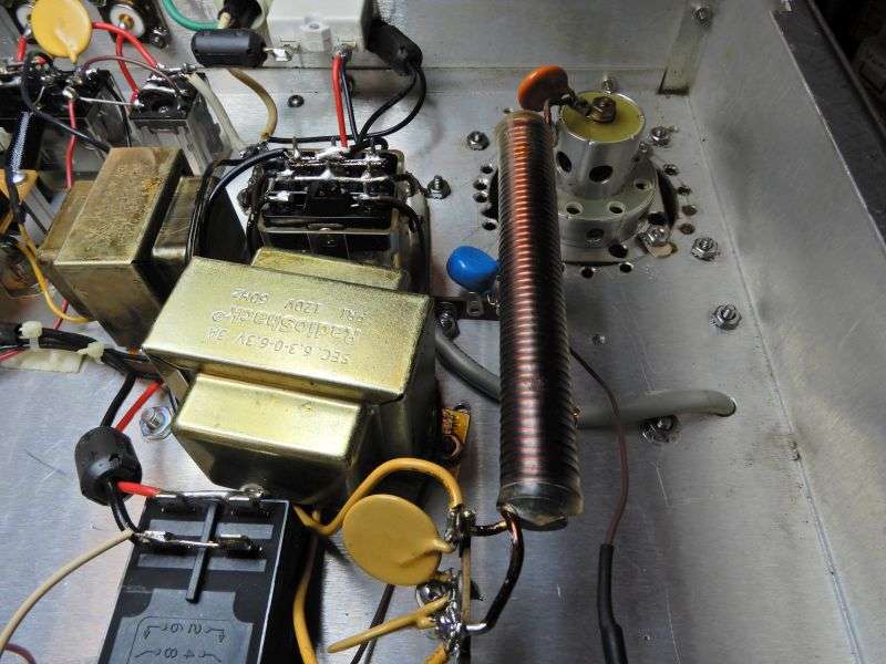

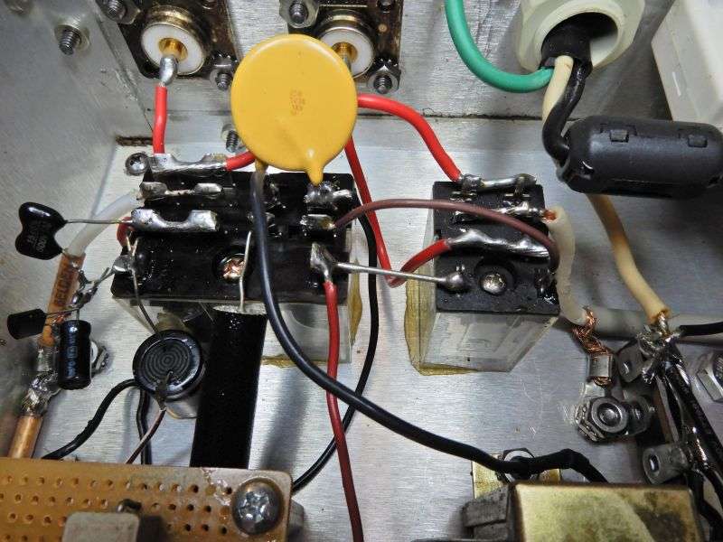

Here's the relay that activates the tube when you key, along with transferring the coax sockets to the input and output circuits. The single black wire leads back to the tube's cathode circuit.

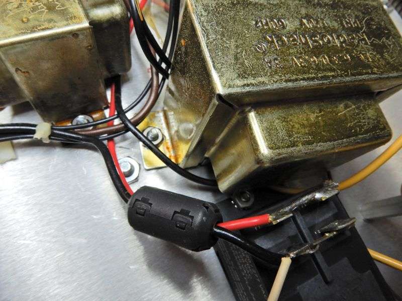

The black wire disappears under the filament transformer, but trust me. It's the center tap wire.

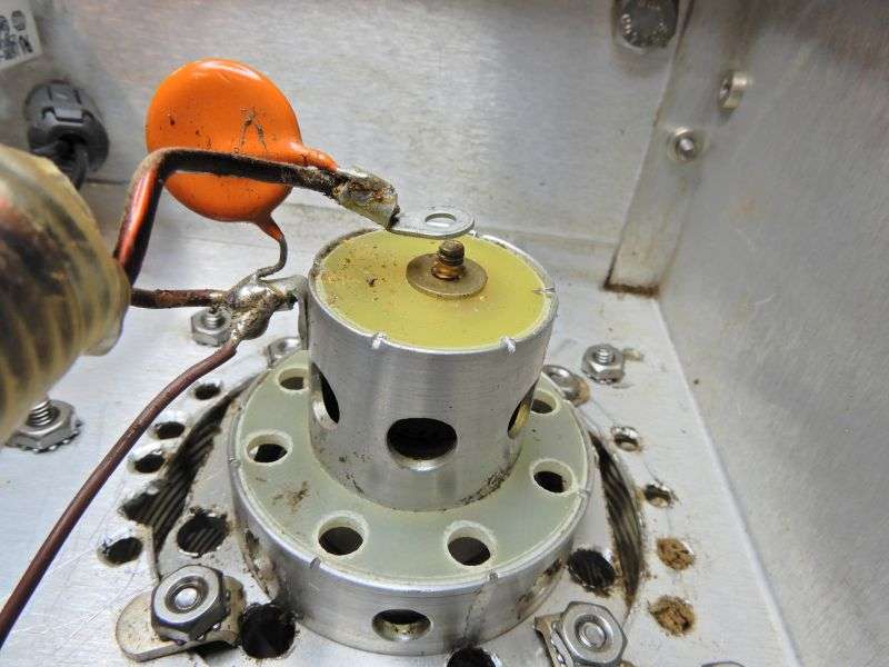

The cure is to move this black wire from the transformer to one side of the cathode choke. The side
connected to the tube's cathode and heater both.
Have to take one side of the choke loose to identify which of the two tie-strip lugs is the right one.

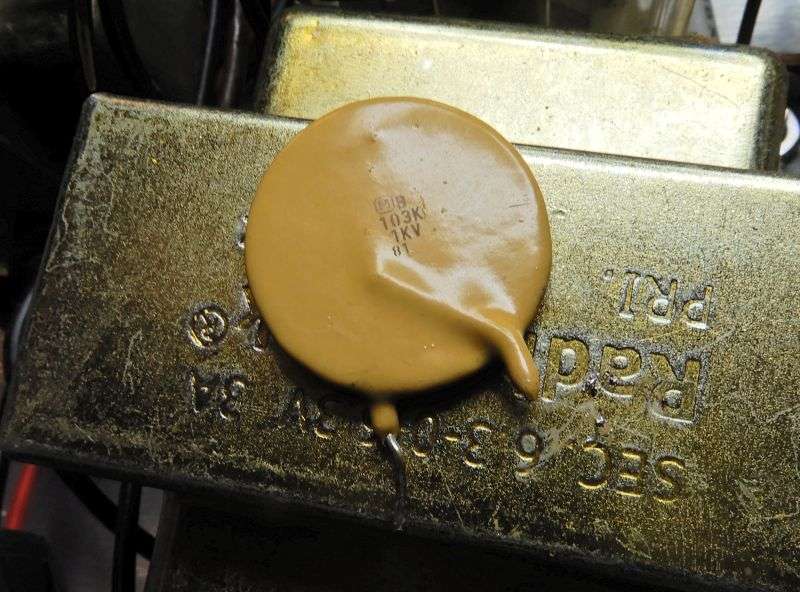

The black wire now goes to the correct side of the cathode choke. The fat yellow bypass cap got replaced by the smaller blue one when one lead wire broke off it. Stuff happens.
All in all this is not a badly-built amplifier. Anyone who has ever built a linear will probably have an opinion about how someone else does it.
But if you run into a persistent "AC hum modulation" coming from an amplifier with a russky ceramic triode, have a look to see if the builder fell into the center-tap trap.
