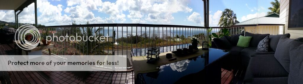

One antenna option will be to run a dipole from the deck to a neighbor's front deck across a vacant block, rough guess is that I have a bout 40m to play with.
I have a hill behind me, but i'm elevated looking N - N/W
View out;
