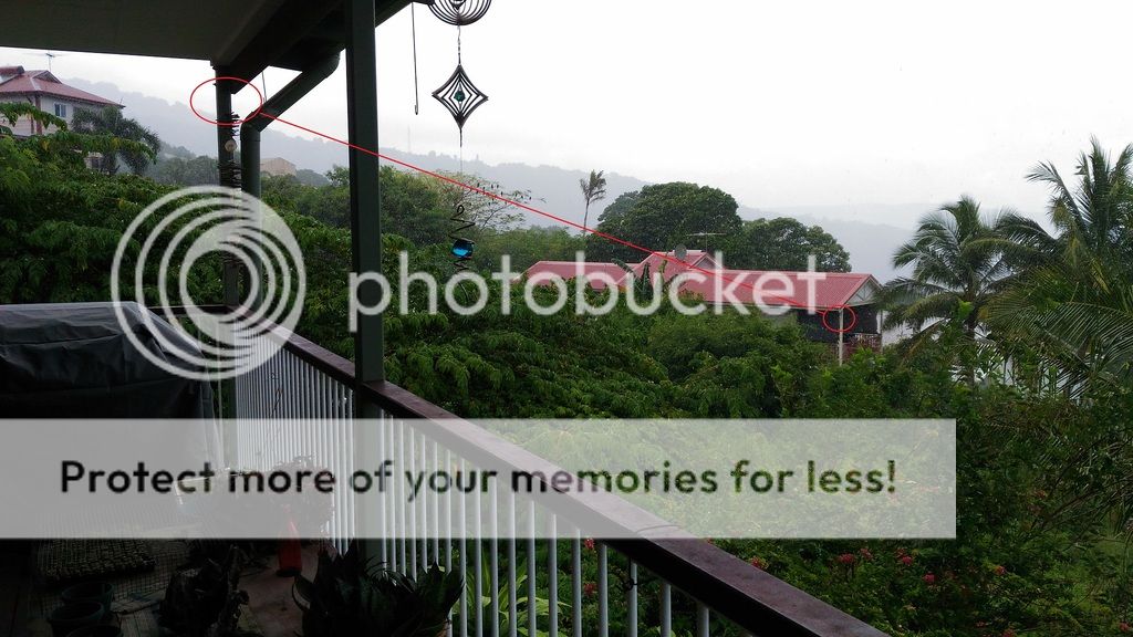

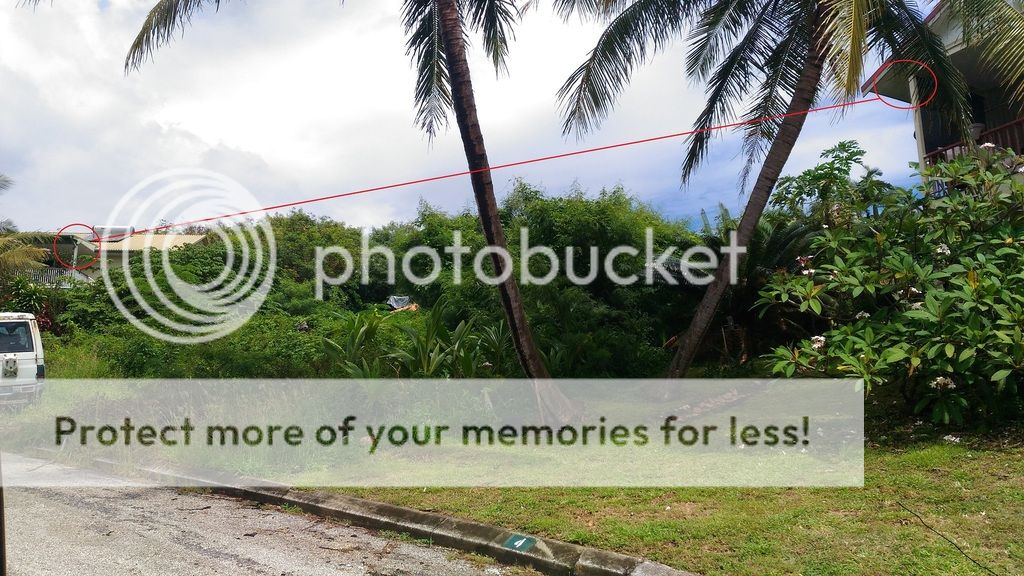

First antenna will be a G5RV mounted here.
Its going to be my get on the air antenna for now.
Will be 8 weeks for the next ship for any materials for verticals.
I think my Coax missed the ship that will be here in a week.
Not very high off of the ground? Perhaps roof peak to roof peak? A G5RV is really a 20m antenna; so a 1/4 wave length above ground will be 5m. Which would be the minimum. Higher would be much better. 10m off the ground would be decent.
