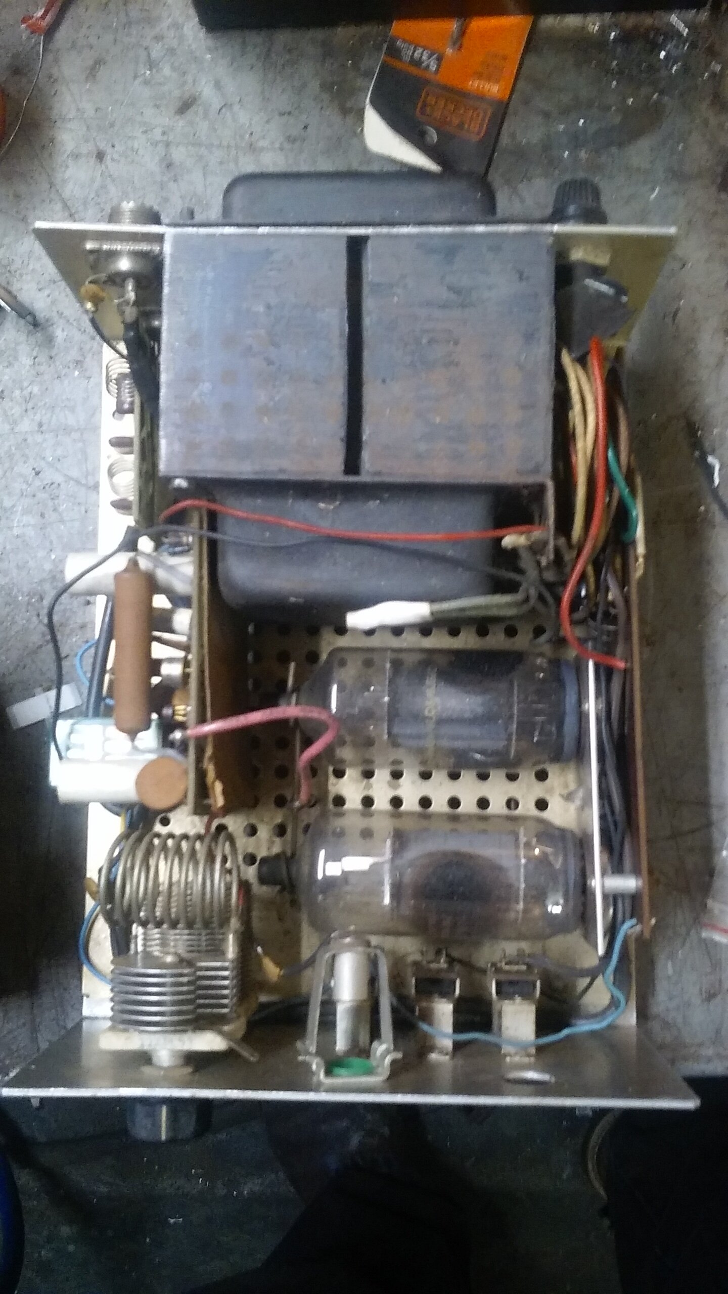

Since the tubes are wired as grounded grid triodes, is there any reason we are not biasing them as such, through the cathode? It seems like lifting RFC 1 from ground and inserting a zener or a string of silicone diodes bypassed with a cap, would be the way to go here. You can precisely dial in the bias current, without worrying about other available supply voltages. Add a DC blocking cap to prevent that bias from going back into the radio.
