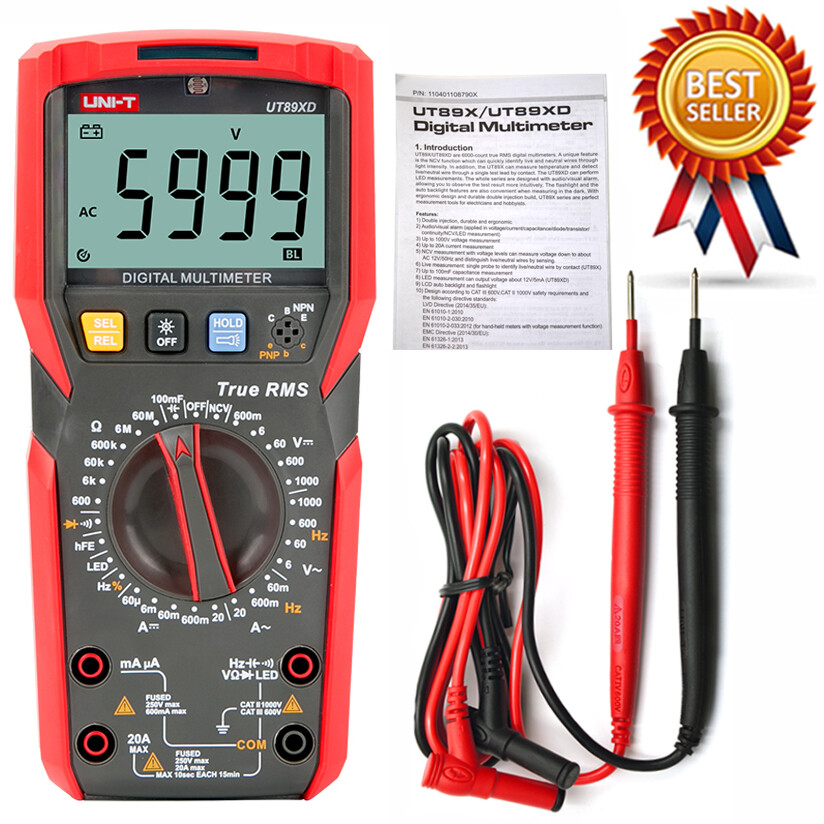

I need new multimeter, what do you guys think of the new unit "UNI-T UT89XD Digital Multimeter" or what do you guys recommend for me, preferably under $100?
That's a perfectly good meter if you're nice to it.
Biggest difference between the over a hundred-buck "pro" meter and the cheaper brands is robustness. Both the mechanical toughness and the electrical overload protection. Dave Jones posted a few YT vids on his EEVblog channel comparing high and low cost meters.
So long as you don't zorch it feeding 240 Volts AC into it when set to read "60 uAmps" or drop it too far the lower-price meters are better than the wocka-wocka meters of a generation or so ago. The electrical accuracy depends on parts (chips) that have gotten really cheap. What costs big money is a meter that still works after it gets dropped a few times.
That meter should serve you just fine.
So long as you're nice to it.
