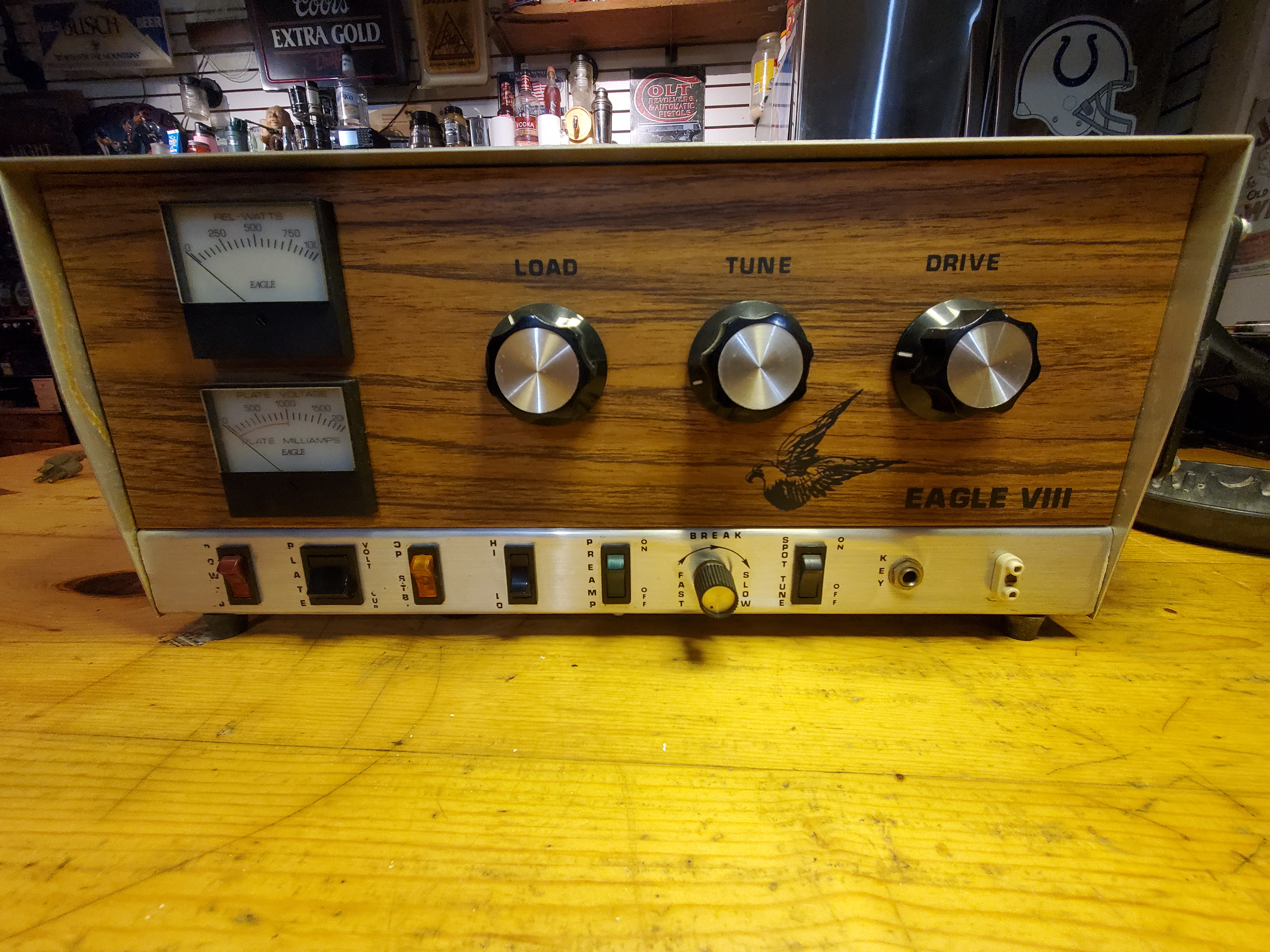

Loosecannon, I have one too View attachment 70683
Holy Crap Danzik!
that's the first time ive seen another Eagle VIII in over 20 years!
Its the only other example ive ever seen really.
For the benefit of the forum, and future searchers, can you take some internal pics?
Close ups of the PC boards tops and bottoms would be beneficial for me, because mine has a couple of burnt traces from a mistake i made a long time ago.
very cool.
thank you for posting this.

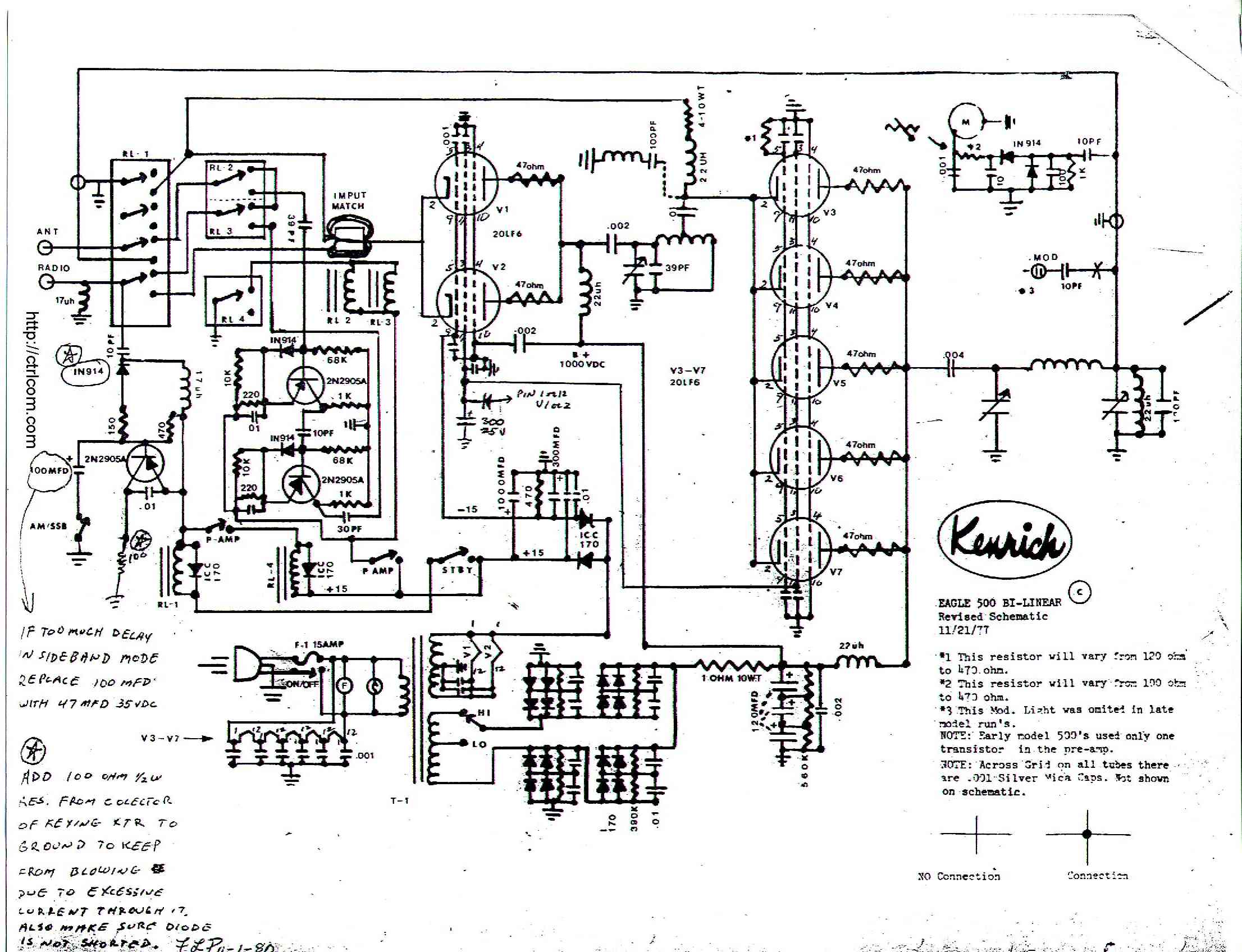

Do you still a the schematics for the eagle 500

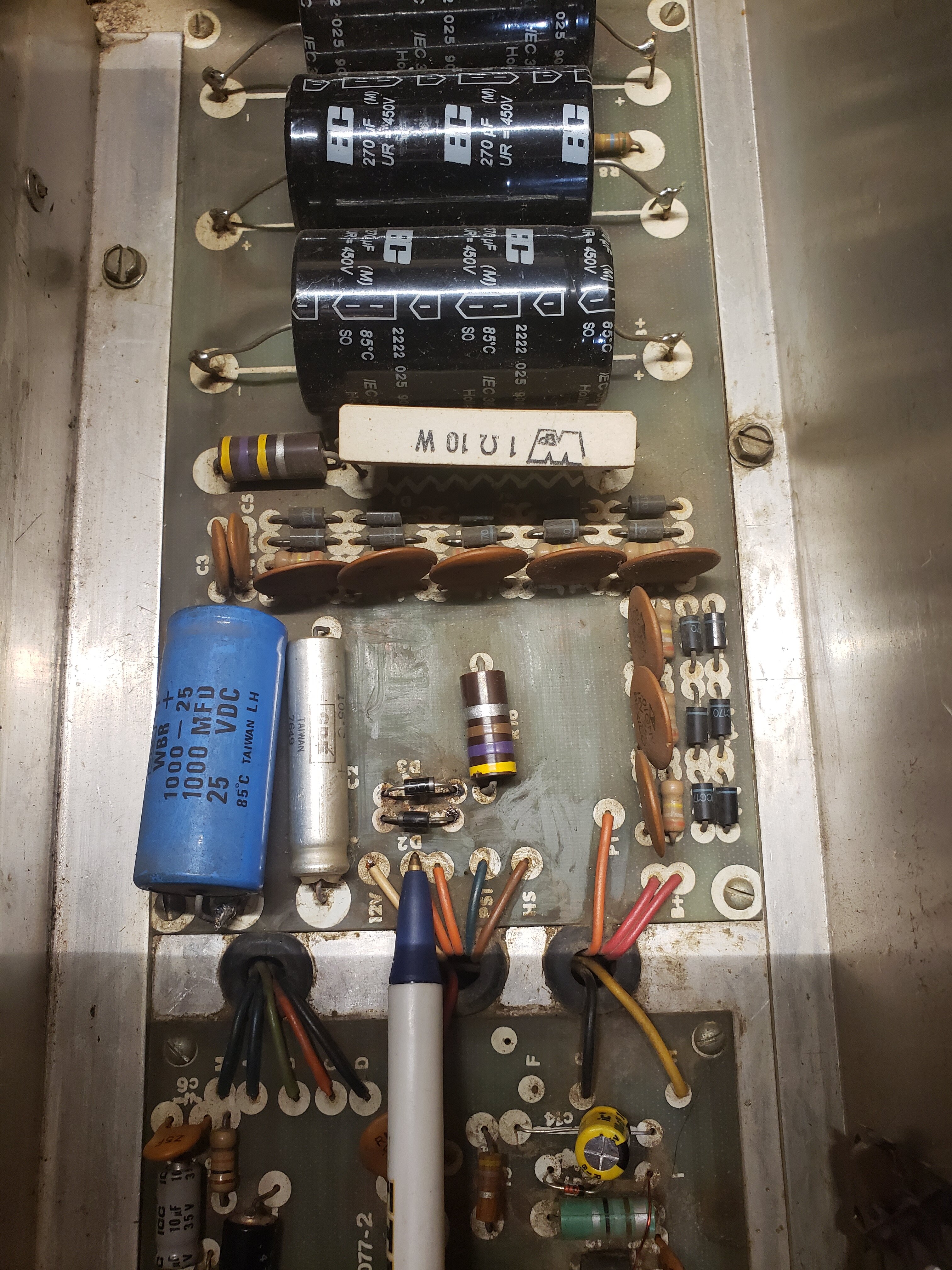

I have a 1978 Eagle 500. On the power board there are 2 dides psition d2 and d3 .They look different but the schematic says they are both icc 170.Is this the correct numbers for those positions?Thank you for your help

The "170" number was used by more than one supplier, each with a different letter prefix. The Motorola "HEP" or Workman "WEP", or "R170". Or International Components Corporation "ICC170". It's a 2.5-Amp rated 1000-Volt rectifier. They're not so common now. We use the generic 1N5408 3-Amp 1000-Volt rectifier anywhere the older 2.5-Amp part is specified. That one is cheap and widely avaiable in quantity. Good chance you'll find the older 2.5-Amp part on fleabay.
There are no callouts on the schemo, so I don't know where D1 and D2 are on the diagram. Maybe they look different because they were replaced some time in the last 45 years.

I am very pleased this post is still available.I have had my Eagle 500 for almost a year.I run it every day.Had a problem with the keying transister,so far that is fixed.Going to do the resister mid on that.Then my driver tubes were cherrying.That is when i came across the diode.Just trying to figure out the correct one to make a good fix.Thank all of you guys for your input.
Pretty sure D2 and D3 rectify the plus and minus 15-Volt rails. Don't see which one is for the postive side and which is negative. Looks like they were replaced with type 1N4007. Should be perfectly okay for that circuit. Current drain won't strain the 4007's 1-Amp rating.
