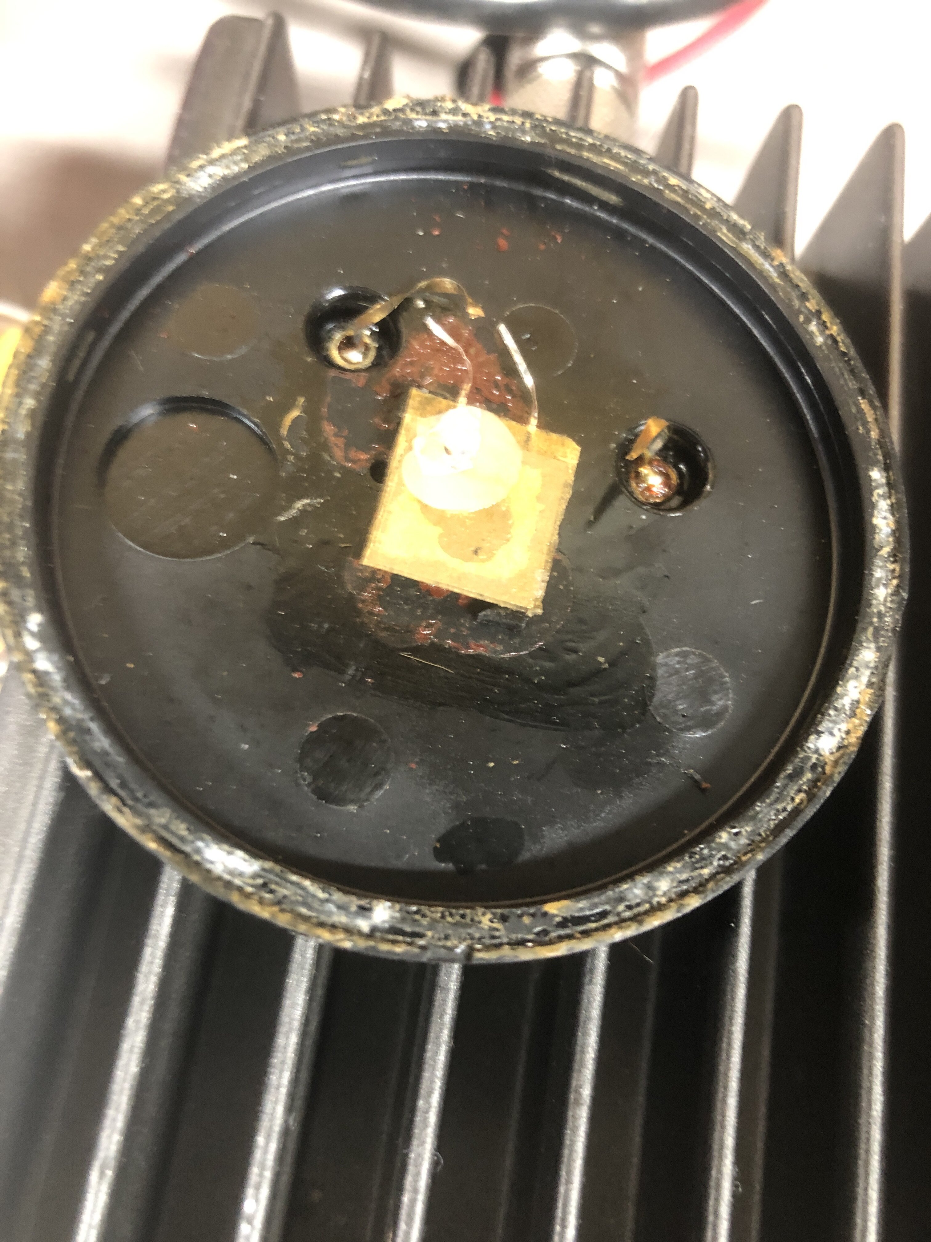

What is a Japanese crystal packet?
The insides of an LM101 crystal mic that can still be found some places new. Take the packet out and transplant it into an MC-320.
