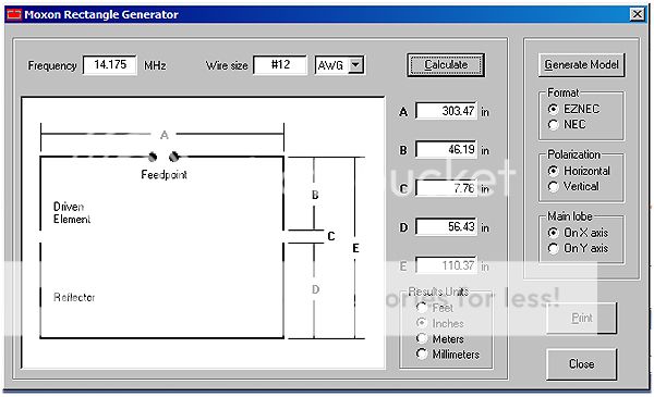

Made a Moxon
The program seems to calculate the wire lengths too long for the resonant frequency, so be sure to make it in such a way as you can shorten or lengthen each wire as needed to fine tune it.
