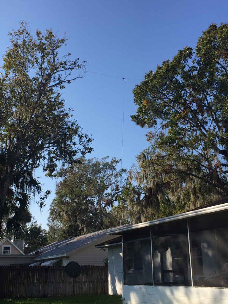

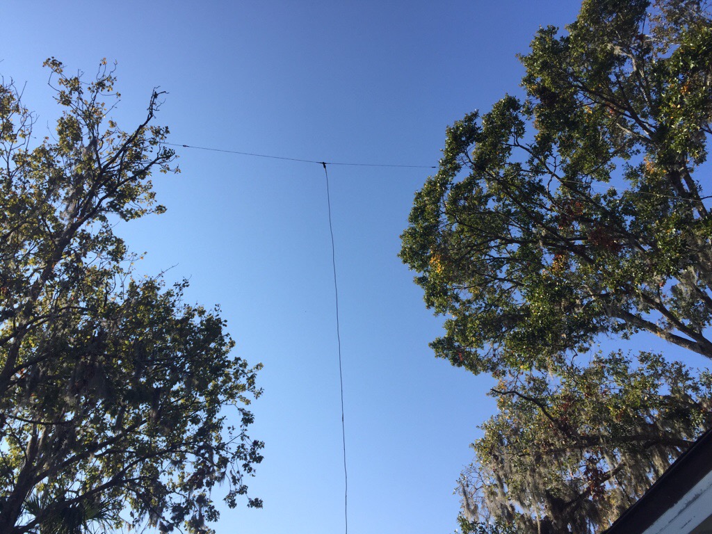

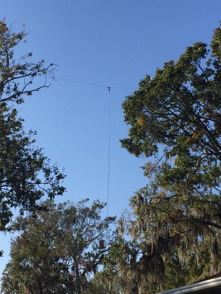

As long as it has a 1:1 balun, you should be fine. Like Fourstringburn stated, let the coax hang asfar down as possible. At least the first 9ft or more. Don't know how you are going to hang it as in, horizontal or inverted V. I have the best luck with horizontal ones. Less noise, and if you hang them high they really work well for what they are. Think you said you were getting a long wire correct? Or did you get one for 11 meters. I've used my 11m one for listening to many of the other bands. Even though it's tuned for 27.400, it actually works well on many of the other bands and frequencies for listening. Anyhow. Here is a couple of pics of mine that I just hung up this past weekend. It's at about 40ft or a little more. Used an 11m Dr. Dipole 1:1 balun, the Unadilla, and I cut the legs for 27.400. It tuned out very well on the MFJ meter. Used a 60ft piece of coax as it's what I had laying around, LMR240. And it was enough to hang it that high and have plenty to basically drop into my radio room. Coax goes almost to the ground. About 3ft off it to keep from hitting it with the mower. Anyhow. Have fun with the new dipole, and read the manual on it and see how they say to hang it for what you want out of it. Enjoy. Here are the pics of mine.
73 and God Bless.
