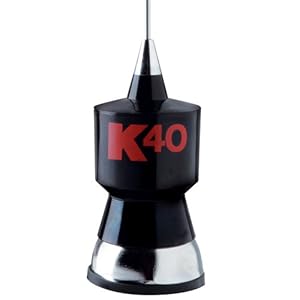

Yes sir, had my k40 on a 2ft x 2ft 1/4" steel plate, I also put 2 ground rods in and grounded the plate. The k40 did okay. It's not a real spectacular mobile antenna IMO. Had one and it worked okay, but no where near the performance of my sirio 5000. I would do like others have suggested and get a real base antenna or a dipole. You can get a dipole off eBay for pretty cheap these days. Have a look around. I think you can get them shipped for under 20 dollars and it will definitely work Better than the k40 IMO.

its been 20 plus yrs since ive owned a k40 . but for some reason i was thinking this antenna
reccommended a certain lenth of coax.which really makes no sense . so i could be wrong
on this.i really dont undestand how adding coax lenth increased his swr.especially by
that much.sorry im a little lost on this one
In simple terms...
The antenna is actually part of a system. Current flowing into an antenna needs to return to the source. An end fed antenna like a CB mobile vertical is effectly only half an antenna so you need to make up the missing half to allow the current to return to the source which is usually the body of the car.
When you have a piss poor ground the antenna system uses anything it can to make up the missing half and this is usually the coax. So effectively what you have is a dipole with one half of the dipole being the CB whip, the other half being the coax. When you alter the length of the coax from being a quarter wavelength or multiple thereof, it alters the tuning and alters the SWR.
Now if it was a properly installed antenna with a good ground plane then you can use any length you want and it shouldn't make any difference.

Yep properly grounded I showed a better VSWR reading with the k40 mounted to a 2ft x 2ft x 1/4" plate with a #10awg solid ground, I also used a barrel connector and 50ft of lmr240. My swr reading did not change with the added coax. Good ground and a good ground plane will do wonders. It wasn't anything spectacular and I had better luck with a homemade dipole!! You can purchase a very good dipole for less than the cost of a k40. They are very easy to make as well. A good dipole setup to around 30ft got me around the world with a stock uniden pc122xl. But the k40 will work for local talk just fine, just don't expect any miracles with it.
