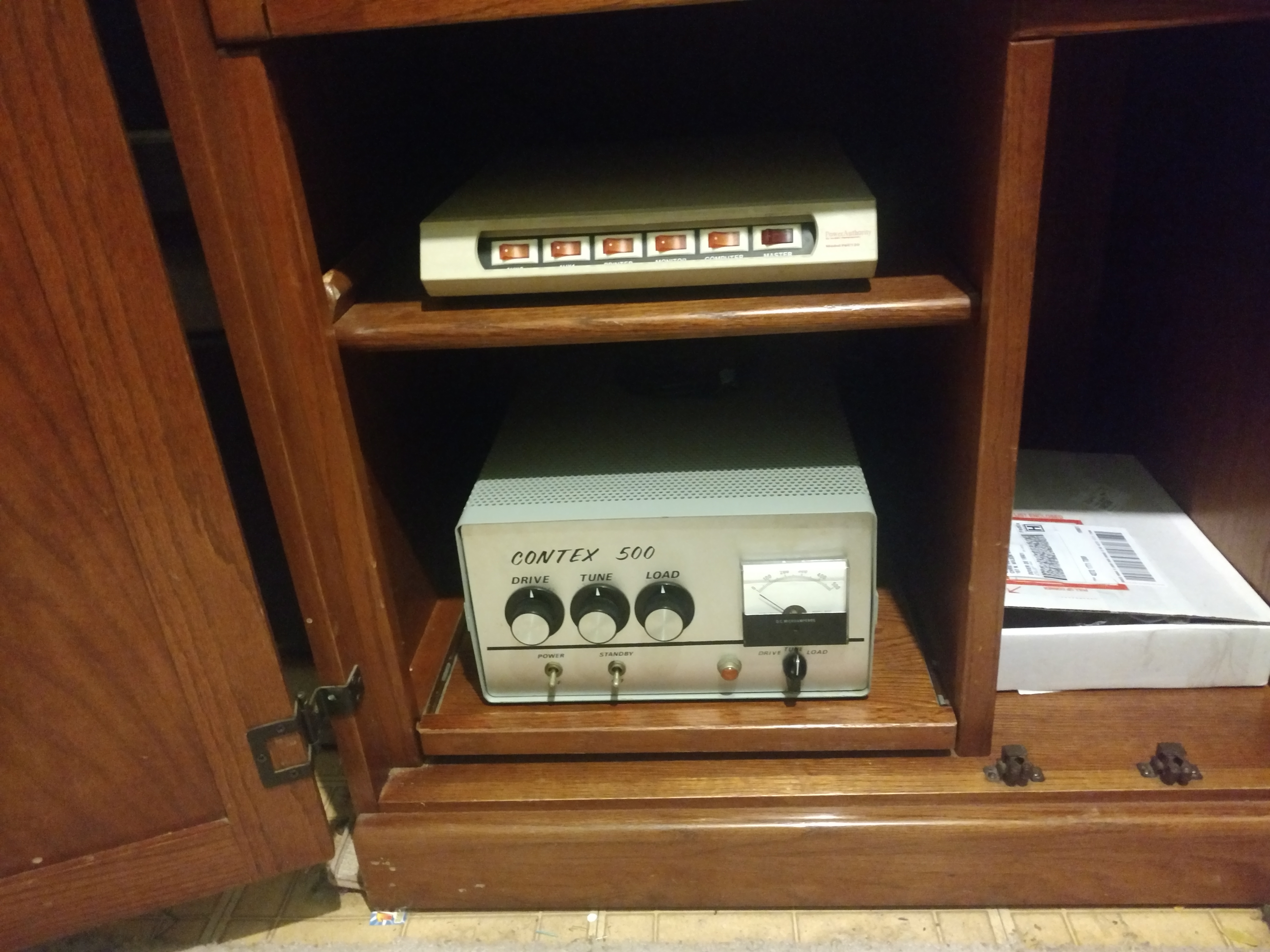

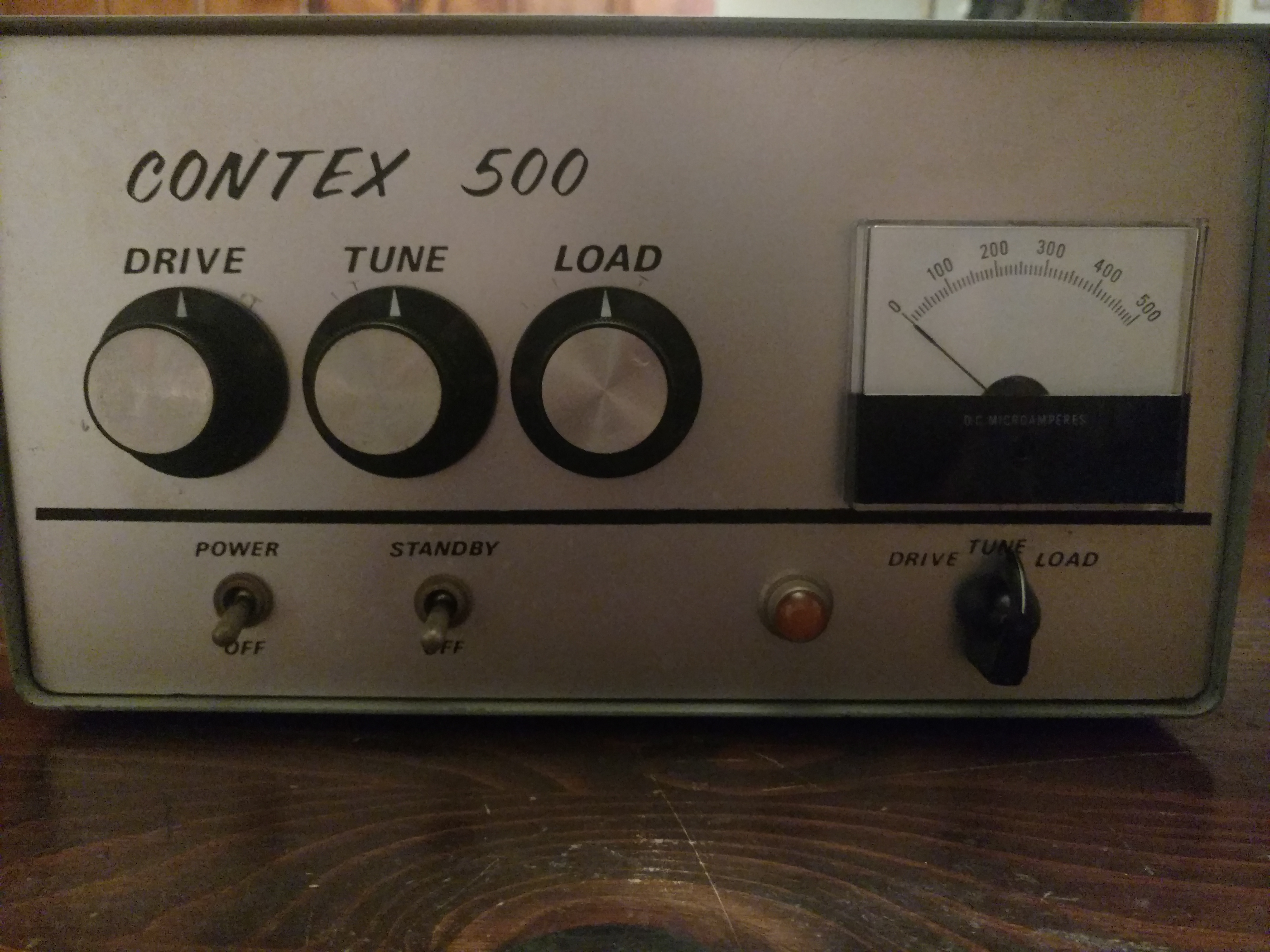

Just a quick update. Working on getting the Context 500 CB amp set up and running. I solved the mic squeal problem but now I am working on the SWR between the radio and the amp. It looks like I will need to modify the amp input as the tuning cap has no more adjustment.
Stop by and check it out:
https://www.worldwidedx.com/threads/contex-500-tube-amp.226894/

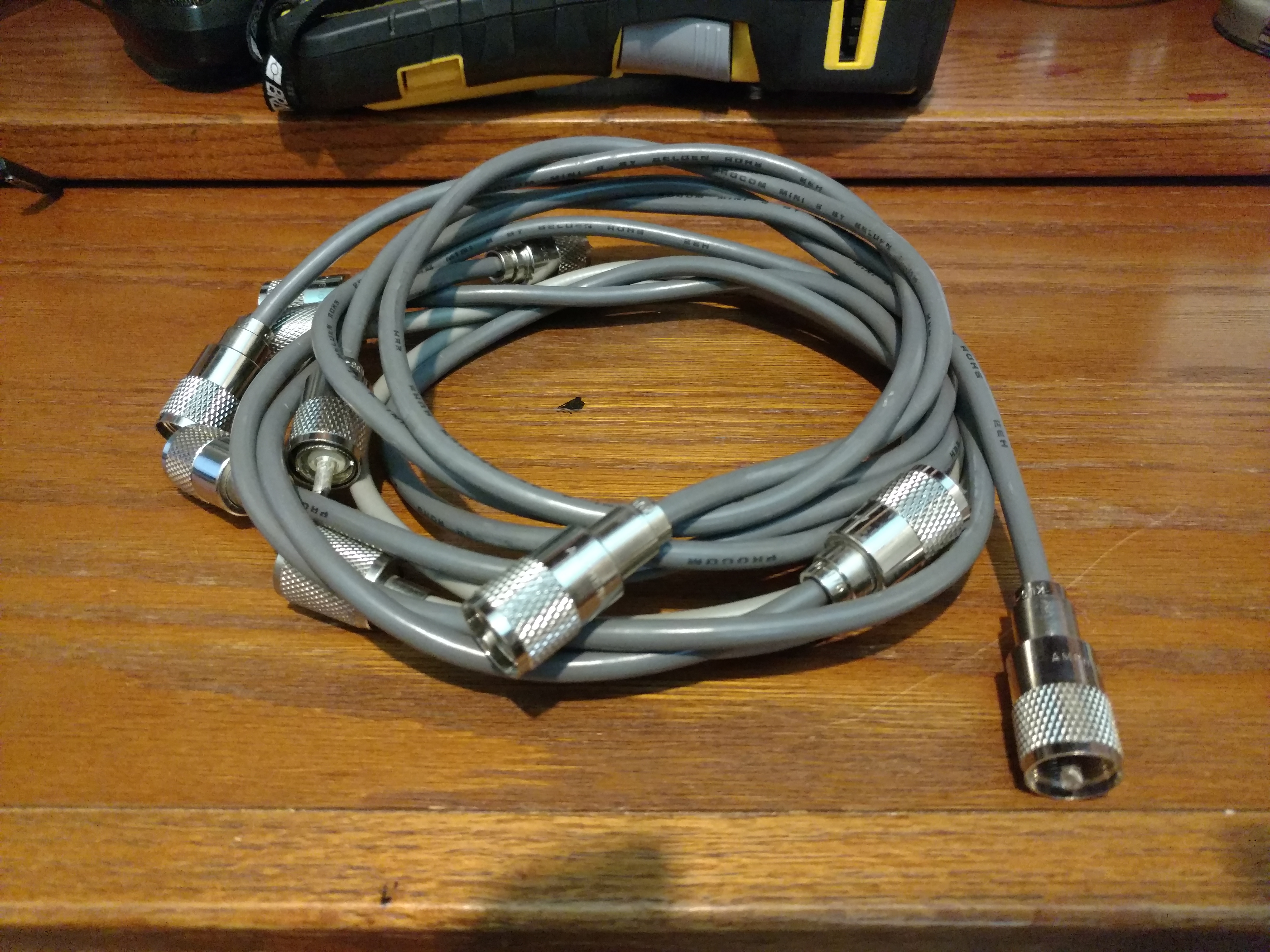

I put the shack together with a pile of Mini 8 jumpers that were 3 feet long. With barrel connectors it was great in a pinch. But my SWR was doing funny stuff like it would be 1.2 on dead key and shoot up to 2 with modulation. Probably a poor connection but which one? The more connections you have, the better the chance of having a bad connection. I don't think the Mini 8 is rated for much power anyway. This stuff had to go.
I got some 10ft jumpers from jefatech.com
https://www.jefatech.com/collections/jefa-tech-coax-cable-assemblies
I was going to use 240 flex but the 400 flex was a few dollars more so I said what the heck. I figure it would go good with the regular 400 going to the antenna. So I got two for each amp, and then two with a so-239 on one end. One of them to wind a choke at the antenna and the other as a leader into the shack. Now my SWR stays lower and doesn't jump as much on modulation. Now it is 1.2 on dead key and 1.4 modulating.

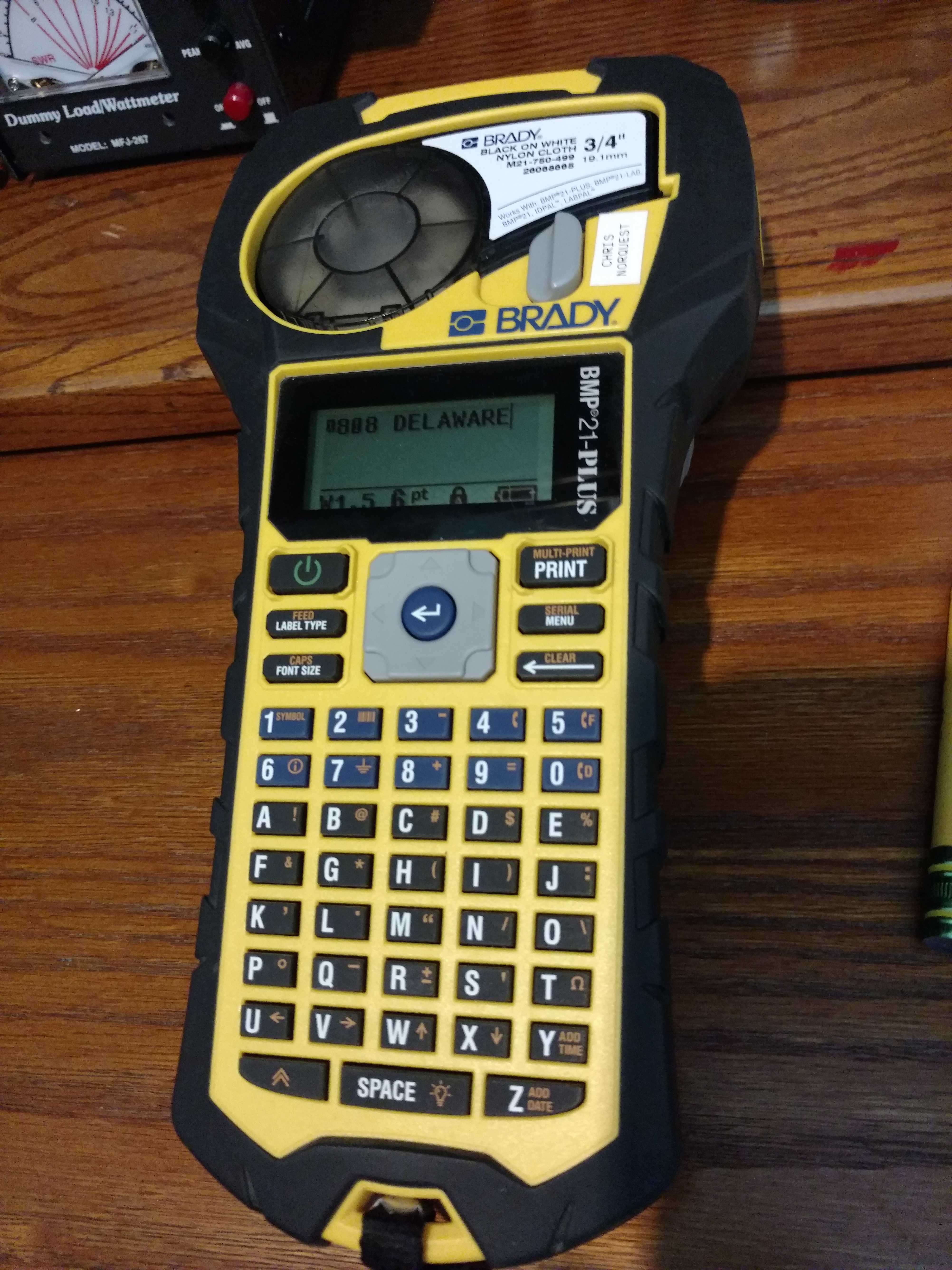

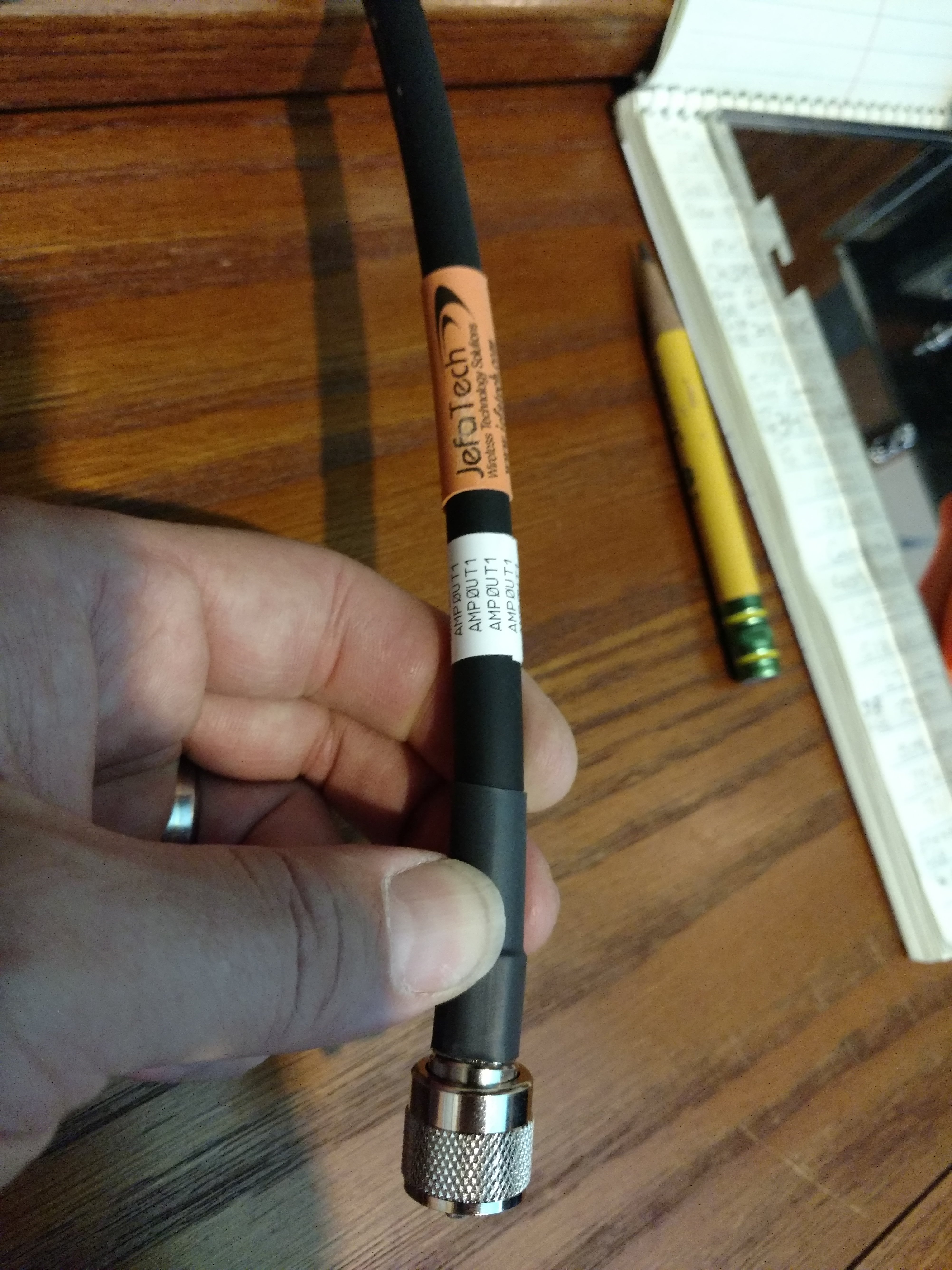

I marked all the jumpers on each end before I ran them. Nothing worse than having to trace everything out every time you do something. This Brady BMP 21 wire marker makes labels designed to wrap around the wire. I bought it to use at work on a project so I already had it. Masking tape and a Sharpie Marker will work too.

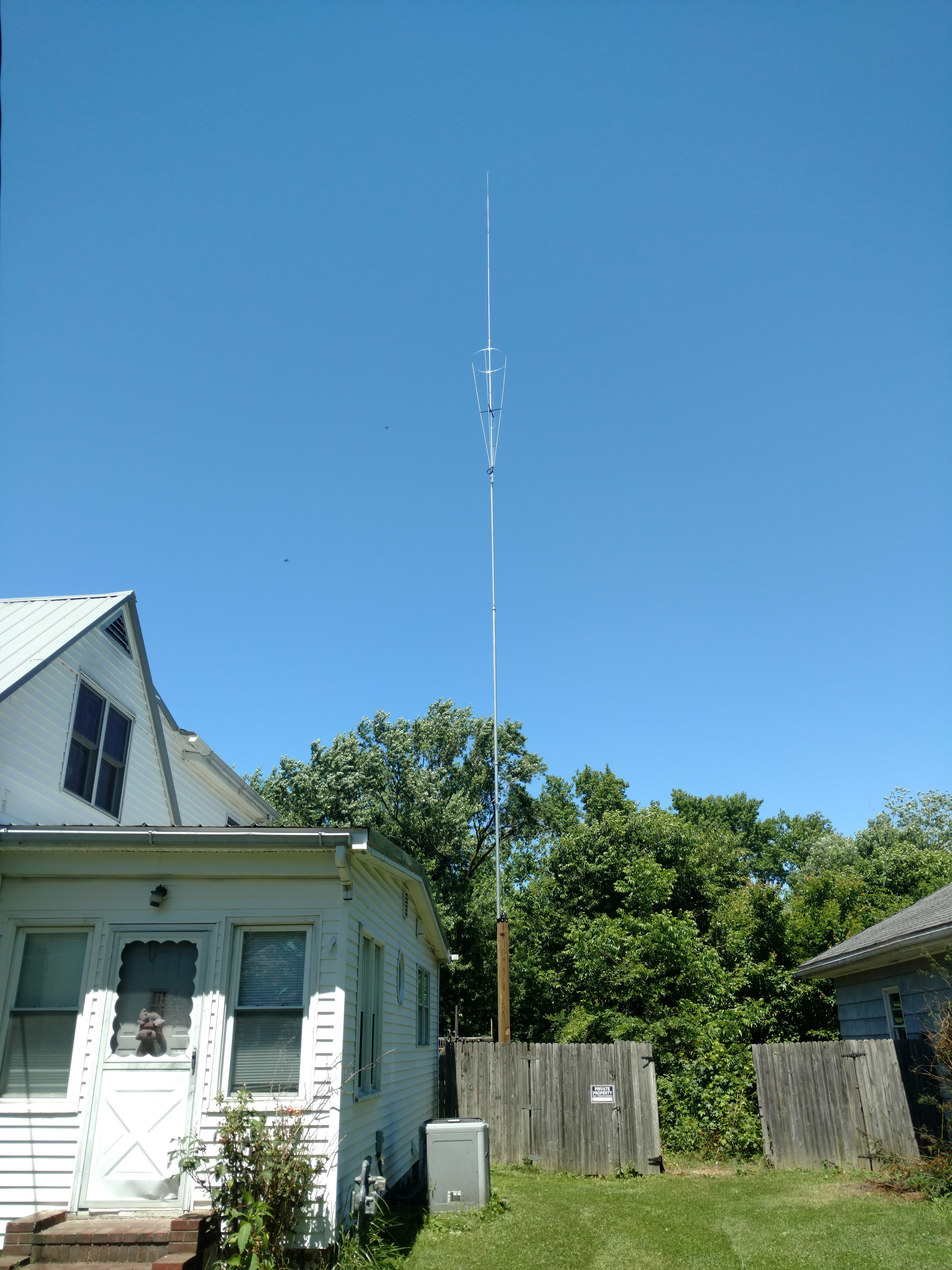

This is the view from the front yard. The Vector is standing proudly. This side room with the front door is where my shack is. It is only a 10' by 10' room and it has a front door. I am not sure if it was a business office that someone had at one time or something.
Wherever this house is, it seems to be a quiet place. The antenna looks great anyway and there is also the opportunity to make the garden pretty. (y)
I am slowly catching up on the yard work, for the past 4 years I have been living in Montreal part time. Now that the project is done, I have several truck loads of unsplit firewood that has been sitting for over 4 years. Needless to say, it is all rotten and we are slowly burning it in a small pile in the back yard. Hopefully by this fall it will be all cleaned up and in the spring we will be able to plow it and grow some vegetables again. Thanks for the kind words and thanks for looking.

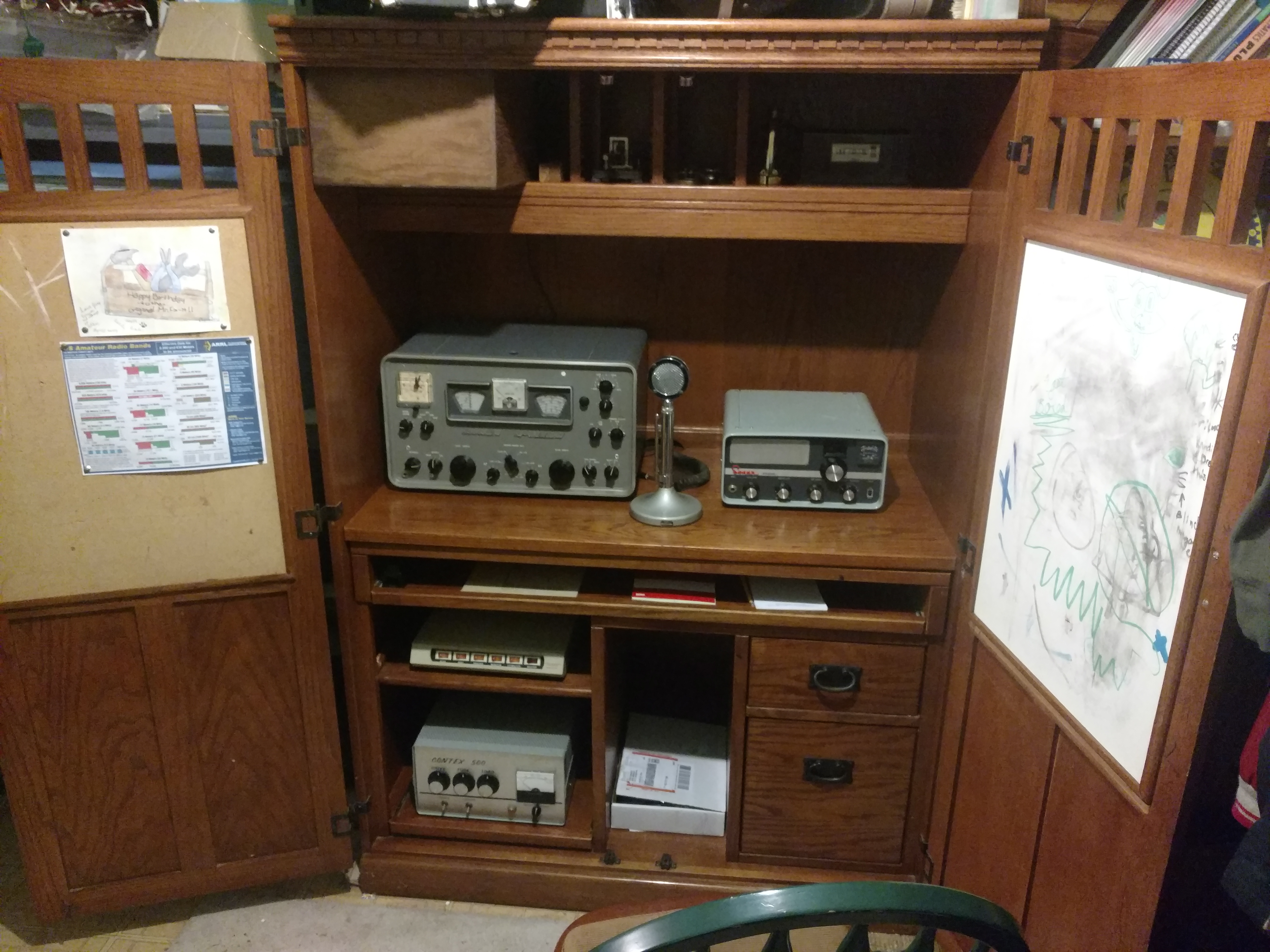

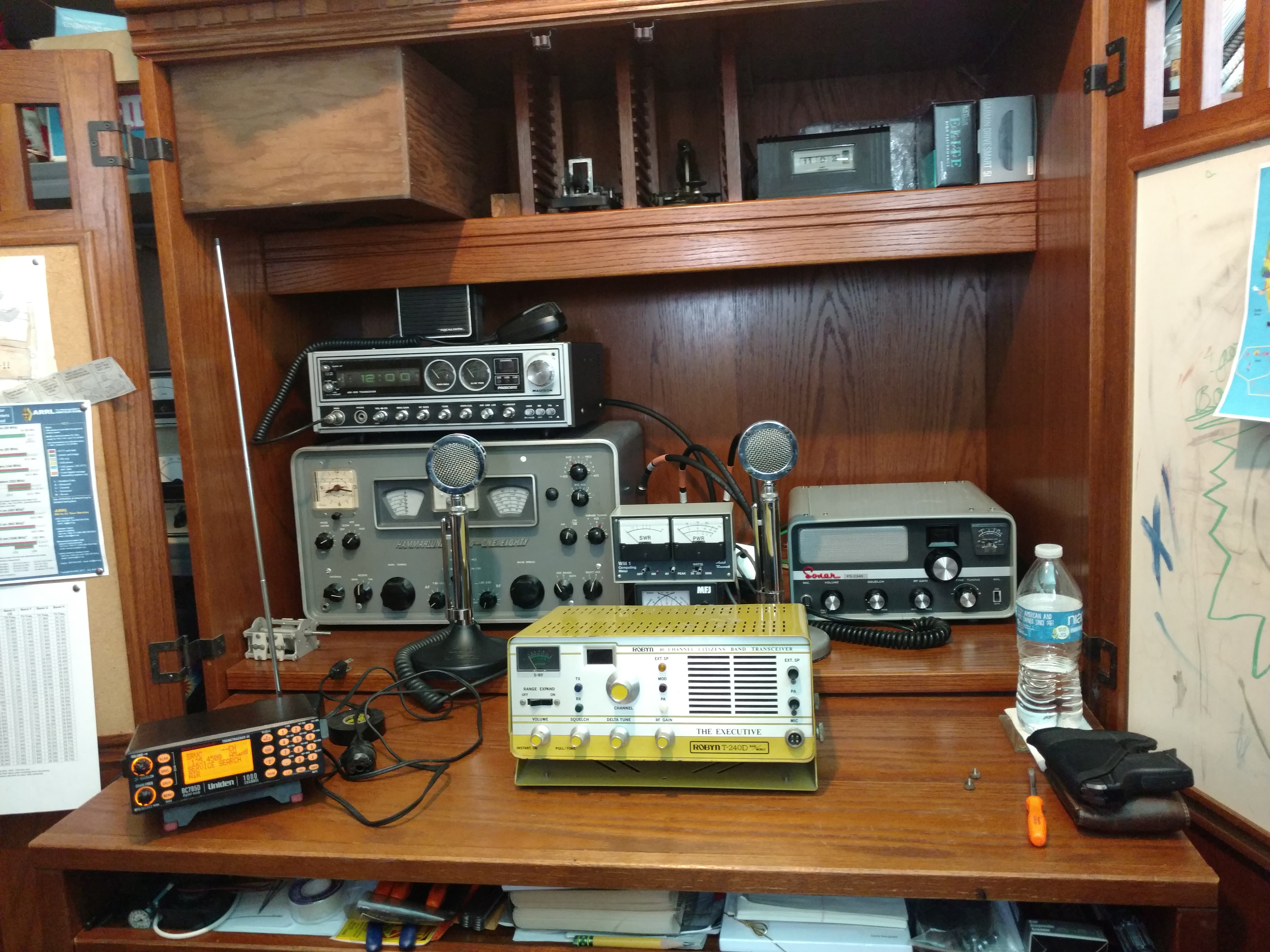

I recently picked up a Robyn 240-D from eBay. It came with a D104 and seems to work ok. I might send it out to be aligned but first I really need to make a shelf. I really don't want to stack the units on top of each other. Also in this photo is the President Madison with upper channels and the Bearcat BC785D Trunk Tracker III.
Here is the thread on the Robyn:
https://www.worldwidedx.com/threads/robyn-t-240d-executive.233524/

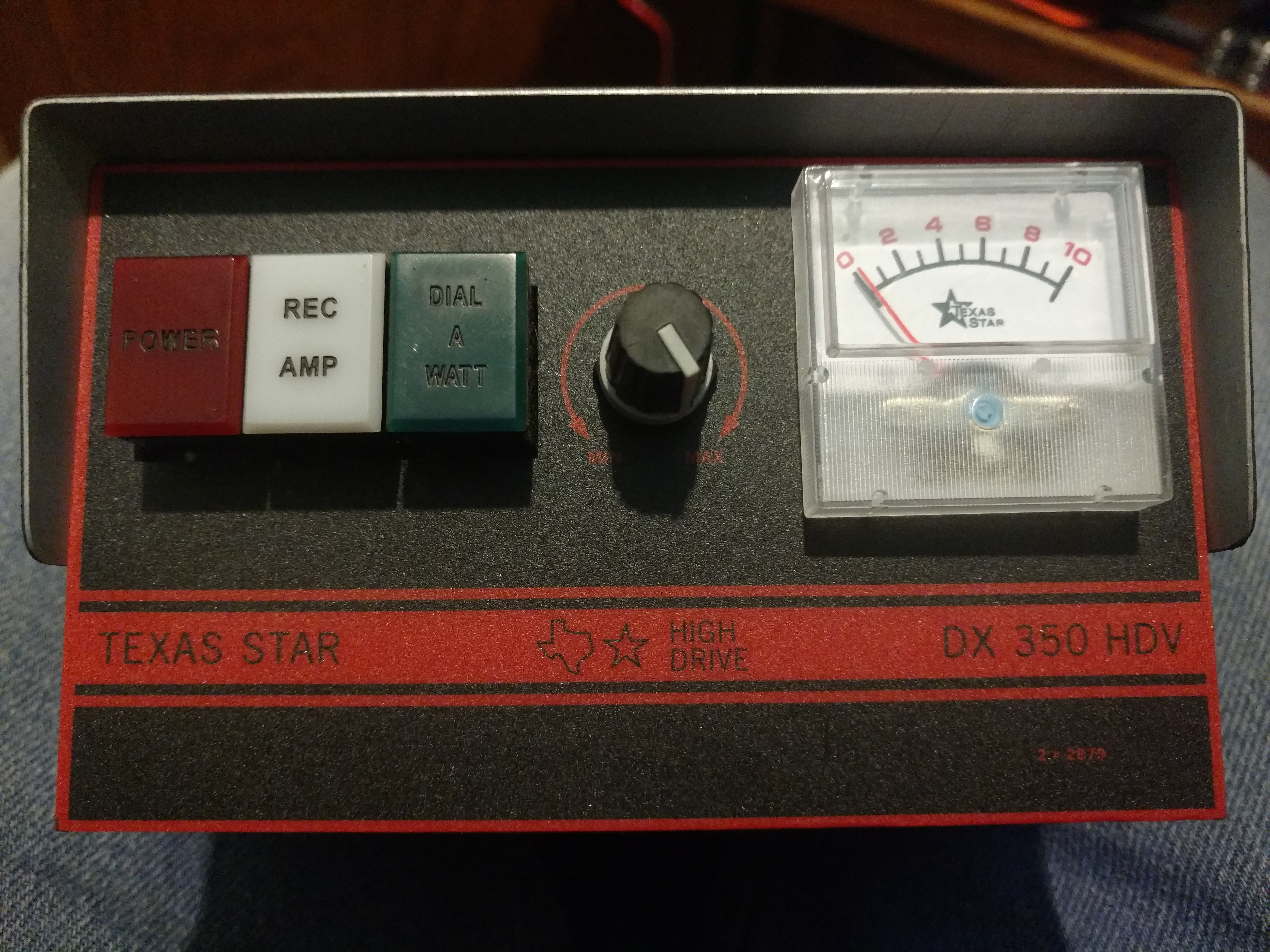

Just got an amp for the CB.
Fits real nice on the amp rack. I might move it up to the desk so I can see it. Still need to get the antenna up.

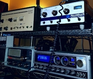

Or one could do what I did. Instead of buying a building I purchased a rolling utility 6 tear shelf setup.
I could roll it anywhere in the house. And even outside. This portable shack has been everywhere from the garage to backyard depending on the weather. And I'd venture to say @ $89 it was a lot cheaper than a building. Lol! 73
PS. With all 6 selves attached it would've been impossible to fit any equipment anywhere, but the top shelf. So I left 3 shelves off, and spaced them so that any piece of equipment I own would fit on any one of the shelves. 1/8 inch Balsa type wood, and non-slip rubber matting purchased at Home Depot completed my portable Shack, The rolling shelf was purchased on eBay for $89. It turned out to be an excellent idea, and purchase.
