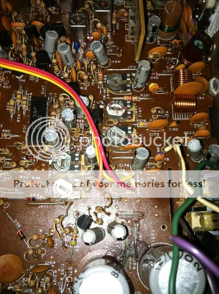

My old friend President Jackson.
What does the one in the video look like to you?
Worked on many a 3600 board - and that is not a 3600 board in that video.

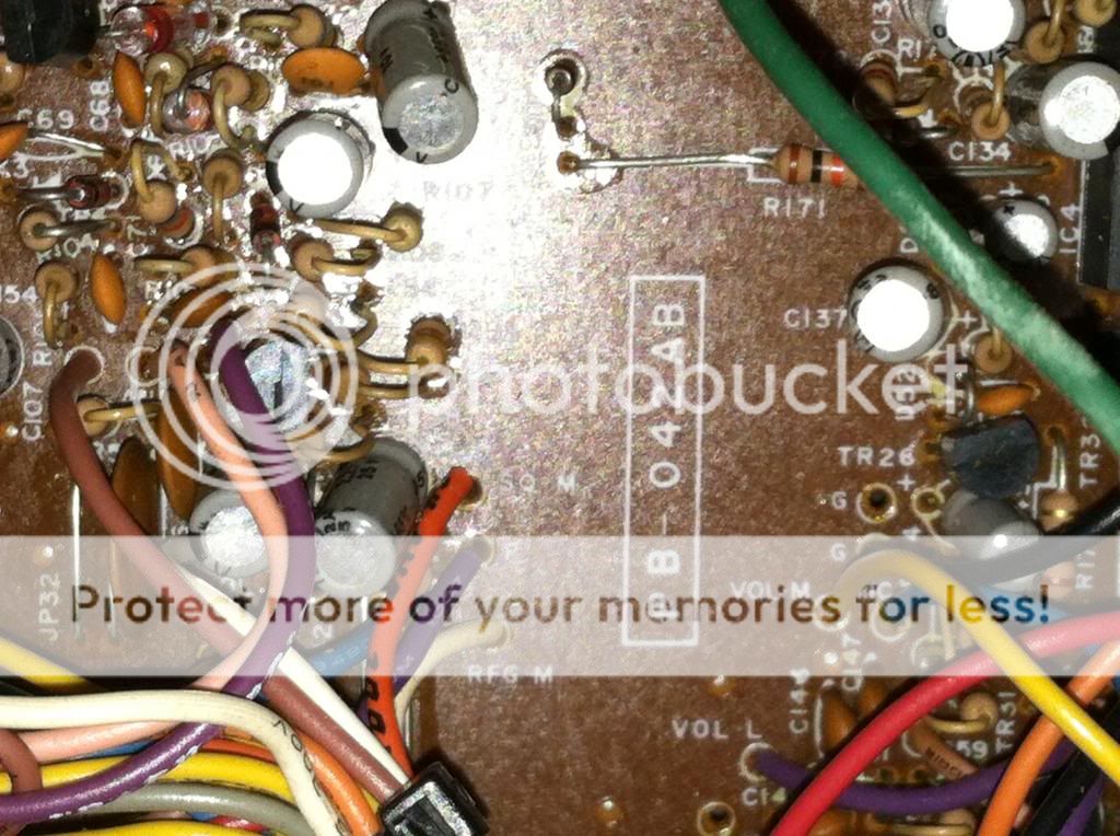

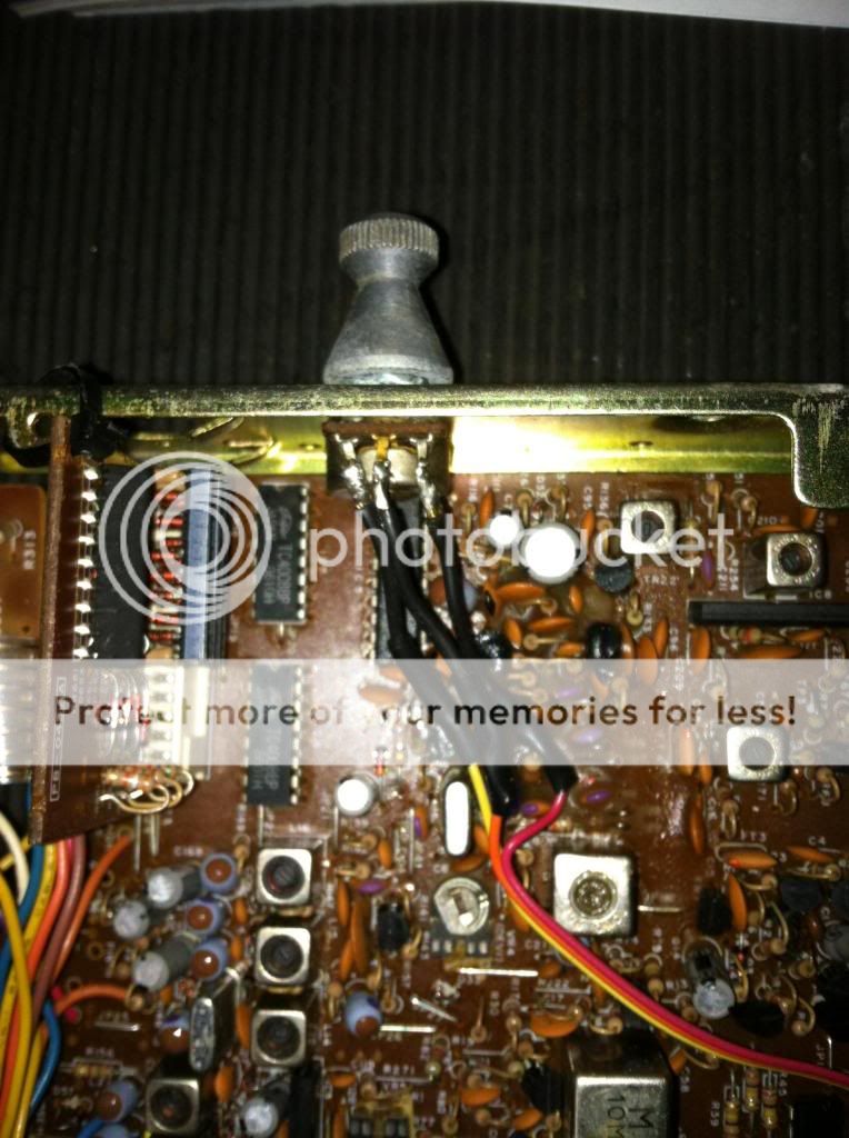

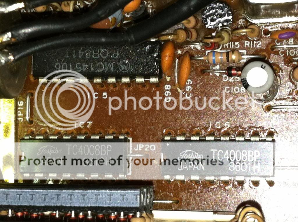

The Jacko does have the Motorola MC145106 PLL and two 4-bit counter chips as do many of the 3600 boards. But that is where the similarity begins and ends to a 3600 board IIRC. I'm pretty curious to open it up and examine the board as soon as it arrives. I don't have a Jacko to compare it to; but CB Tricks has a Service Manual and Schematic for the original to compare.
http://www.cbtricks.com/radios/president/jackson/graphics/president_jackson_sm.pdf
http://www.cbtricks.com/radios/president/jackson/graphics/president_jackson_pb-042_sch.pdf
Does it have similarities to the Galaxy 88HL?

These are image taken recently of the original President Jackson. The board in the video is almost exactly the same.

So, is it to soon to say that this radio has an embellished description about it being a resurrected Jackson?
DTB's description kinda gives a man that impression. Says: Jackson circuit board all the way.
Is it, or is it? Sounds like a mutt board to me.
Well, Wayne described it as the original circuit board too; with the exception of dual MOSFET finals instead of the MRF477 bipolar transistor.
Then it should convert just like the original then, shouldn't it?
thats what i was thinking, so i was looking at the procedure for the original then others have said its not the same,, very confusing. looks like the radio may have been brought back to life a couple times. ill have this one opened up monday evening and see what it really is.
