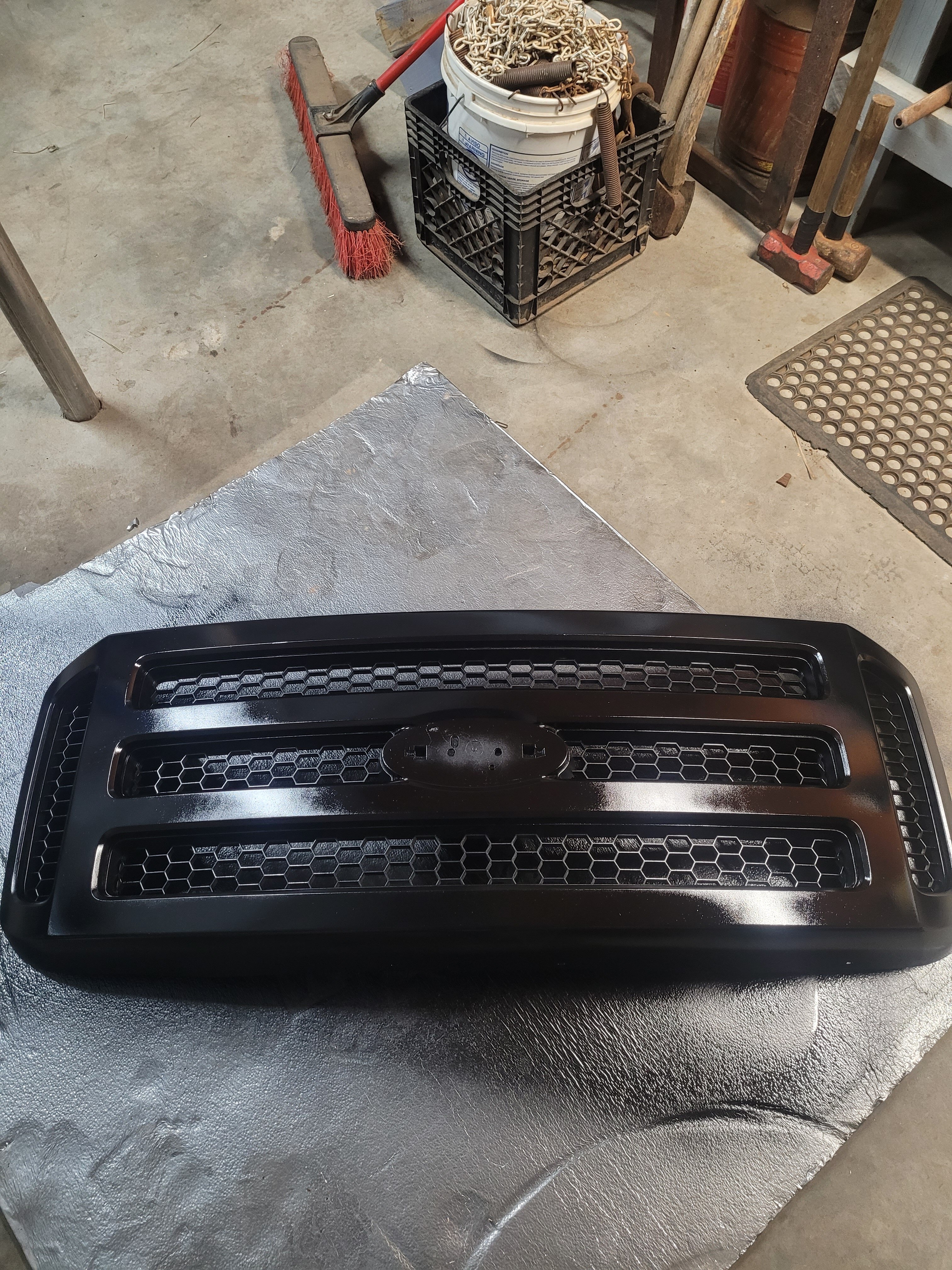

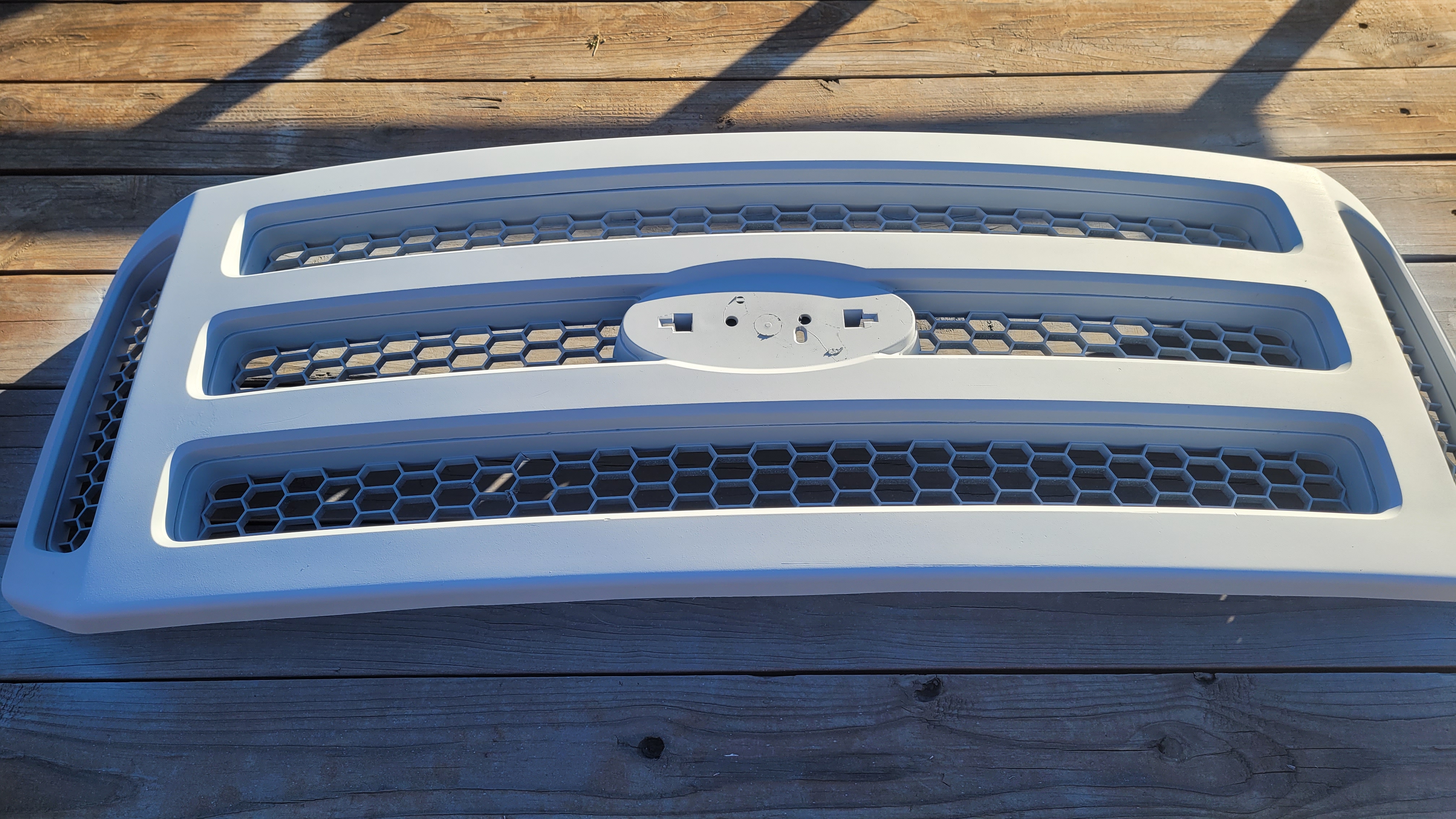

Got all the bubbled up chrome off, sanded and primed. Tomorrow's plan is painting and installing the chrome inserts.
Did you just peel the chrome finish off? I would love to remove the chrome on my grill also.
Yes. It was bubbled up really bad in some places so I was able to poke a hole in the chrome a peel it off. I tried using my power washer to remove it but it didn't work, but it did force water underneath the chrome finish and loosen it up so it was easier to peel. Be careful that chrome finish is sharp, I have several cuts on my fingertips from peeling it off with no gloves. I got it painted today but the weather was cool and damp, so it was drying really slow. Thinking about wet sanding it and trying to get a better finish on it or just going with it because I'm most likely going to replace the grill at some point in the near future. It should be dry enough to put the chrome grill inserts in tomorrow but I'll have to go get some double sided adhesive to put the Ford emblem back on.

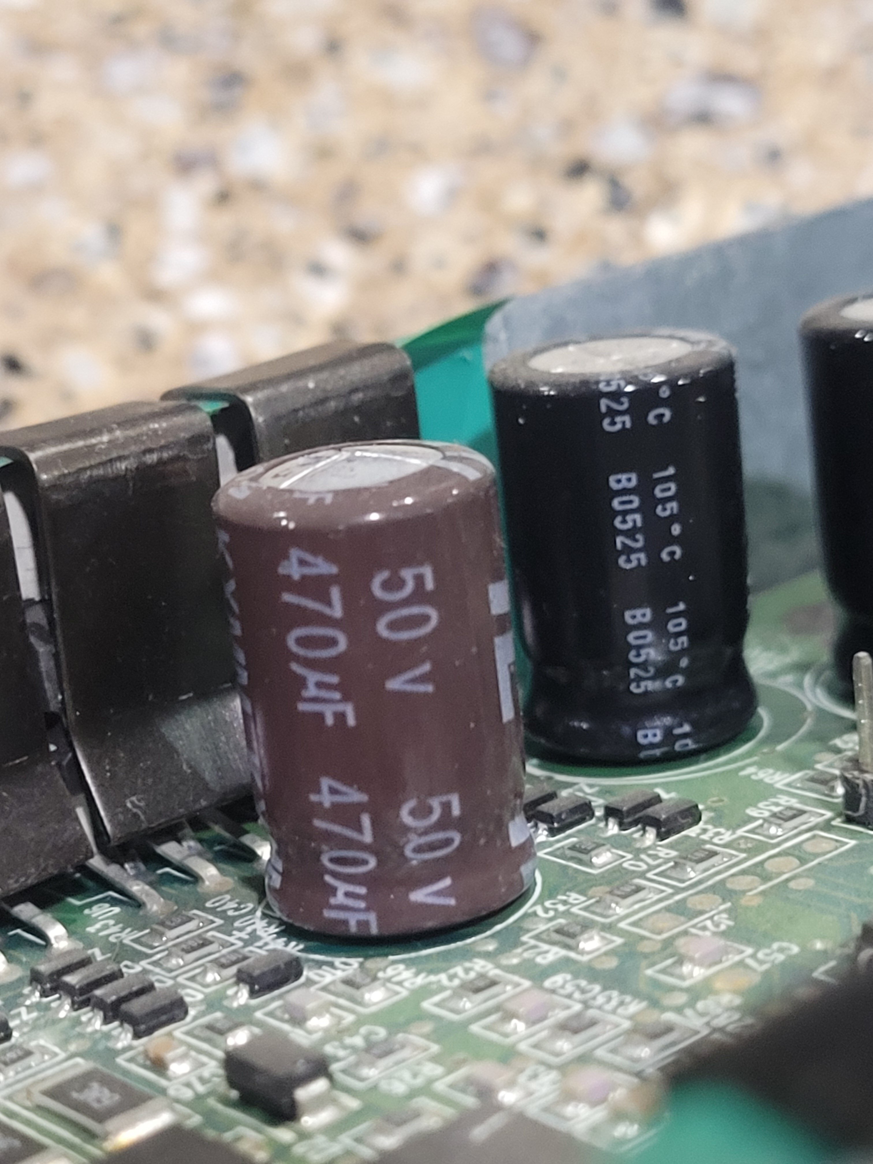

My trailer break control has been faulting out for awhile and has become very annoying. So after looking at a few videos it seems an easy repair, mostly solder joints failing over time. All my solder joints seem fine but I did have a bad capacitor, I figure it's best to replace all 3 caps and be done with it. I'm no electronic guru by any stretch of the imagination but my gut tells me that bad cap is my problem, plus it's swelled pretty noticeably. I thought, no problem I've got some caps, no such luck, I had one cap and not the value I need. Shouldn't be a problem to aquire what's needed.
