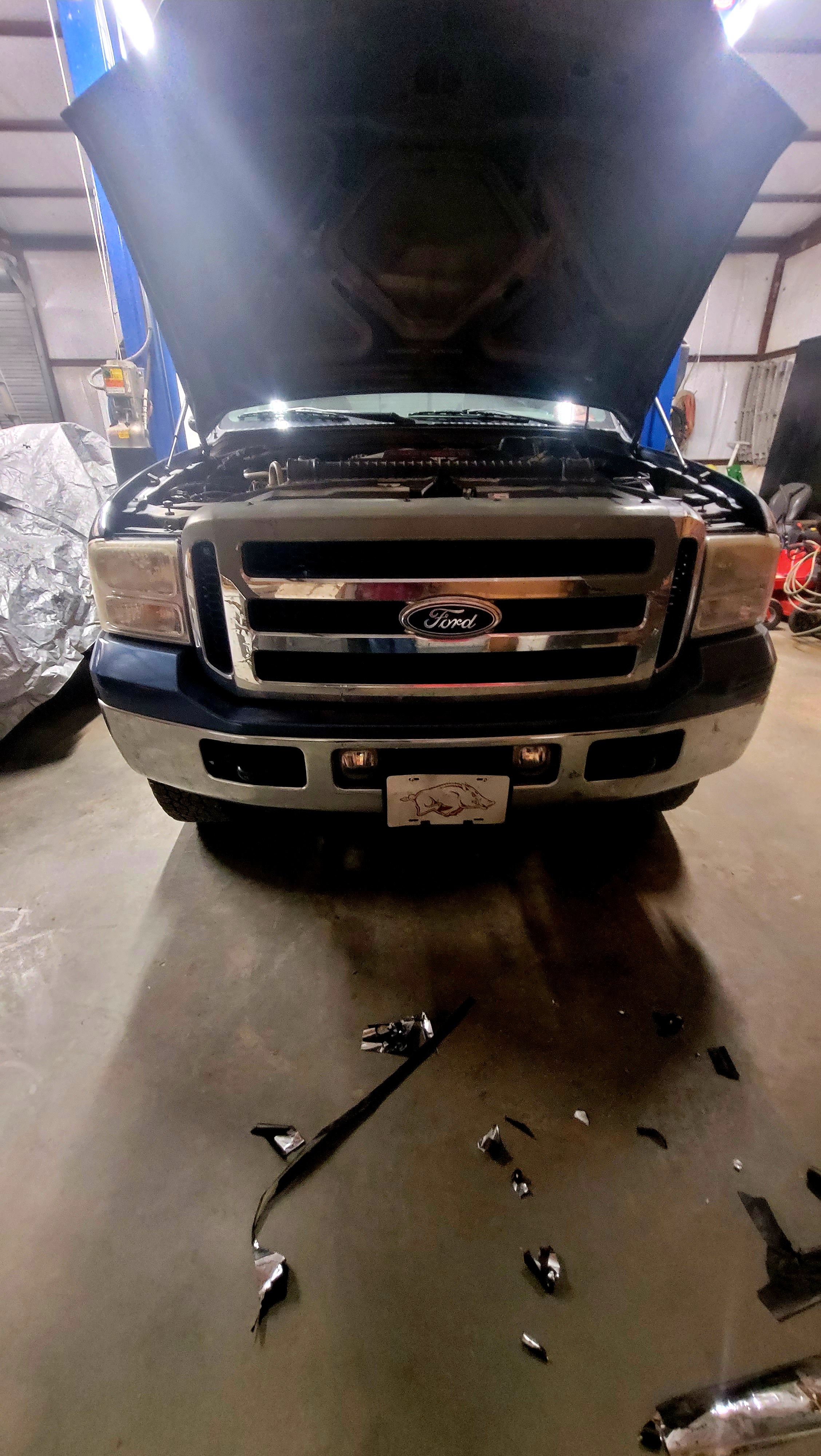

Well Andy I finally got a chance to test drive the truck over the same rough spot on the road, same wobble. So I parked it in the shop and crawled under the front end and when I grabbed the track bar and yanked on it pretty hard I've got some play in it and I can actually hear it make a slight clanking sound. So I'm thinking that's part of my problem. So I'll be getting a hold of the super duty specialist at Wister and see when he can work on the truck. I know this is over my head so I'm going to let a professional fix it. Because honestly I don't know what I'm looking at and I'm not comfortable work on something my life will be depending on.Thanks for all you advice and suggestions, it's greatly appreciated.
I still haven't made the call to see about putting my truck in the shop, but meanwhile the chrome on my grill has bubbled up and looks bad so I'm pulling it off by hand. I ordered some billit grill inserts, and I'm going to repaint the grill apoxy black then put the chrome billit inserts in. I'm thinking of getting some stainless steel bolts and drill evenly spaced holes around the grill so the heads of the bolts exposed for a more rugged look . I'm not sure how it will turn out, but in the vision in my head it looks good, if it doesn't turn out like I hope then I'll just replace the entire grill.
