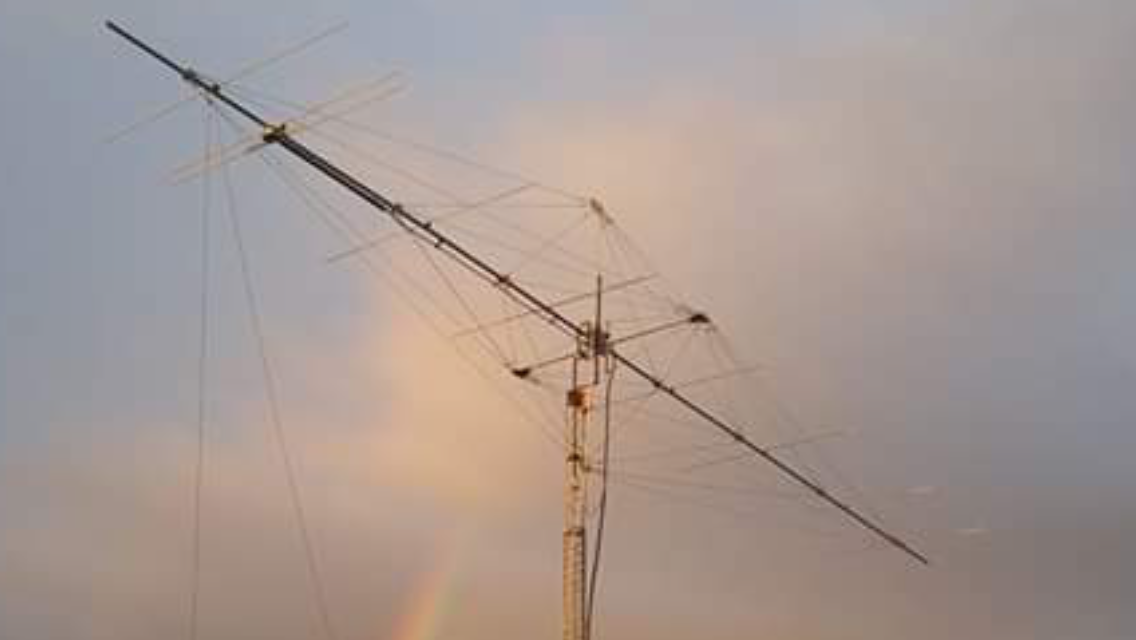

A base antenna can have real positive gain. Which is effective radiated power, so that a greater output is realized. And it is legal to do. A gain of 5.3db from a 5/8w antenna is better than being slapped in the face with a 3 day old fish. A beam antenna can have between 9db to 13db of gain, depending on the number of elements.
Used a $20 SSB radio last solar cycle and a four element Yagi, and I talked the world with that arrangement. Wasn't that stock radio that can get the credit for that, but the antenna gets all of the credit for making it effective power.

It you’re wanting fun antenna projects then there’s no shortage of them for 11M.
Rob is right...the antenna counts for a lot.
It’s just that your initial question implied mobile to base comms with a focus on what radios to buy...and you truly got some good advice. You just can’t find a better deal on a new SSB radio anywhere. It was working the world on a $20 gamble of a radio that made me part ways with his thoughts.

Doesn't have to be a Yagi; but they are nice!
A 5/8w antenna 30 ft from the ground makes the antenna effective and is omni-directional (all sides radiate equally) for local communications/skip conditions with approx. 5.5db of gain. Sirio has many offerings and price ranges. Very popular antenna; you might consider one of those.
But supporting it is important. So is grounding it for lightning. Keeping it clear from power lines should it fall for any reason or direction is your #1 concern. Some will go as far as putting up a tower, which is a costly way to go but effective. Some use push-up poles that use guy rope (dacron rope that is UV stabilized). So long as the base is stable and it is adequately guyed, that is a simple solution. I do that - BTW - cheap and simple if done right..
The length of coax used and its quality will determine the overall amount of db loss. Another important point.
Even if you were to make a simple dipole with 2.3db of gain NEEDS to be at 25 to 30 feet off of the ground to be as efficient as you would expect.
