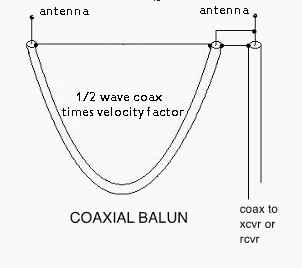

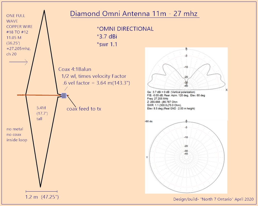

I run a 980 barefoot, 30 miles is never a problem, base to base. My antenna I built from wire is below
