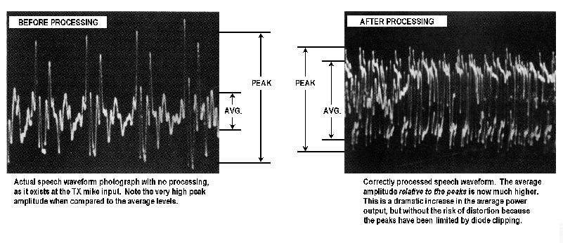

I saw these too but they quickly sold out. This much be the next batch. Because they replace jp36, they are in series with the modulation and I don't know if NPC can really be done this way. I wonder how well it can recover the carrier between peaks? The picture they show is described as NPC like. The little board looks like it has two transistors and some inductors and capacitors on It? I am going to get some to try too.
