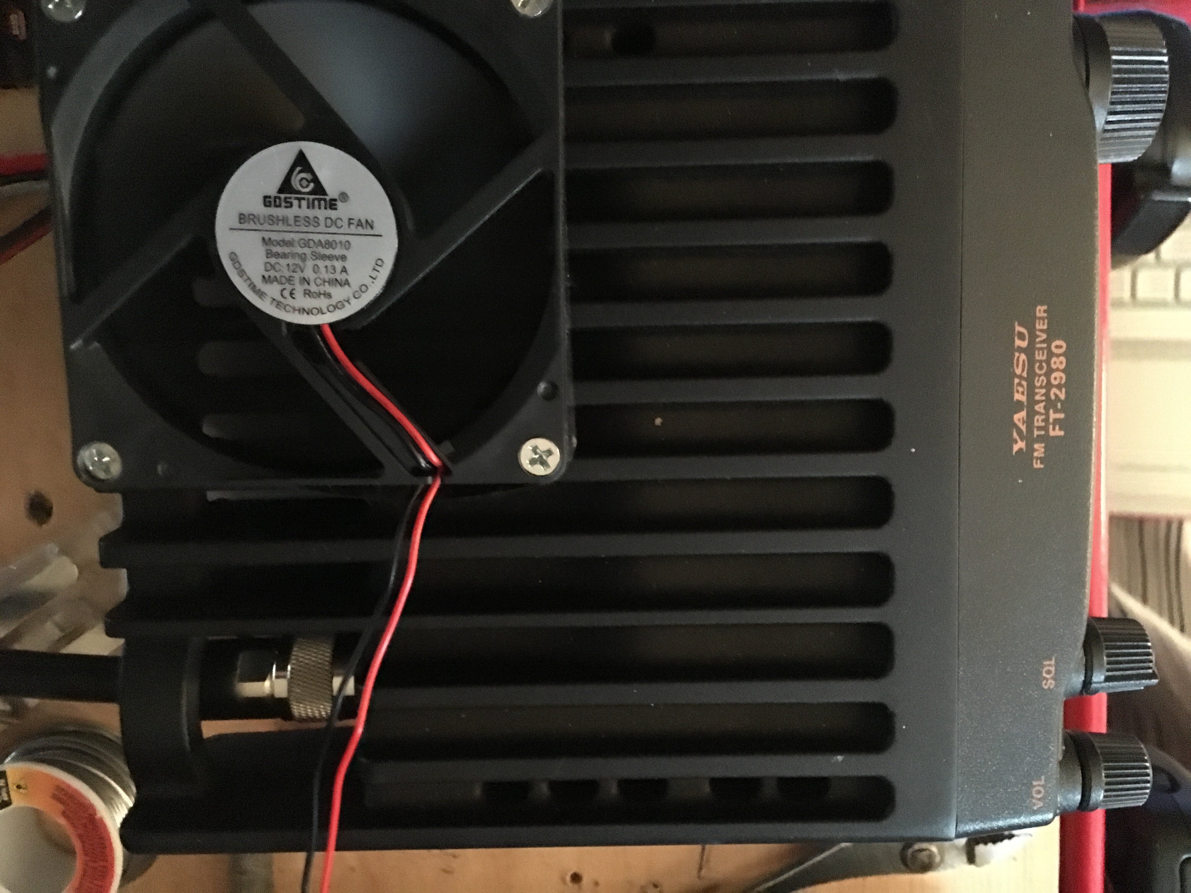

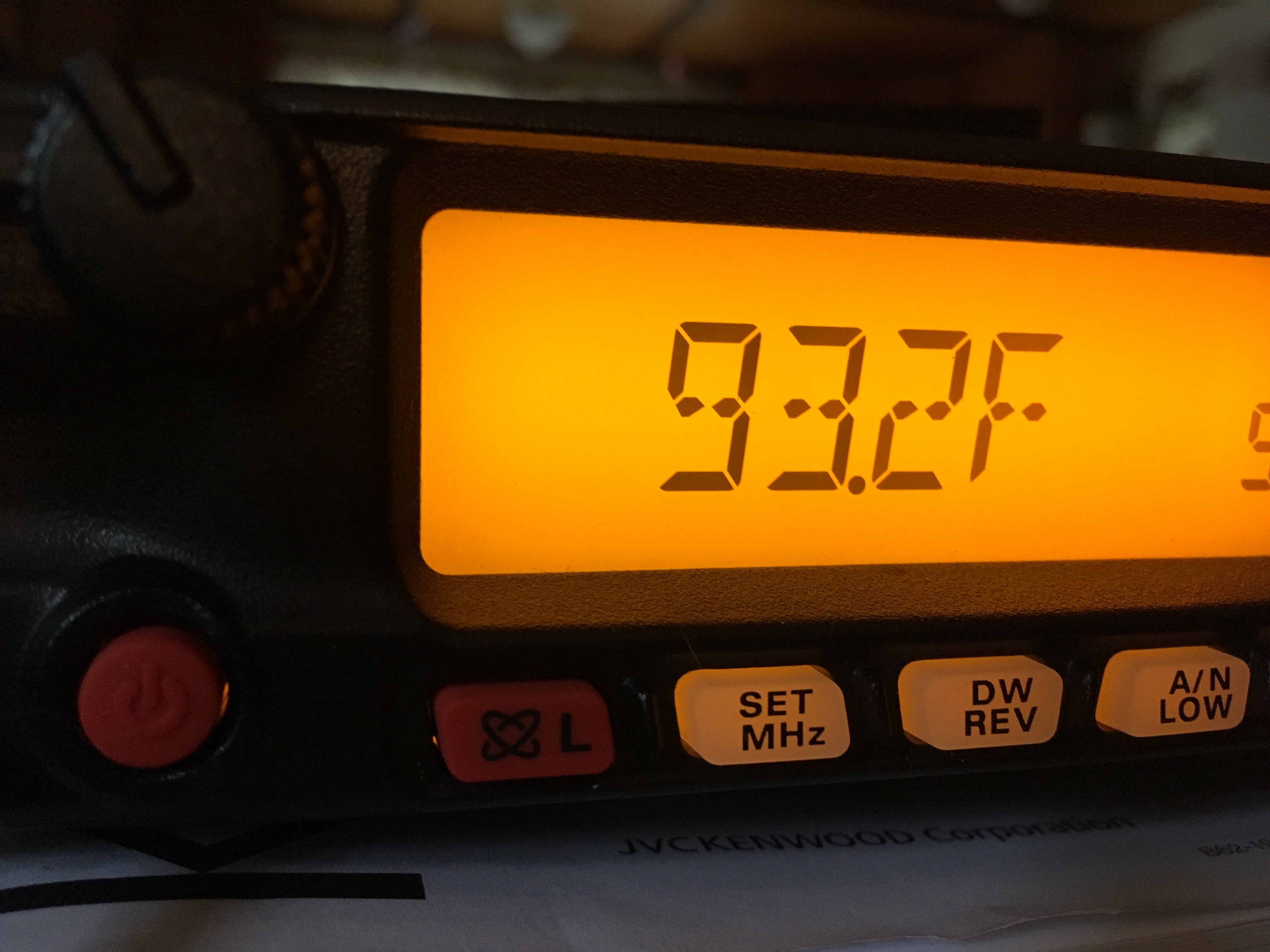

HUGE UPDATE. i removed the finals,cleaned the hit n miss thermal paste. put a very light even coat on the finals then installed tightning the screws then soldering it back. lyin tech at yahoo. i laid a fan on top be seen in photos. i talked simplex with 3 friends setting on 80 watts.it stayed cool. about 73 degrees in my house n radio never got up to 100 degrees. plus the voltage didnt drop as bad either. if i did it all over again id remove finals n check them but why must 1 do this to a new radio? i will use it n see what dies next.View attachment 44819 View attachment 44820 i used to solder tiny battery cells at eagle pitcher back in the winter of 74 as dump truck used to stop when it grew cold. i soldered cells for space craft batterys that activated many functions. id get a headache every night when i soldered the mini batterys,used a magnifying stand n holding fixture. i can solder so i did fix my yaaHOO
