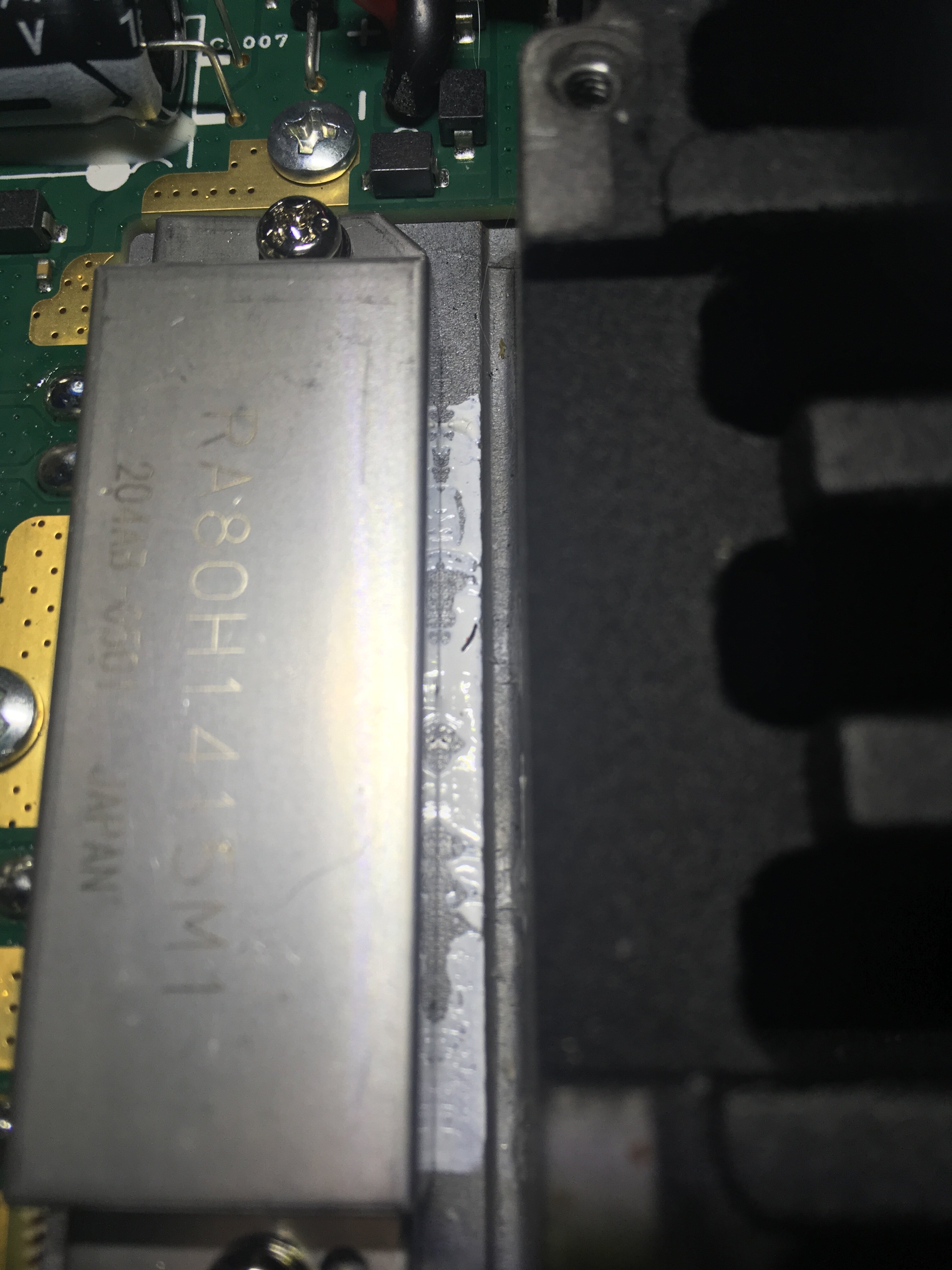

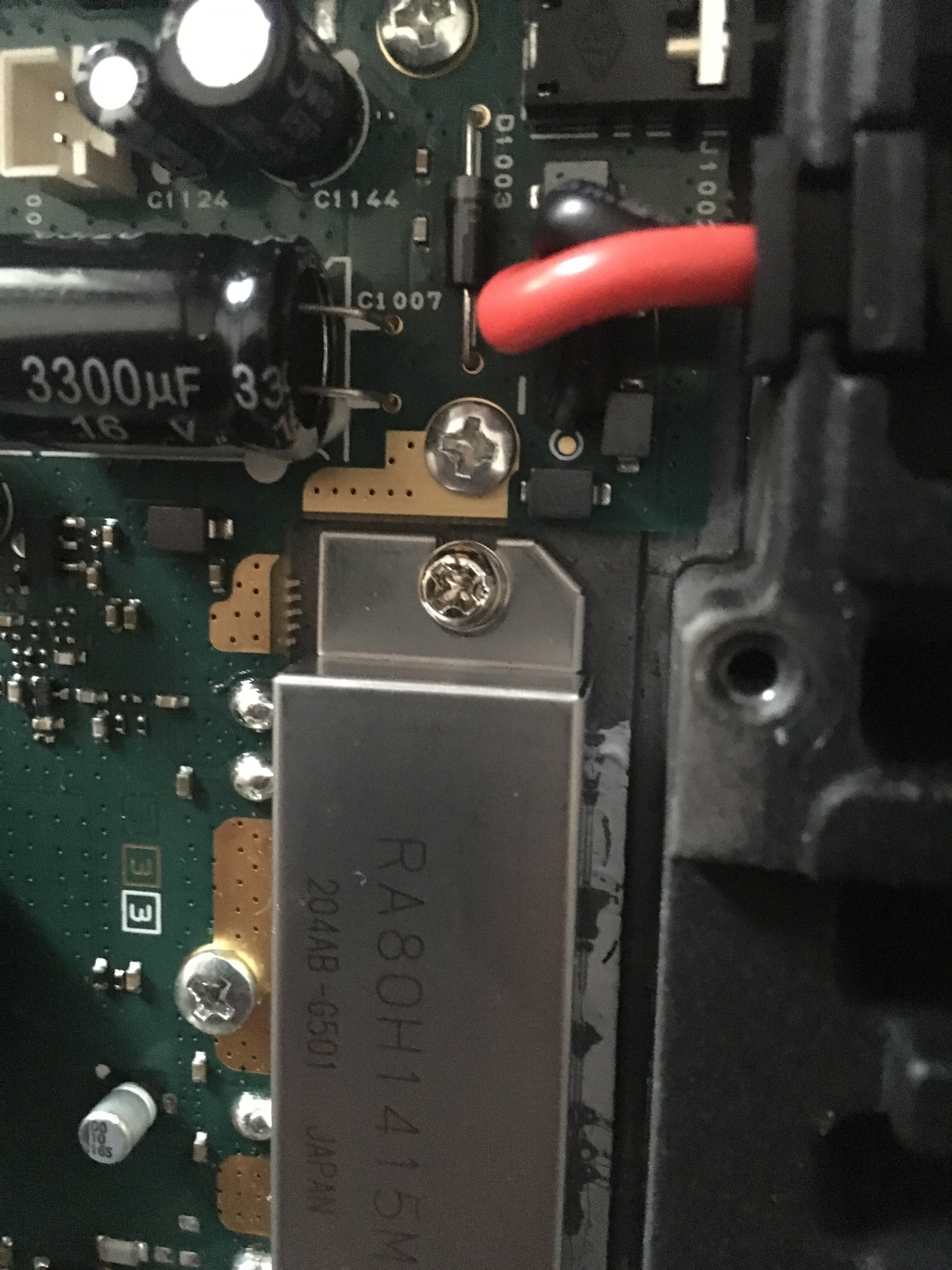

i wanted a high power 2 meter radio. what i wanted was dropped from production so i bought this pos. worked sorta ok for a few minutes n temperature spiked ,transmission went down. im saying about 3 minutes on 80 watts on simplex,thats 2 way conservation. let it cool down n same crap again. checked voltage. it drops a 40 power supply from 14 volts to 12.5 on 30 watts n from 14 volts on 80 watts to 11.9 volts. i spent $25 for shipping to let it set at repair center 2 damm months just to get a new mic n a severe lecture about using 80 watts. i asked wtf they put 80 watt capability in it n i cant use it? subject was changed immedietly to my power supply is bad. i then said i run a 160 watt mirage n it only drops my power supply from 14 volts to 13.6. anyhow i see ive lost the battle. when the pos arrived it got hot on 30 watts talking simplex like 150 degrees in 10 minutes. its new but hey they aint gonna fix it so i opened it up n seen shitty workmanship. can anybody else spot the trouble? im waiting on a needed item to arrive n i will fix it myself. 1 ground lug soldered too,not a killer but sloppy workmanship. least i only got 1 lug to unsolder on ground side you can see slip of paper between board n ground lug
i wanted a high power 2 meter radio. what i wanted was dropped from production so i bought this pos. worked sorta ok for a few minutes n temperature spiked ,transmission went down. im saying about 3 minutes on 80 watts on simplex,thats 2 way conservation. let it cool down n same crap again. checked voltage. it drops a 40 power supply from 14 volts to 12.5 on 30 watts n from 14 volts on 80 watts to 11.9 volts. i spent $25 for shipping to let it set at repair center 2 damm months just to get a new mic n a severe lecture about using 80 watts. i asked wtf they put 80 watt capability in it n i cant use it? subject was changed immedietly to my power supply is bad. i then said i run a 160 watt mirage n it only drops my power supply from 14 volts to 13.6. anyhow i see ive lost the battle. when the pos arrived it got hot on 30 watts talking simplex like 150 degrees in 10 minutes. its new but hey they aint gonna fix it so i opened it up n seen shitty workmanship. can anybody else spot the trouble? im waiting on a needed item to arrive n i will fix it myself. 1 ground lug soldered too,not a killer but sloppy workmanship. least i only got 1 lug to unsolder on ground side you can see slip of paper between board n ground lugView attachment 44797 View attachment 44798 View attachment 44799
I don't see any mention of what brand the radio is but I know that Yaesu has had many issues with their so called 80 watt radios that us a 75 watt final.The TYT & QYT models also have lots of issues with failures & I have a QYT that I'm returning Tomorrow & it's only a 25 watt model that lasted about 2 hours of actual talk time.Glad I purchased the 3 year extended warranty from Amazon or I'd be stuck with a Useless POS that does not work on transmit on the 440 band.

That RF module package was enough of a problem when they started trying to stuff 25 and 50 watt output and driver stages in the same package. Reliability can only drop off from there, on your way to achieving 80 watts from a 75 watt module. When I use to do service work, Kenwood VHF and UHF radios were constantly blowing up these RF packages because, Kenwood didn't feel there was any need to place more than a half drop of heatsink compound on the back.
My advice on new purchases like this, is to open the cover immediately after buying it and inspect the RF module for any trace of heatsink compound protruding out of the any edge of the part. When you see none, remove the two screws, tilt the package upwards and put some compound under it before your 90 day warranty backfires on you. Any radio using this type of RF output module, is not going to be as reliable as one that uses a discrete driver and final transistor.
it gets fixed n it goin byebye. sad they do low quality build to sell numbers. i promise no more of this brand. and the bs story service guy told me left me thinkin he is rehersed to say certain things n avoid answers like me asking why i cant use the advertised 80 watts? i do talk simplex a long way n use the power.when local i use less.

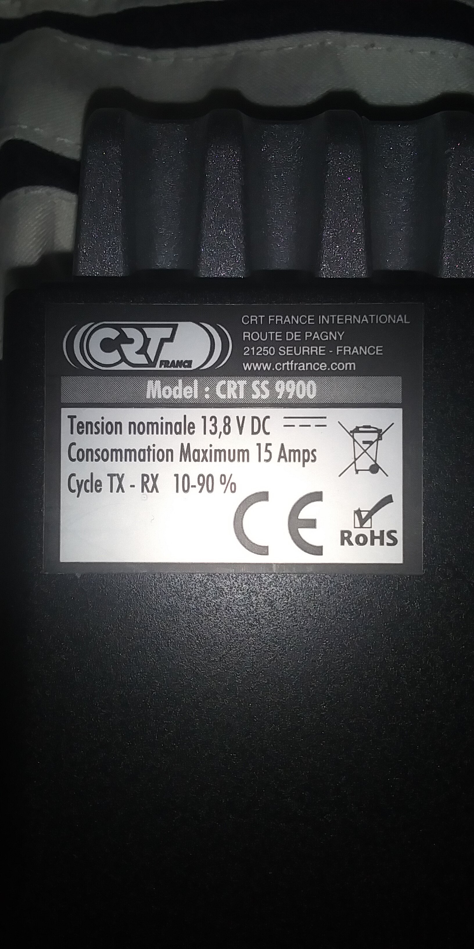

These ratings are bull
Look at the label on this 9900 showing duty cycle.
I think this how they try to. call it a 60 watt radio, by reducing the duty cycle.
So in this case Yaesu is calling it a 80 watt radio.....but at what Duty cycle?
I wonder what Yaesu uses for this number ?
Do they even list this info in the manual?
After they got done "fixing" your radio do they not even bench test it and see the power output dropping?
This is getting to be the norm with manufactures.
Jeff

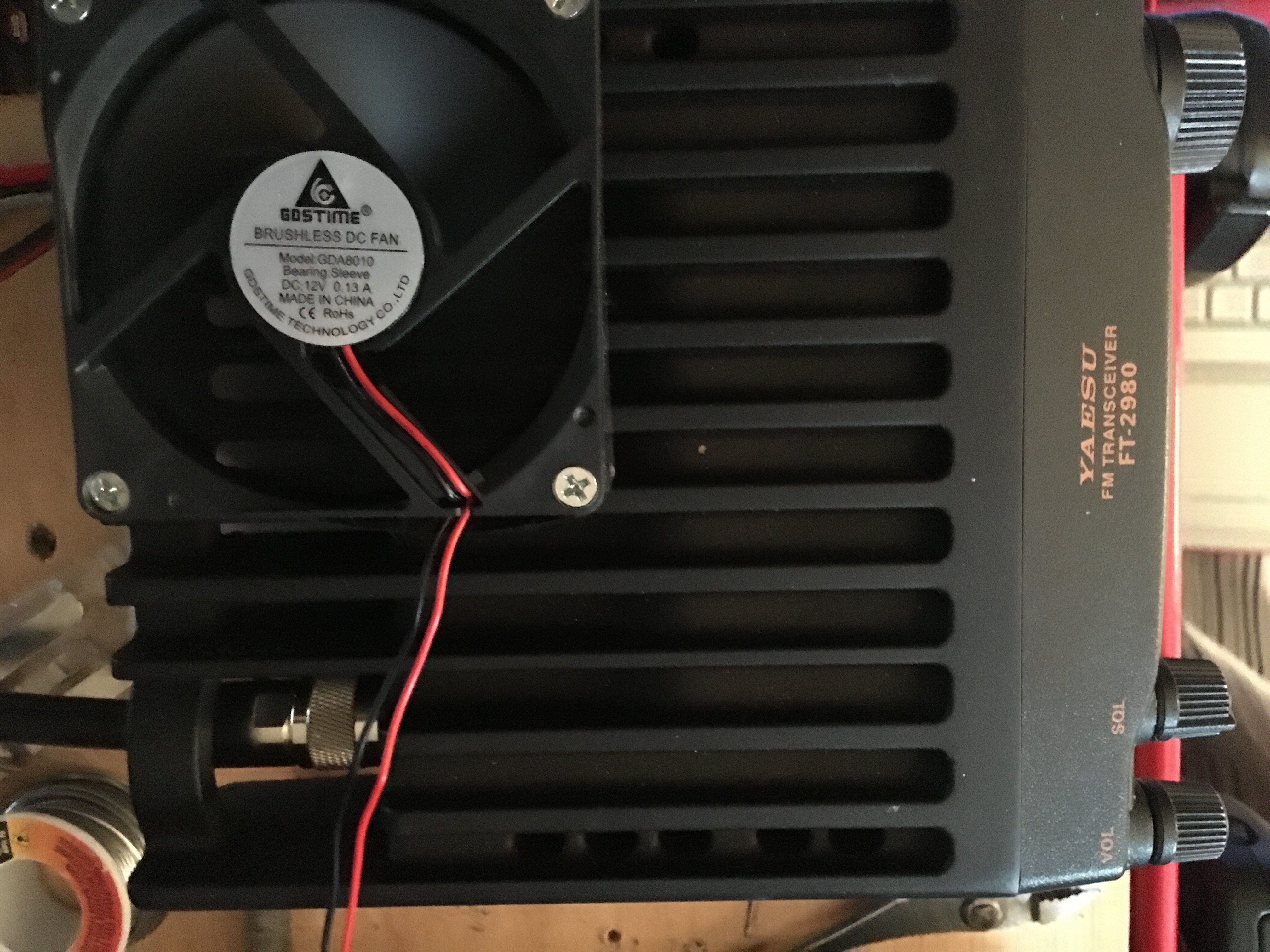

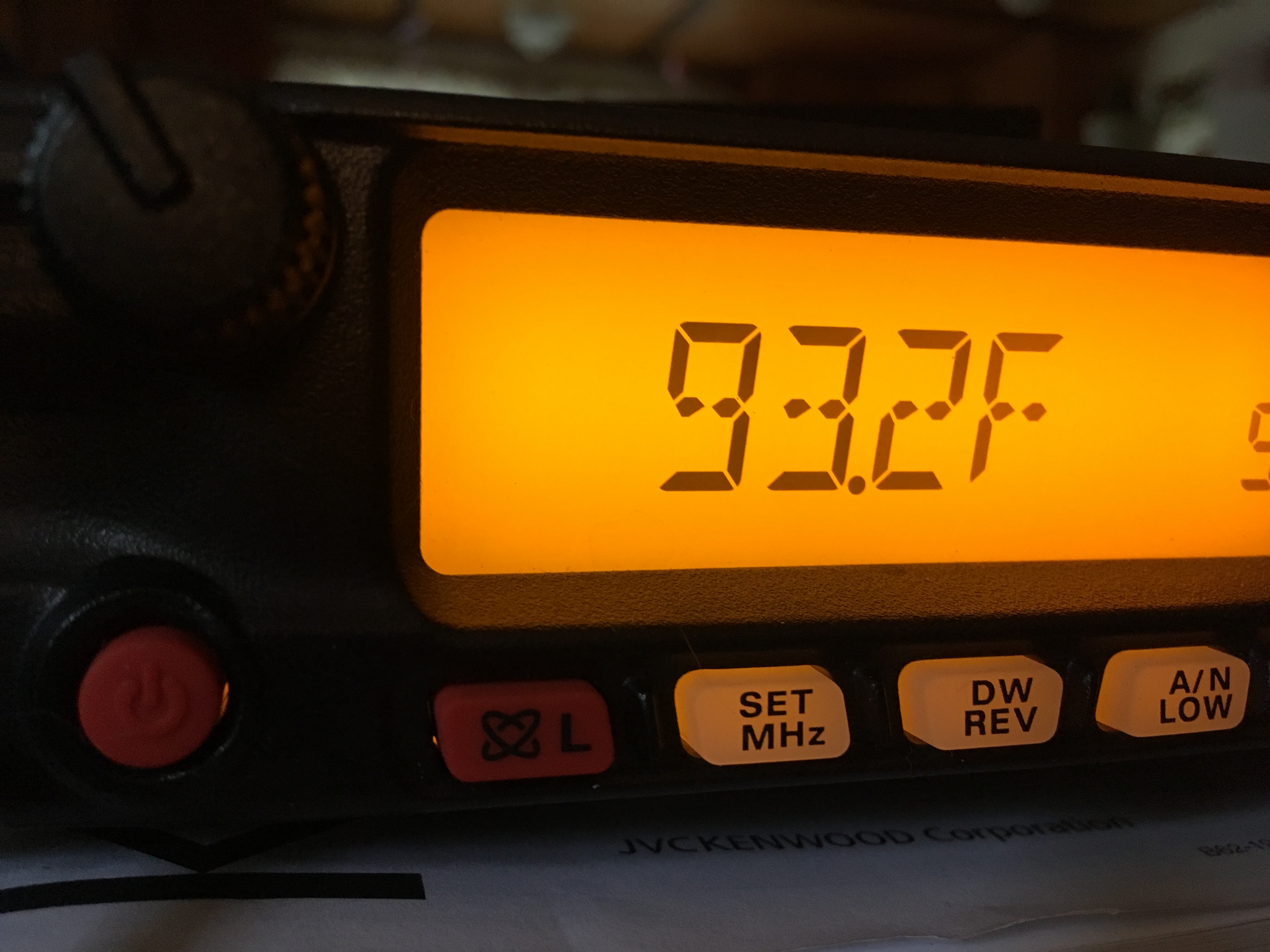

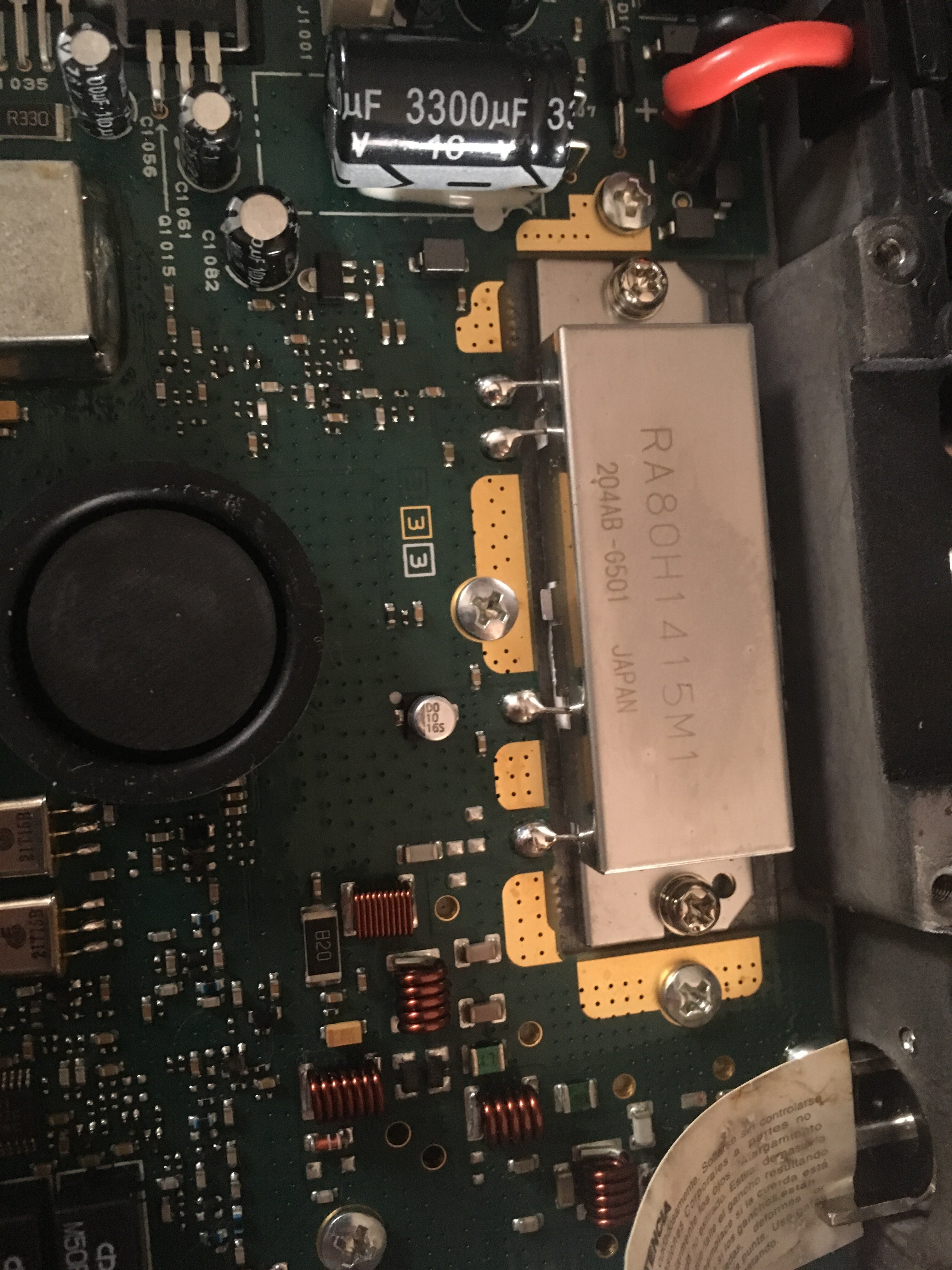

HUGE UPDATE. i removed the finals,cleaned the hit n miss thermal paste. put a very light even coat on the finals then installed tightning the screws then soldering it back. lyin tech at yahoo. i laid a fan on top be seen in photos. i talked simplex with 3 friends setting on 80 watts.it stayed cool. about 73 degrees in my house n radio never got up to 100 degrees. plus the voltage didnt drop as bad either. if i did it all over again id remove finals n check them but why must 1 do this to a new radio? i will use it n see what dies next.

Out of the "big three", Yaesu is the least trusted name in new ham radio equipment. Everything I purchased from Yaesu 20 and 30 years ago, is still working today. Everything I purchased new from Yaesu within the last 10 years, was sold with factory defects that eventually deteriorated into multiple failures making them paper weights today.
Just be glad your fix was easy and you got to it before it ate up the RF module. Once it gets hot enough for the efficiency to drop off to the point where you see it drawing more current, while making less output, you're about an inch away from cooking the final transistor. It's a combination of not caring about debugging anything prior to initial sale, combined with "planed obsolescence".
Because that final is inside a module containing everything from the tuned input to the driver, through the output strip lines, you have to pay three times as much for this part as a more reliable, discrete final transistor. I noticed it looks like Yaesu is rolling the compound onto the heatsink. It is very easy to see in the pictures, an area above the module where the heatsink compound was applied. Unfortunately, there are huge voids in the application that were probably under the part too.
This problem is common and not one exclusive to Yaesu. We should expect anything new to have a poor application of compound and if the rig is valuable, inspect and repair immediately upon purchase. You'd be amazed how many outputs are installed without properly torqueing the screws down too. Always check to make sure they are snug enough to maintain the required pressure against the heatsink but, not tight enough to distort the mounting surface of the part or heatsink.
The reason we have things like "SillPads" and all types of compound alternatives is because it takes a skilled person to apply a thin, even layer of compound by hand and insure the output has been properly mounted to the heatsink. Automation usually fails here unless all skill requirements can be removed, by eliminating the compound in favor of a lesser thermal bond.
