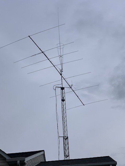

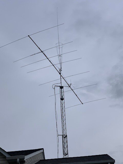

This is my first Sirio Vector 4000. The OEM advertise as new and improved... What did they improve? I'm hoping it will last for a while on the Tower and not break. Sometimes we get some strong wind gusts and storms here in Maryland..
They improved it by making the cone legs 108", old model used 90"
overall length is 3/4wave, old model was 7/8,
sirio claim that gives a lower radiation angle. it probably does, the old version was too long.

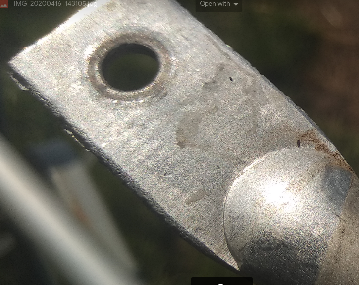

Looks good up their ..how high is it ? the weak point seams the ring attachment to the radals ,,on mine the way sirio had crimp the end of the tube flat thay had crimpt it way to hard and flat so i believe it has over work hardened it you can see below its splits at the side and has left a mark in raduas around the area around the uncrimp part that may crack.

here is a vid of me beefing up my ring

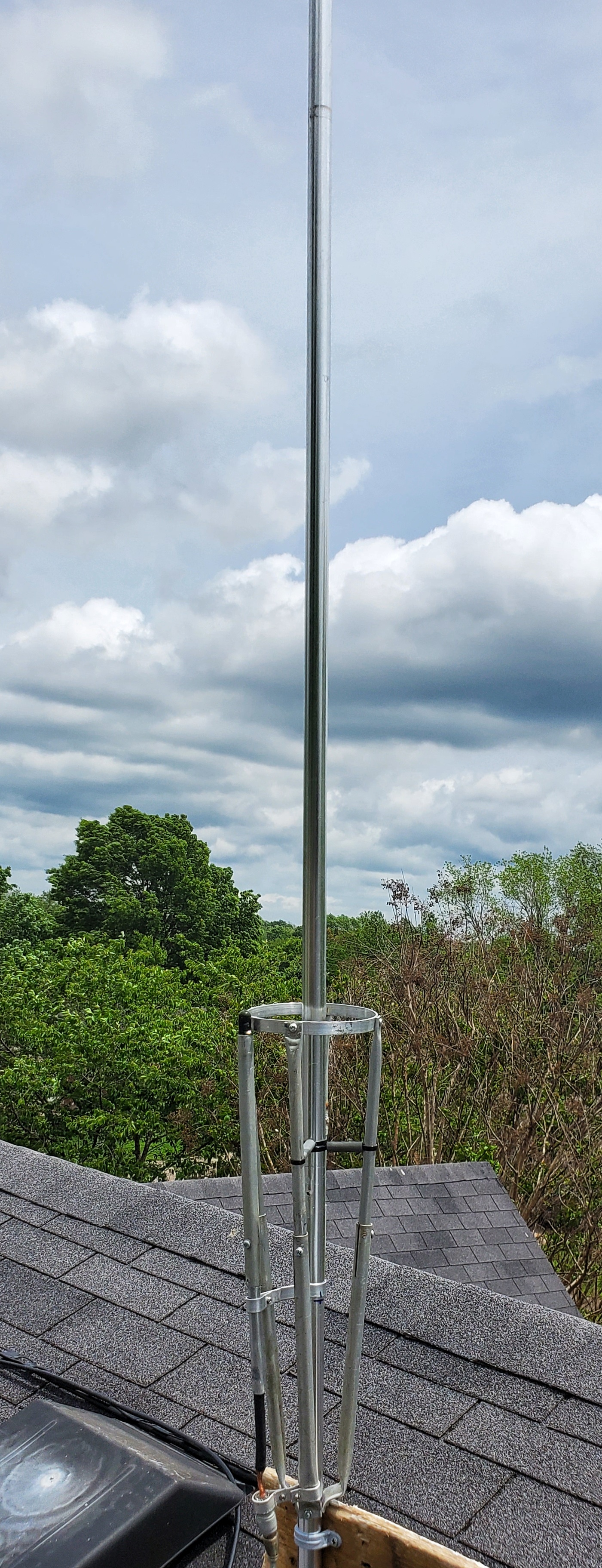

2m V4k back in operation. Some zinc coated screws to be replaced with stainless steel a soon as the weather clears after the weekend and I pick them up from the hardware store.
Analyzer (MFJ-259B) not measuring correctly so this one is set with VHF/UHF SWR meter.
Band edges are 1.3:1 & 1.4:1. It is 1.1:1 in the middle of the band.
Now to test it on the air over time. Will see how it does on on Monday night Simplex Trader's Net on 146.520 7:30 PM. That will give me a good sampling of near and farther out 2m stations.
Don’t you have any interaction between them ?
Sirio says that the V 4000 don’t like nearby antennas. Any issues with SWR ?
Reactions: Rwb
No SWR issues. I tuned it on a 10ft pole attached to my deck, then put it on the tower. Tune is great, SWR 1.2 at its highest.The Sirio is currently doing a great job making DX contacts. Its doing so great i might upgrade to a 10K watt Gamma
