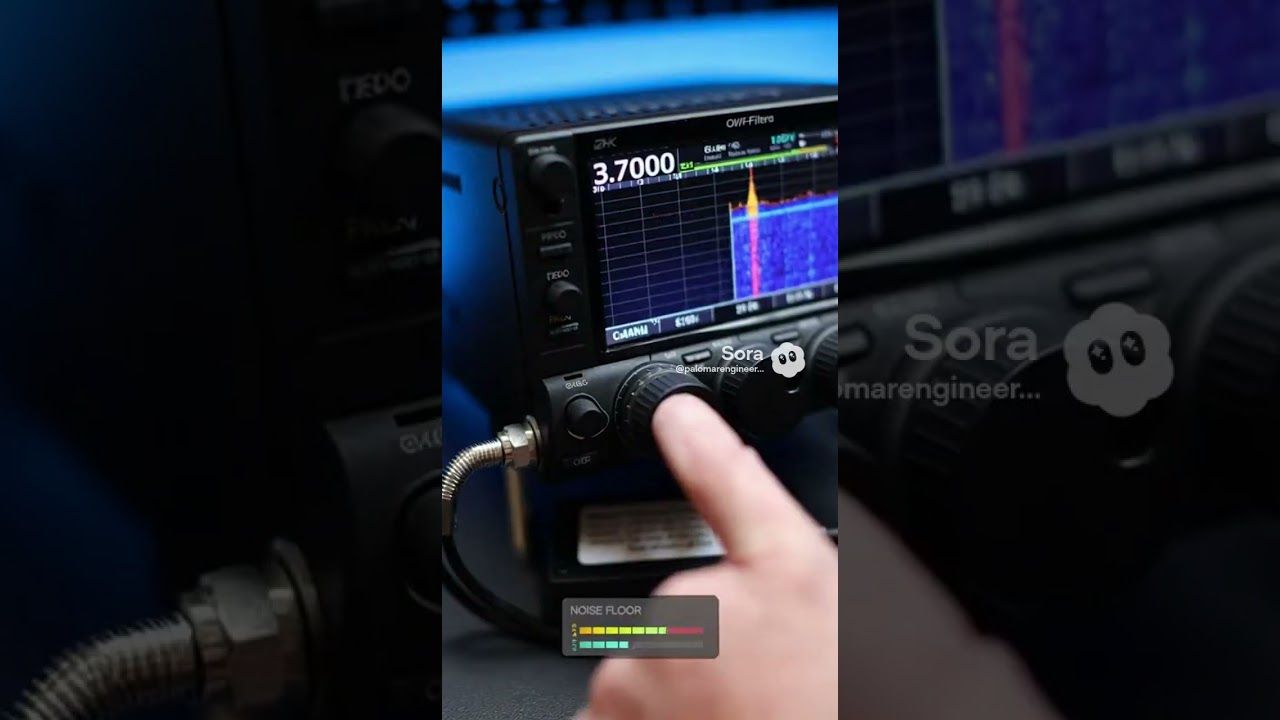

I've been through all the ARRL samples and power line noise sounds very close but not quite the same. This is a loud clicking sound that's coming through on all channels upper and lower side band.
Check out the video sample. I figured someone here would have heard this before
Sample noise

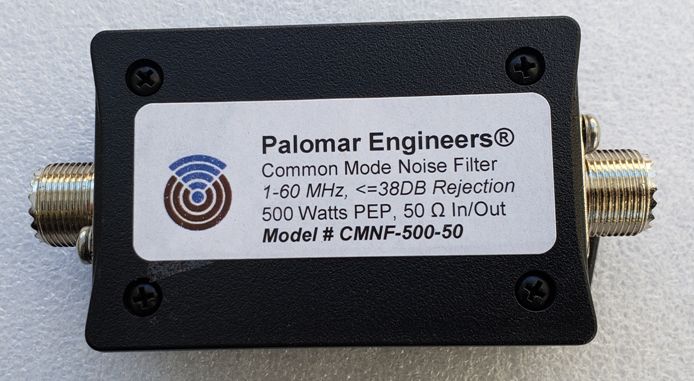

I see these things all over Palomar in various sizes and shapes and frequency support... I see they are for feed line common mode noise.. if we find out the house is not the culprit will this help say right below the antenna feed point? or is something like solar or power transformer noise just too in your face here?
