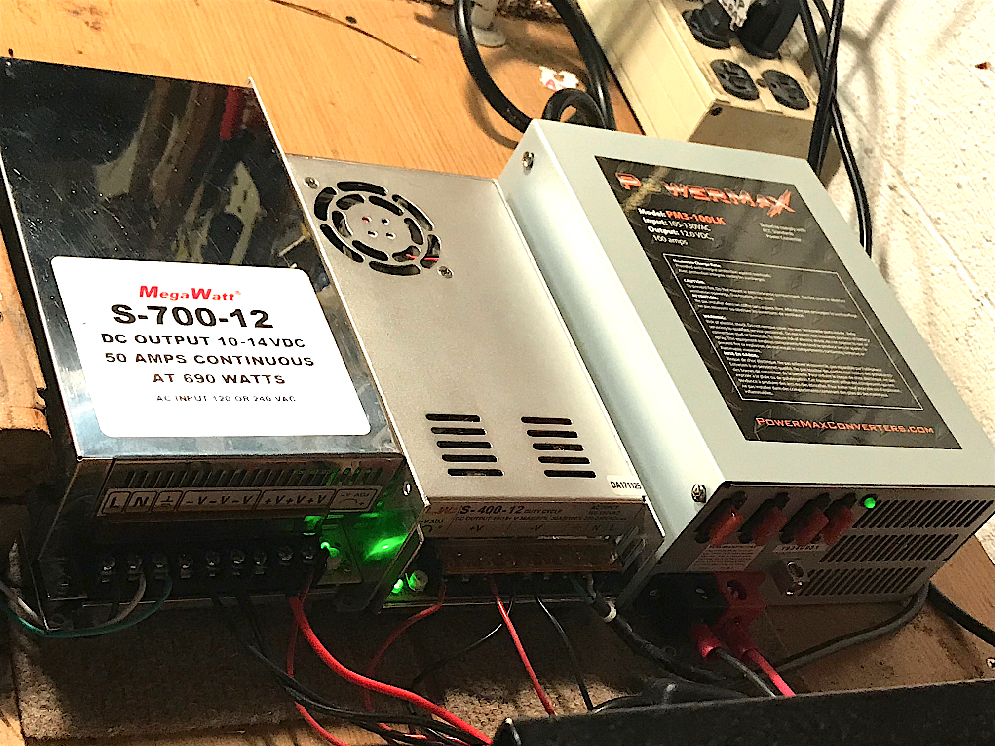

PowerMax pm3-100 received & hooked up. Works great nice and quiet. No noise from it in receive or locally heard transmit. Don't have a ground wire attached in the provided location but will probably do so. Need to do some wire management. o_O
S-700-12......S-400-12......PowerMax PM3-100
So did you just flick the side switch to locked voltage and go with it??

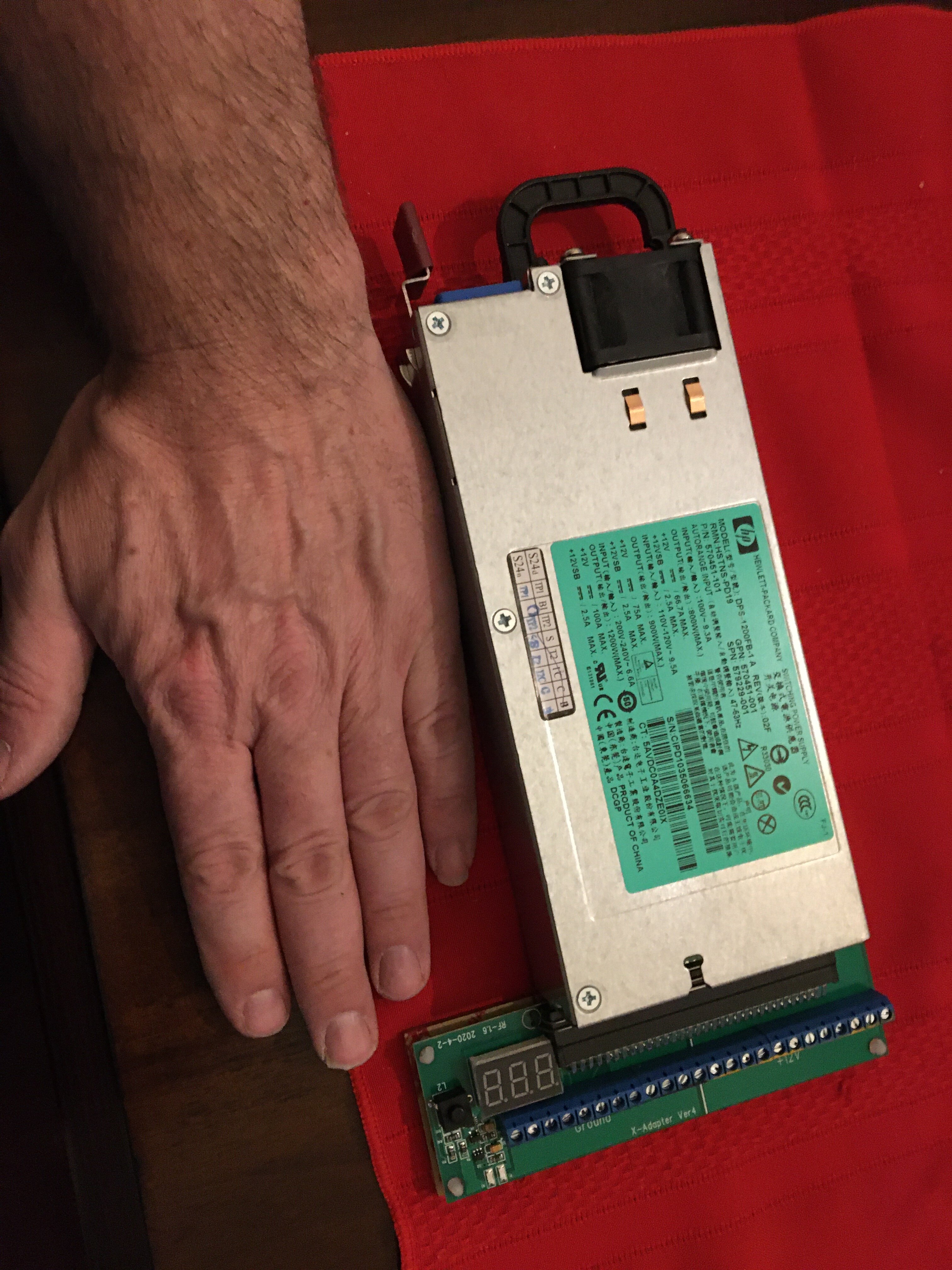

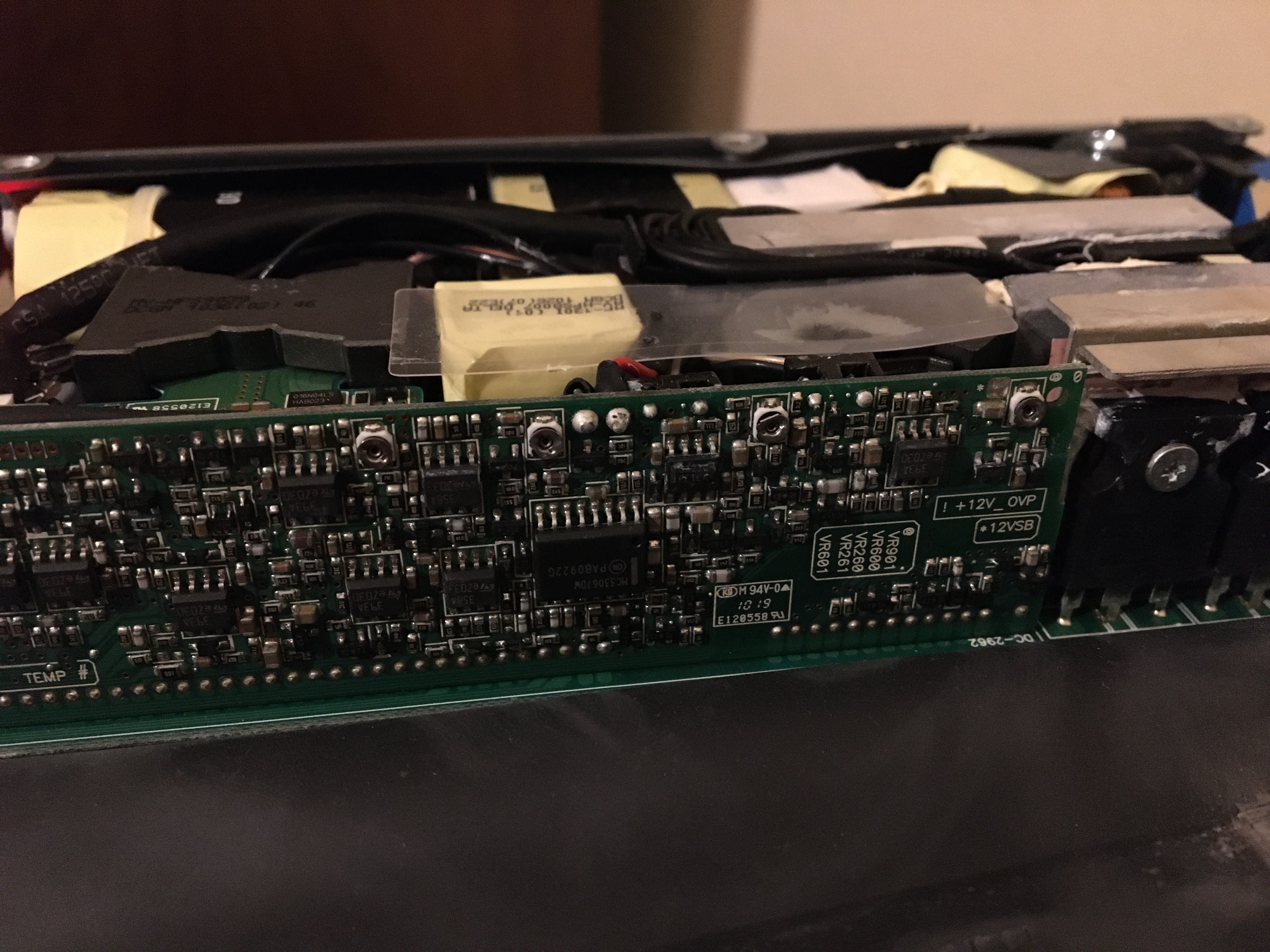

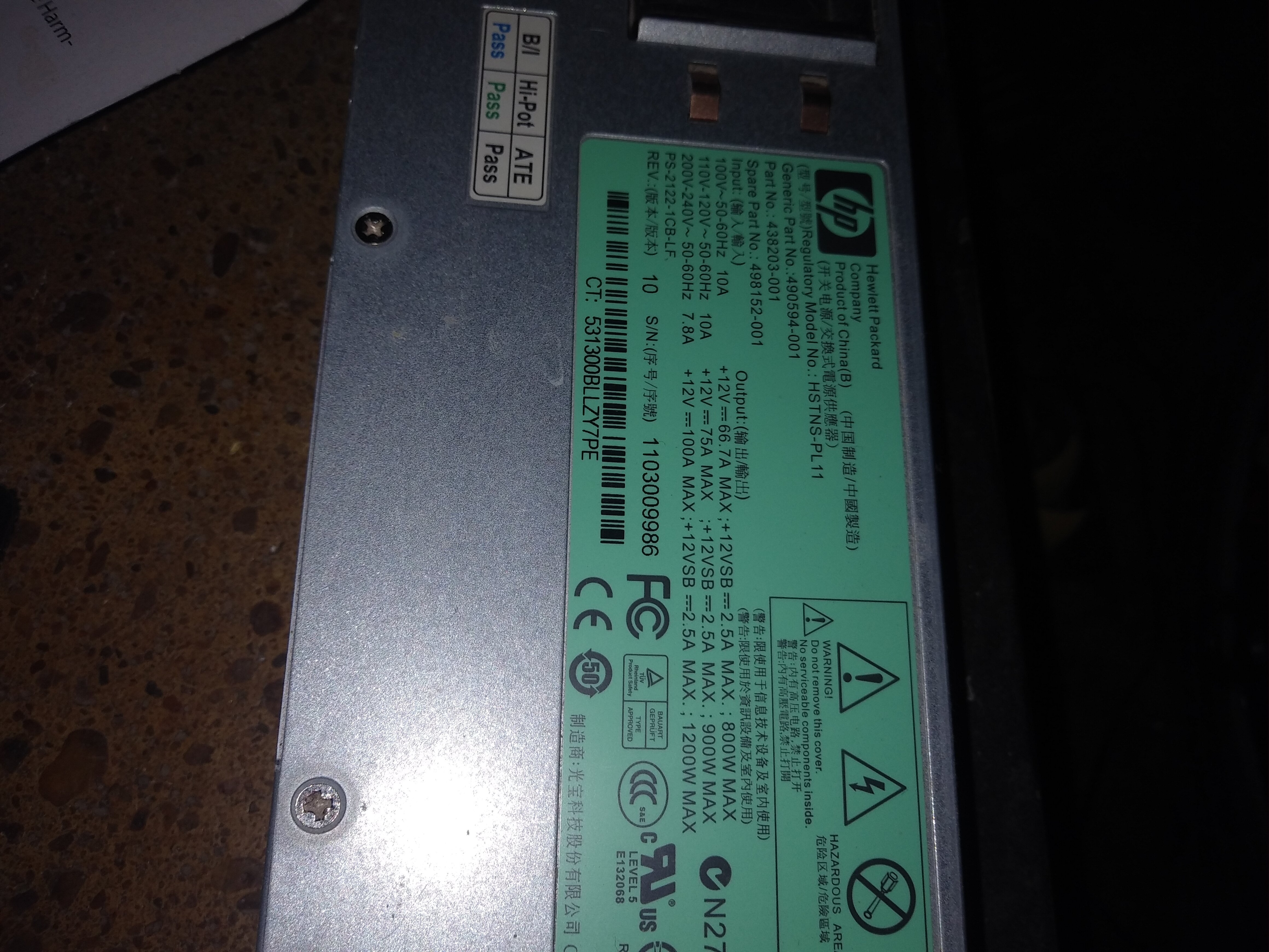

Got in the 1200/900w (220/120VAC) HP server supply. This thing is small. Shown with the breakout board that had the small terminals. (Bigger terminal board on way).
8 1/2" length x 3 1/2" wide x 1 1/2" tall without the black pull handle.
Stay tuned for more info. After dinner.

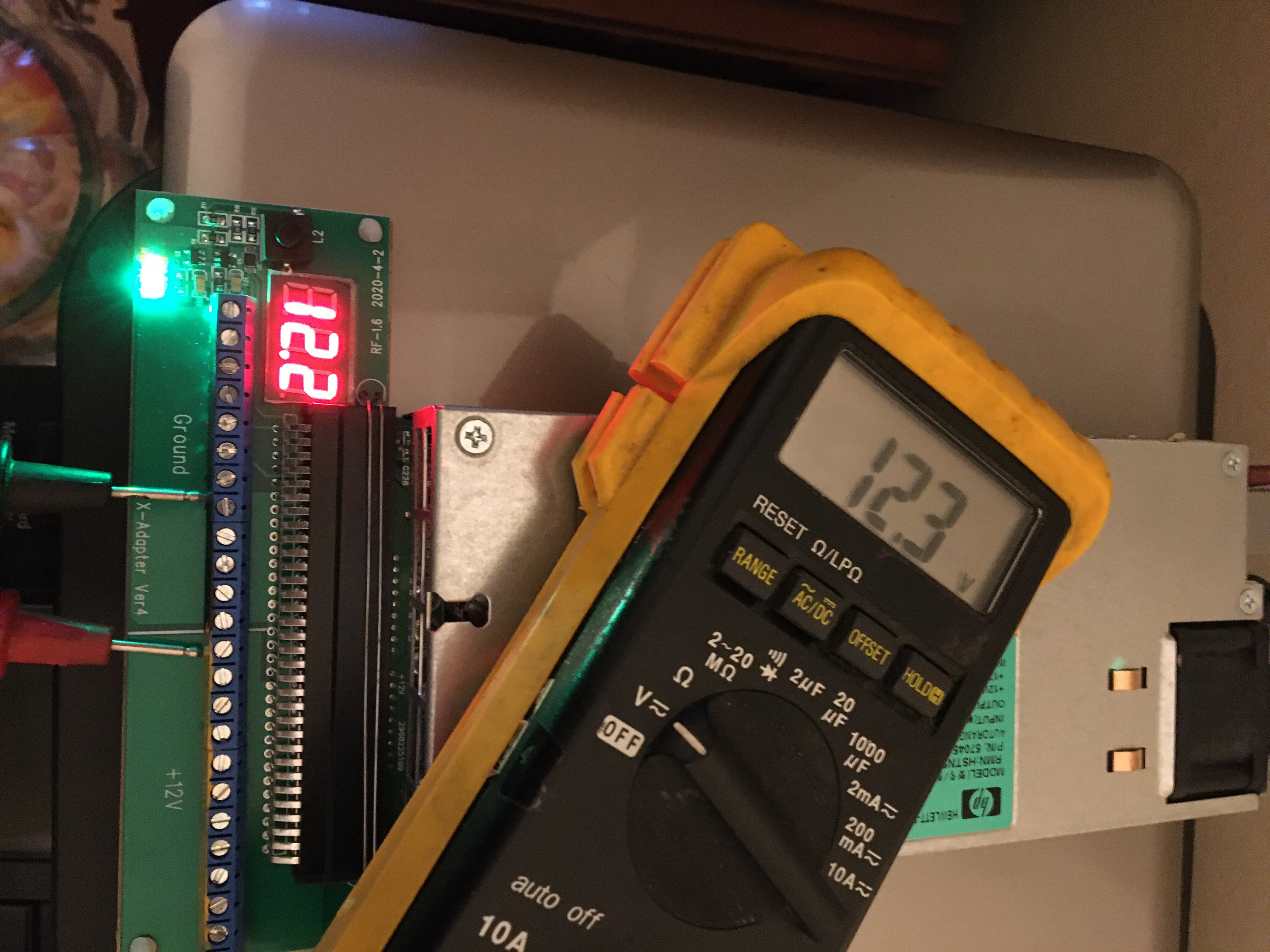

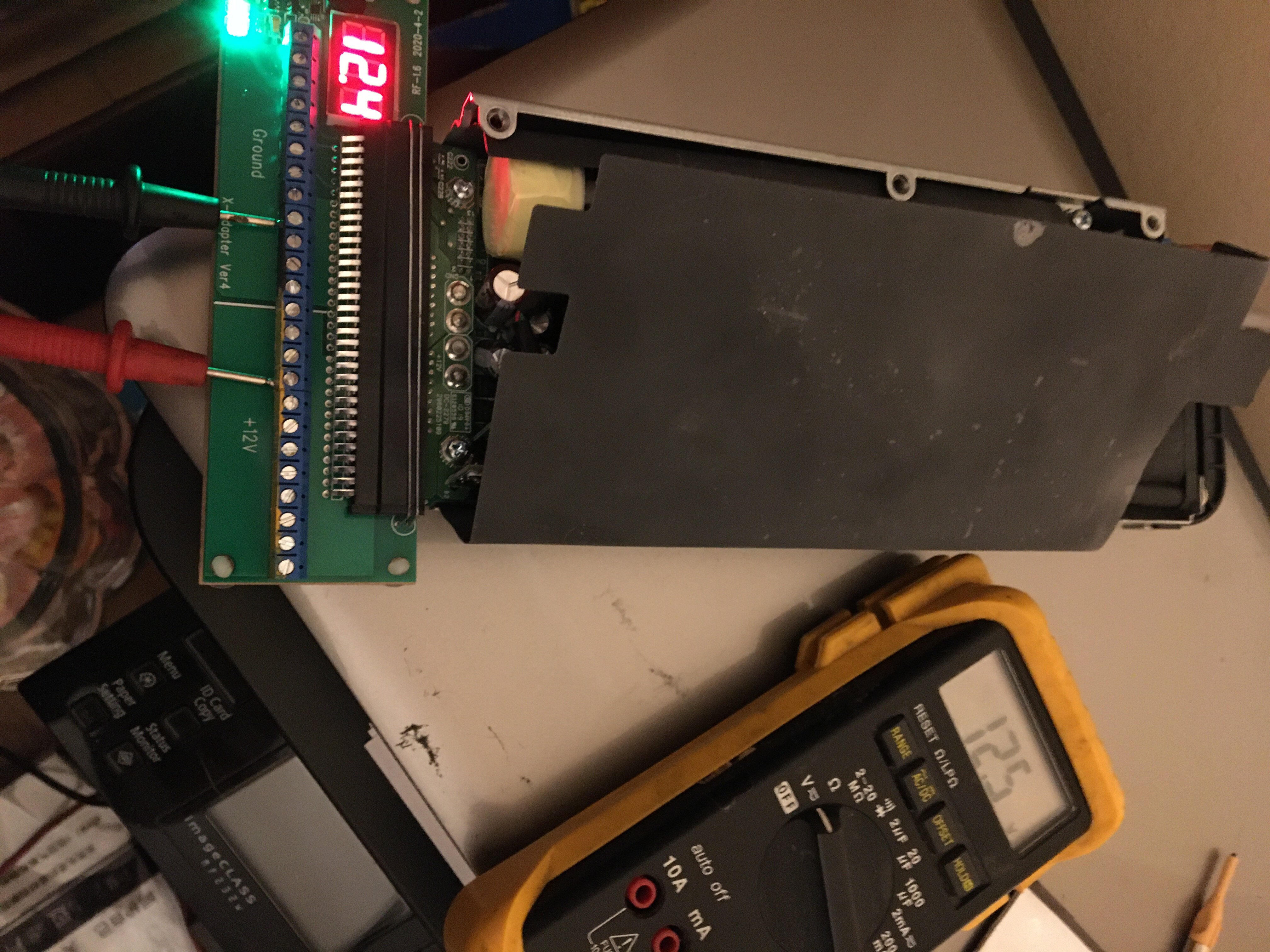

So it came up 12.1-12.2 on the meter. Actual was 12.3. After bumping up the voltage to 12.5 it flipped to 11.8. So I moved it back to 12.4 on the meter and got a 12.5 final on my meter. (y)

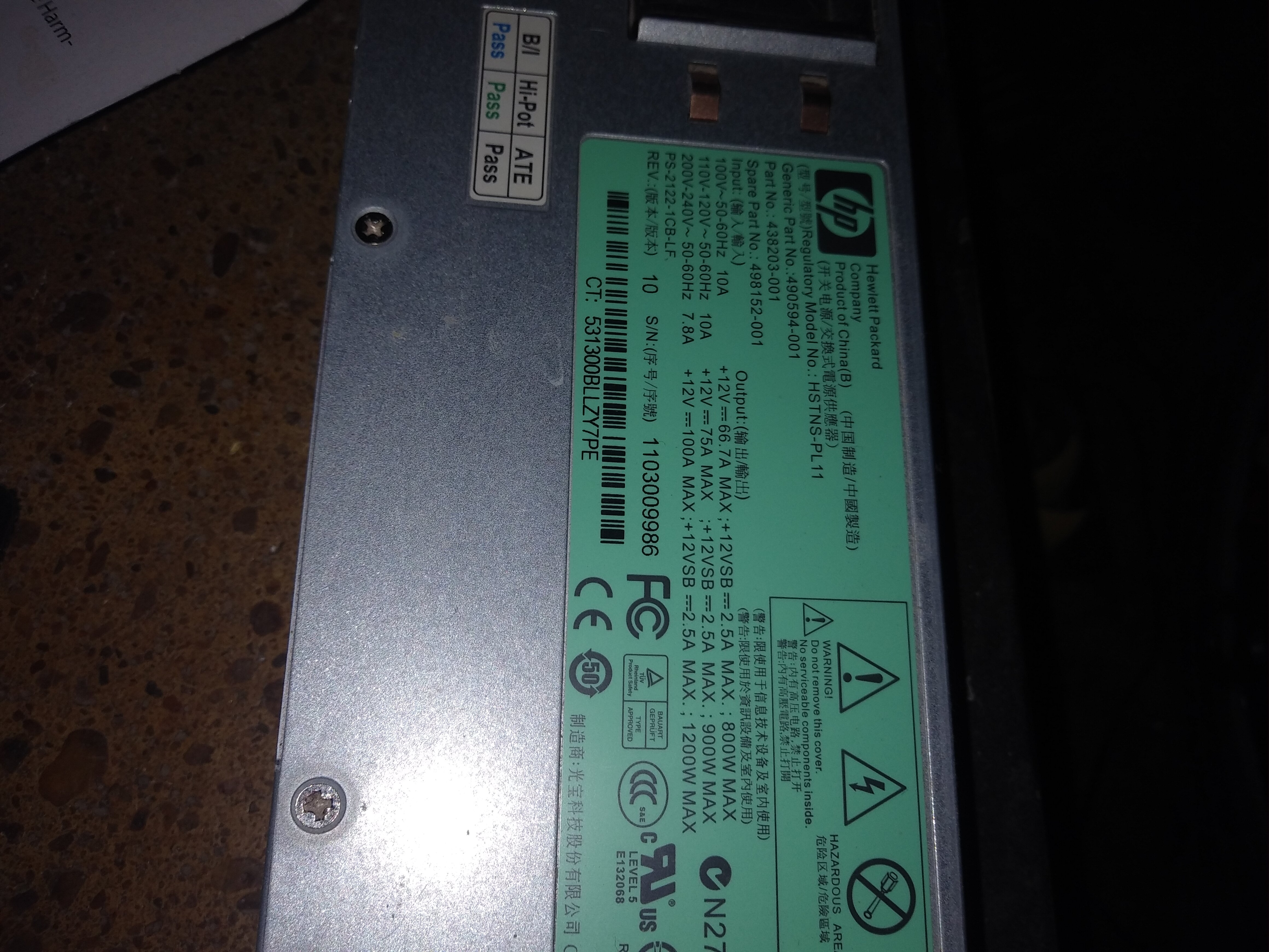

I'm happy with that. For reference it's the HP model DPS-1200FB-1 A Rev 02F (aka HSTNS-PD19)
on this side adjustment it's the 2nd screw from the right or 3rd from the left per say.
