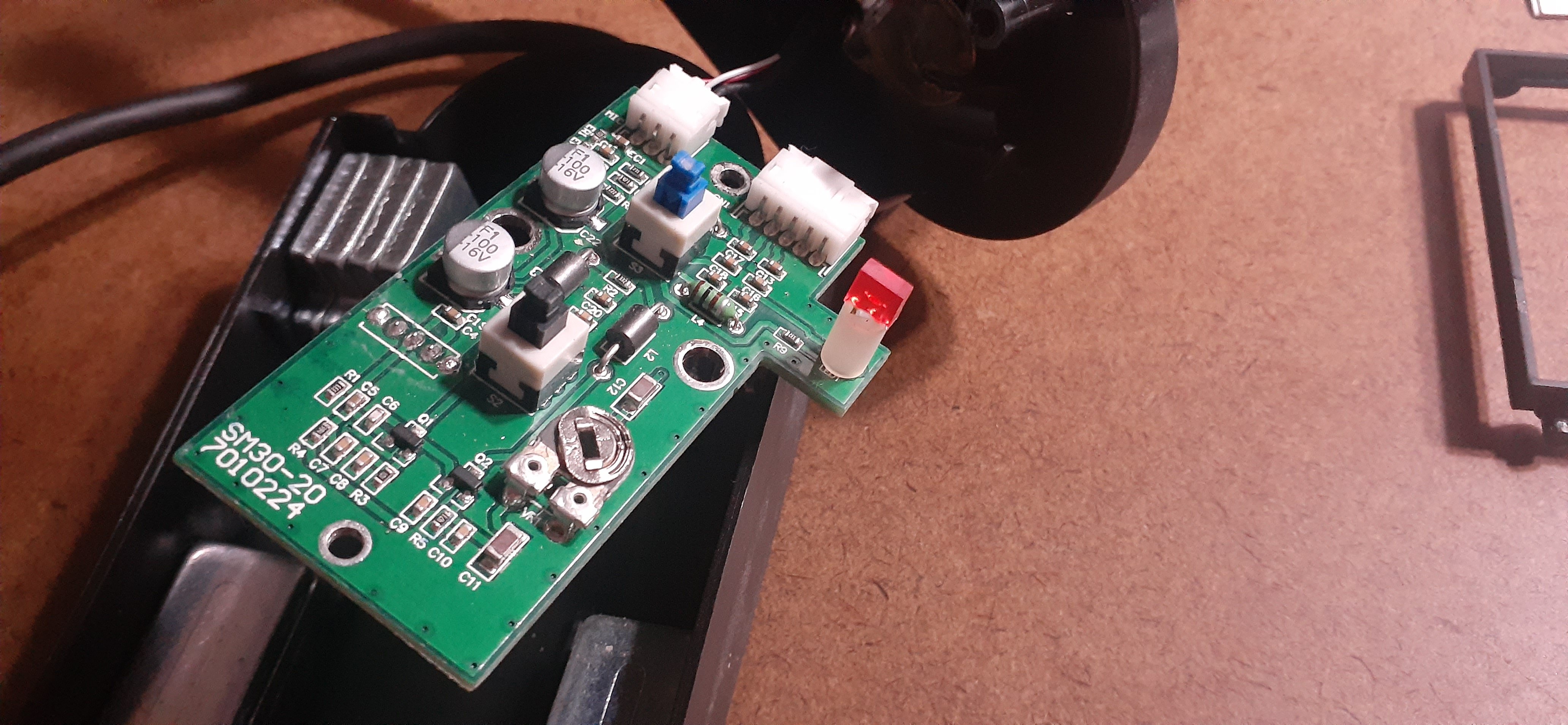

Wide open between pin 5 and pin 6. Power or mic game make no difference. The microphone works, and I'm using it. The action of the switch throw is what is causing the noise inside the radio. That noise stops when the microphone fully keyed. The point between receive and fully keyed is where the noise is. I use the lockdown key instead of the push to talk key. It's a different switch, and a shorter throw. I hope that makes sense. The blue switch is the lockdown. The black switch is the push to talk switch which seems to be the culprit. I believe it's just a bad scratchy switch.

I would look at the edges of the PTT signal at the mic cable to see if you have ringing/switching noise.
Maybe the combination of that mics Pi filter and that particular radio creates a resonance. 100uH is pretty big for what it's doing (EMI filter I assume).
Try tacking a damping resistor across that PI network inductor (L4).

I will keep that info for now in case I need to come back and test it myself. For now I'm chatting with Icom. We'll see what they've got to say first.

It wouldn't hurt to try some de oxit or contact cleaner, I've used the crc stuff from Walmart to clean ptt switches.
