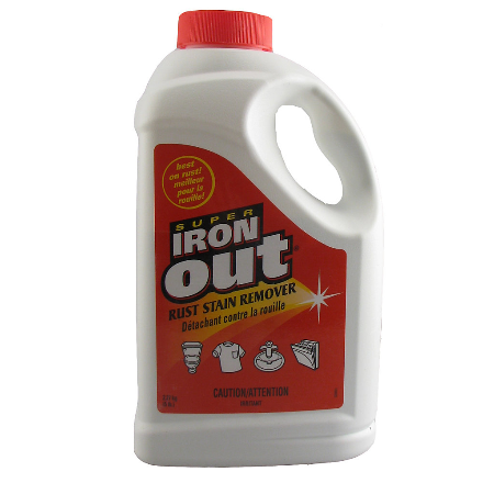

We use Iron Out which comes in a powder and is readily available at any hardware store or select grocery stores. It works MUCH better than CLR. It is what is recommended to clean out the water softeners after they get an iron build up in them. The wife will throw a little in the washer and let it do a cycle every now and then and sometimes even soaks her uniforms in a solution of water and Iron Out to restore the whites. She is a nurse so HAS to wear white tops. Don't use it in hot water however as the fumes can be rather strong but cool or tepid water is fine.

Capt , Thanks for that ! I use CLR . But that put a stain in my Stainless Steel Sink that won't come out . I need to look it up see if it's available near by or I have to order it . Ps , Never saw that in the local stores here in RI .:) Come in handy I have well water .

Thanks for that information. Even if I have to order it. We have limited retailers in Porta Lavaca, Walmart, HEB (grocery store), and Ace Hardware (high dollar for anything). May have something up in Victoria. Doubt it.
My FRC work clothes are rusty color. Have brand new FRC blue and white shirts I don't wear because of junk in wash water.
You can get it on Amazon if that is an option for you.

I've been funneling in some Iron out, cleans my filters right out. Captain Kilowatt's the guy who turned me onto that stuff.(y) Sure it is probably composed of limestone, once in the system I run a little water to get it down the line. Let sit, run it some more, let sit. Just enough to move it along at intervals. Iron oxide drops right out, but have the H2S, sulfur smell like rotten eggs. Day or so all gone. Really works on my softener, some kind of silicate gel stuff. Water here is really hard, above 450 in hardness test.
