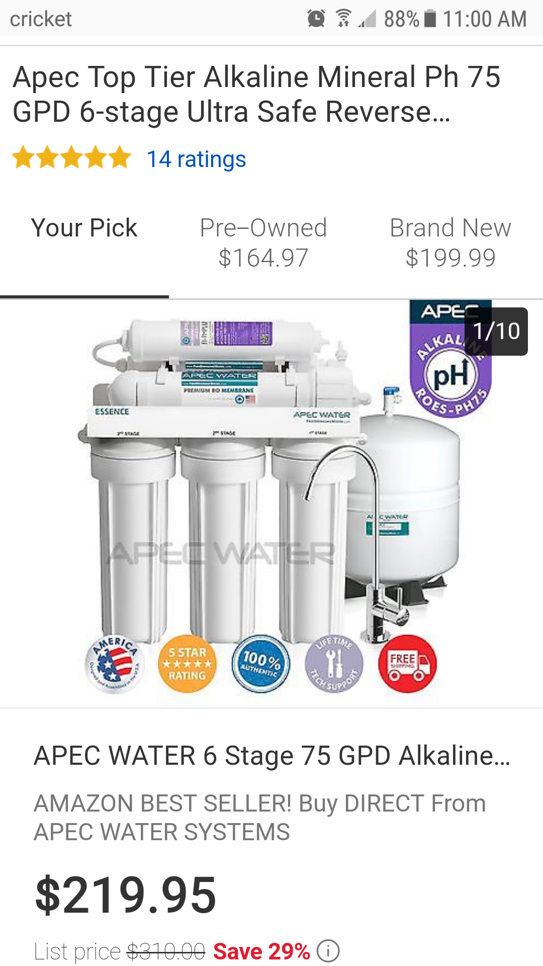

Best bang for the buck installed in an RV.
The water is so filthy in Las Cruces NM that filters clog within 20 gallons of water.

Rabbi,
Does that filter whole Rv system or just drinking water? Got well water here loaded with iron oxide, have 3 whole house filters and a Rv filter just before inlet. First filter is 6 micron white paper, 2 and 3 are 10 micron carbon, then the carbon Rv filter. Still get red stains in shower and toilet.
Seems that system might not have the flow needed for shower, sink, and toilet.

You are correct. Chlorine. Tried chlorine down well with a day of circulation. The water tastes terrible, but when you add chlorine, it's just terrible chlorinated water. Drink bottled H2O.
Trying to get crap filtered with out buying water softener. Not sure that would help. Thinking rusty salted water. Distilling, now I'm wandering. Reverse osmosis.......
Reactions: 357magnum
