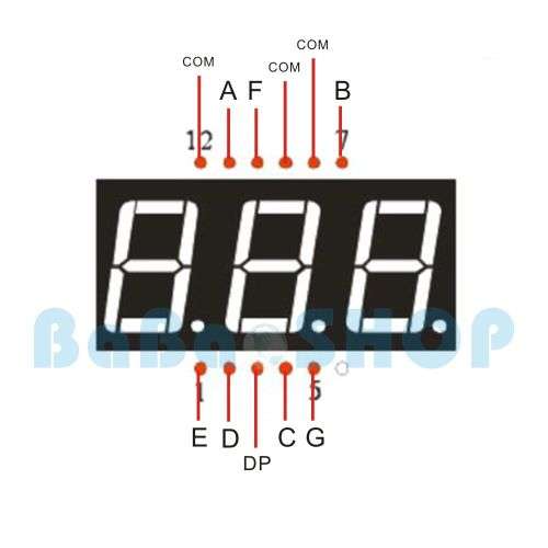

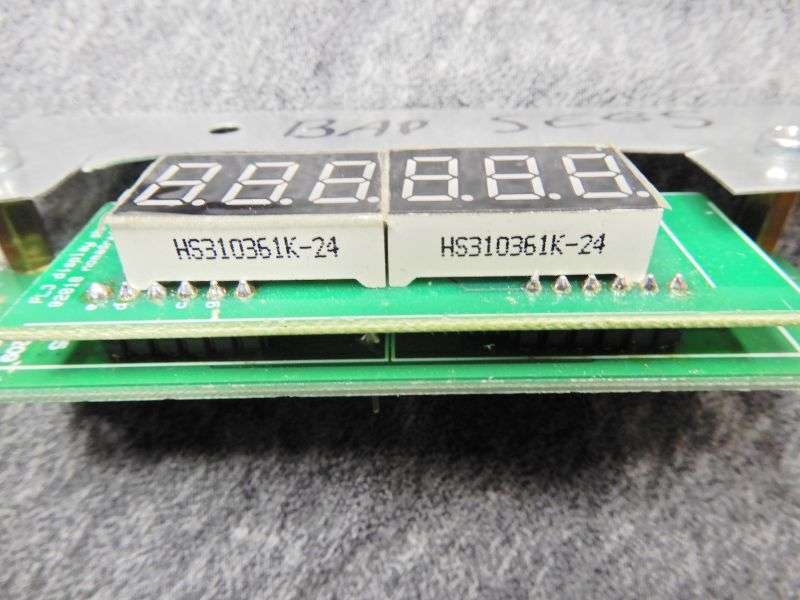

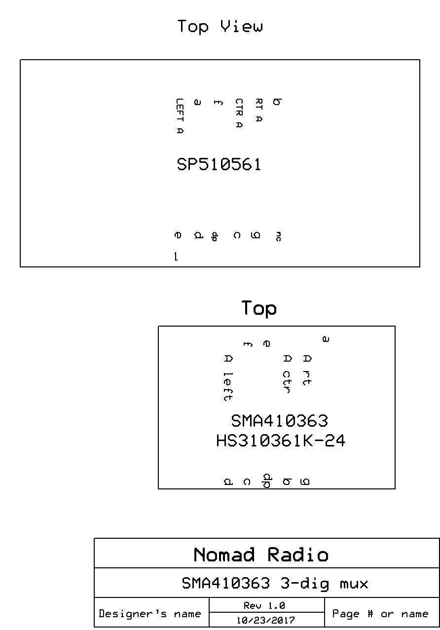

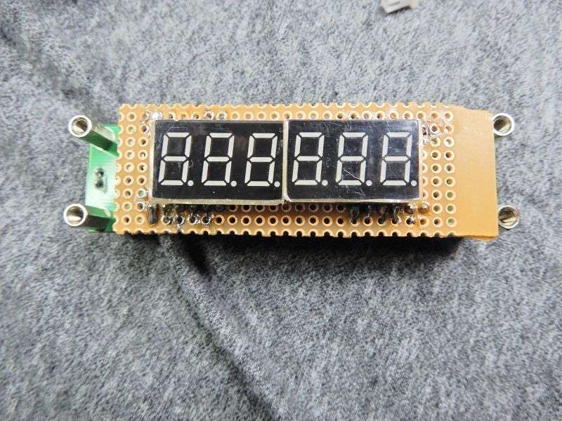

Here is a pinout we reverse-engineered with a power supply, resistors and gator leads. . This is a top-side view, not the usual bottom-side pinout you would see on a legit data sheet. The one on the top is the original three-digit 0.56-inch stick that came on the PLJ counter board. We removed them because they're too big to fit behind the window in a D201 or Siltronix VFO.

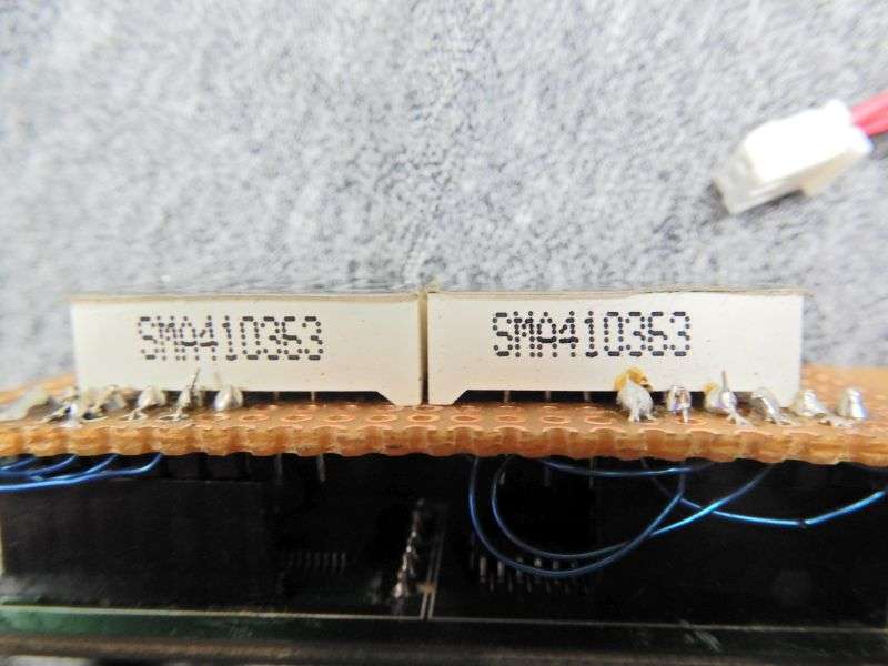

Here is the number on the zero point three-six inch digits we used for the perf-board prototype.
And this is the number on our first production batch of this trick.

My pinouts above may be wrong. I may have numbered them out of sync by one letter. The upper-right segment should be "a", the lower right "b", the bottom segment "c" and on clockwise to the top "f". Center segment is "g".
Looks like I started with the top segment as "a".
This pinout came from some long-forgotten fleabay listing I think. Probably the right one. This is a top-side view.
Probably.
