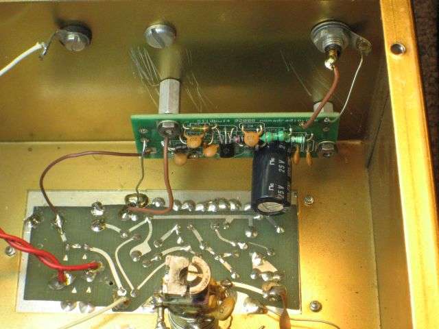

So here is a procedure for that. Our web site shows only the transmitter internal install for this board.
Here is the only pic I found quickly showing the board ready to install. Actually shows both versions. The one with the black coax soldered to it is the one that's installed inside the Mark 3 SSB transmitter.

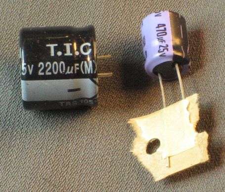

First, the two electrolytic capacitors on the board get replaced. The factory-original parts are too old to trust, so changing them is the only way to prevent wasted time later when the factory parts quit.
They're included with the board. Might not look exactly like these.

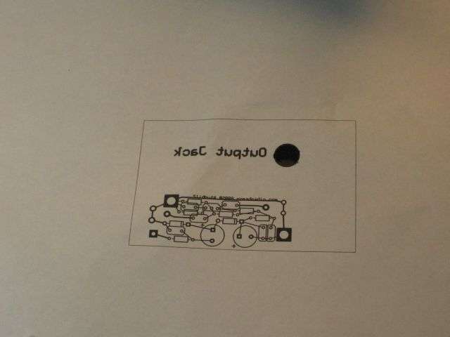

You'll need to drill two 5/32-in. holes in the rear panel. We provide a printed template. The big black dot gets cut out and slides over the RCA socket on the rear.
Weird part is that it's printed in MIRROR IMAGE on the paper.
Here's what it the back side of the paper looks like with some light on the printed side.
After carving out the hole for the RCA jack, hold the print side down against the rear panel of the VFO. Mark the two mount-screw holes with a sharpie.

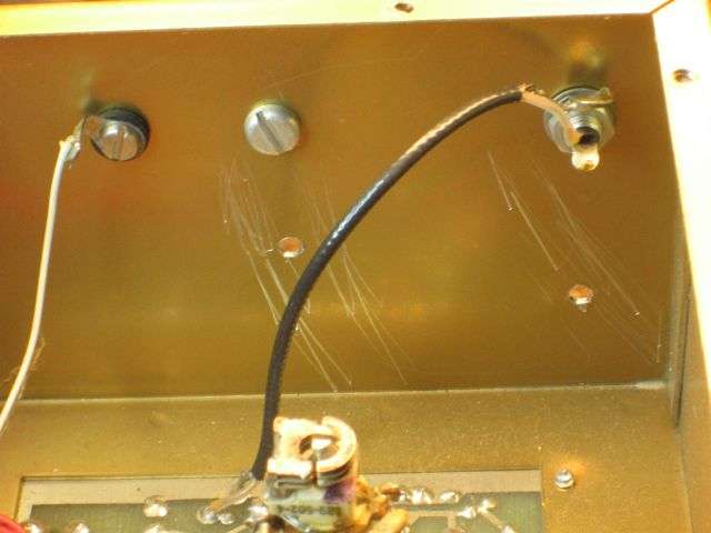

Now would be a good time to remove the skinny black coax from the RCA socket and from the circuit board. Clear the solder from the hole where the coax center conductor was removed. Remove the burrs from the inside of the holes you just drilled. A larger-size drill bit, like 3/8-inch or larger will do the job just fine, or shove the end of a flat file across them. That's where the scratches are from in this pic, pushing the flat end of a file across the holes.
The board gets bolted to the holes you drilled in the rear panel. The power wire in this pic is attached at the far left.
Here's a closer look at the input and power wires. The bare ground wire seen one at each end of the board is no longer supplied. These pics are old, and the first version included two ground wires.
You don't need them.

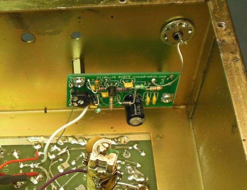

Here's a better pic, showing the level-adjust trimpot. For a tube-type radio, it gets twisted all the way to the right, full blast. That's how we ship them.
But if you decide to use it with a solid-state radio, you can turn down the drive level to prevent the VFO from overdriving the oscillator transistor.

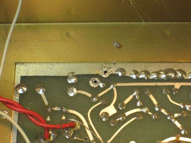

There are plenty of things that can go wrong with a VFO that's over 40 years old. The contact springs against the rear end of the main tuning capacitor's shaft are silver plated. If the tarnish builds up, the tuning can be twitchy and erratic, jumping when you barely touch the big knob in front. The switch behind the left-hand knob on the model 90 will cause the frequency to be erratic when it needs to be cleaned.
We routinely add a ground wire from the ground lug on the big ceramic pillar to the circuit-board foil.
Tightening the mount screw on that pillar is a good idea too, but a good ground on that coil improves stability.
The ground lug bolted directly under it needs a direct wire connection to the circuit-board ground foil.
