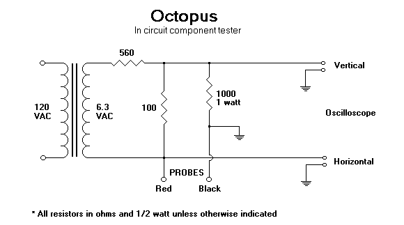

Here's a little more on the subject...
But they seem to call it an Octopus.
Uses low voltage AC thru a divider "bridge" setup - with the unknown part as one of the elements of that bridge to develop a Current and Voltage - curve trace of that part. Gives you those similar designs as "templates" whatever doesn't fit any of those templates is what is considered a "fail" and try another - type of result.
