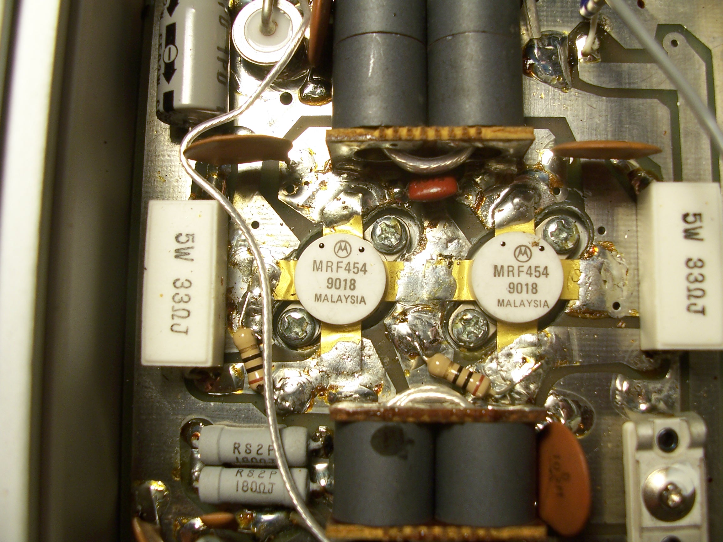

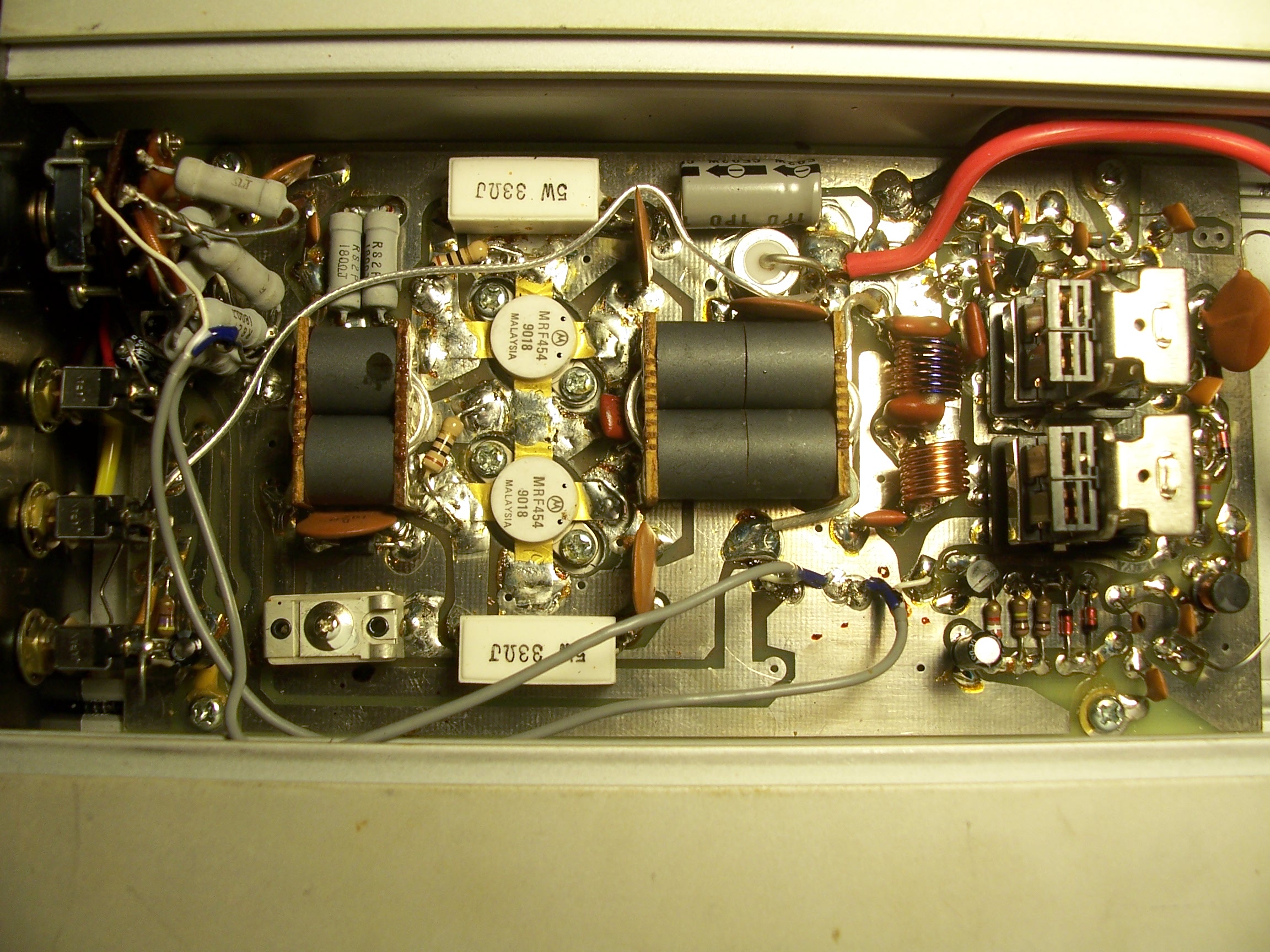

The resistors are old, but I have seen this neg feedback before, they can be found more in older amps, like these pictured here.

close tolerance resistors.
