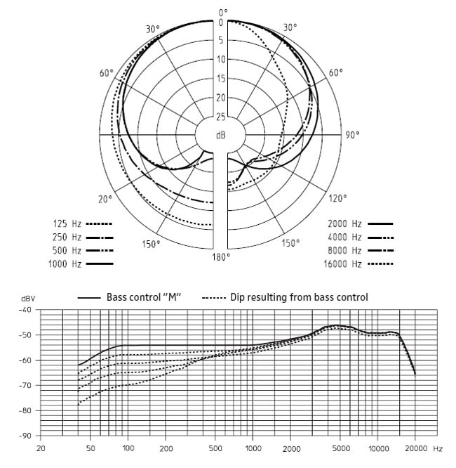

Although it is currently not hooked up, I have been told many times that my old Heath DX-60B transmitter which is quite wide, sounds superb with my Seinheisser MD-421 microphone. I was given the mic many years ago after it fell off stage and no longer worked. All it was was a broken wire inside. The MD-421 has a five position rotary switch on the end by the XLR connector that selects the degree of bass roll-off. It works great for either punching thru the noise or for nice wideband rag chewing. I increased the series pass capacitors values in the modulator stage and that was it other than the microphone. I hope to hook it all back up again in time for this winter.
MD-421 frequency response showing the five different roll-off settings.

First off the word is "cardioid" not "carloid" and I can see no reason why anyone would want an omnidirectional microphone for communications use. Sound quality and frequency response are what counts and that can be the same with either an omnidirectional microphone or a cardioid microphone. I want my voice to be heard not the fan in my amp or the television in the living room or the microwave running in the kitchen or the washer running in the porch. This is the polar plot of the Seinheisser MD-421 as well as the frequency response. The plot is symetrical down the middle. It just looks odd because of the bass notes being depicted on the left while the highs are on the right.
