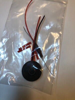

Quick question. The caps on my amplifier board in my Turner plus 3 have the positives marked. I noticed just about everything in recent times the negative is marked. Now, the new ones I just received have a zero on them out of the picture attached, is that marking negative or positive?
That's a negative
Reactions: Greg T
Quick update, I got the caps in and the tone was still muffled with no presence whatsoever. So I swapped out the element with a parts Plus three I had here and now it works, and is crispy, but when I key up it has a roar noise in the background. Chineseium caps or something else? I know one element is dynamic and the other is ceramic, but why the roaring noise?
