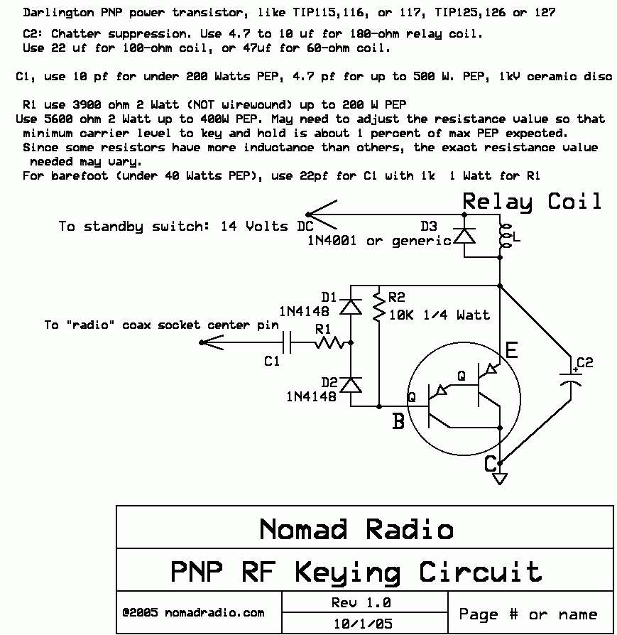

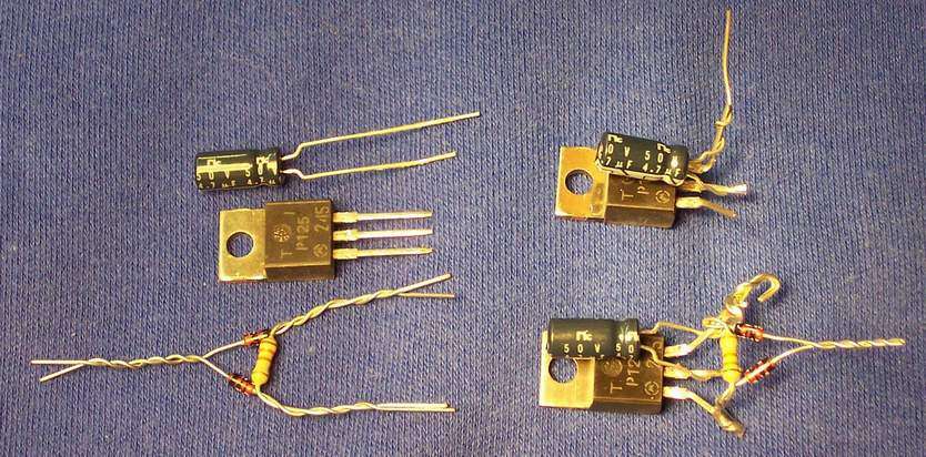

Here's a shot of the assembly procedure for the circuit we use. Got tired of hand-building them like this, so we build it on a tiny circuit board now.
Here's a crude schematic of it. The CAD I used did not have a symbol for a darlington transistor, so I made one.
Sorta.
The metal tab of the TIP125, 126 or 127 transistor is simply bolted to ground. A wire goes from the emitter lead to the 'cold' side of the relay coil, opposite the side of the relay coil that goes to the standby switch. The emitter is the one with the hook on the end in the final assembly step seen above.
Never could figure out how to make a buck selling this thing for less than 30 bucks. Considering the low cost of the parts, should be no big deal to build.
Just make sure that you DO have power to the relay coil. Could be that you broke a foil on the power-supply board when replacing filter caps.

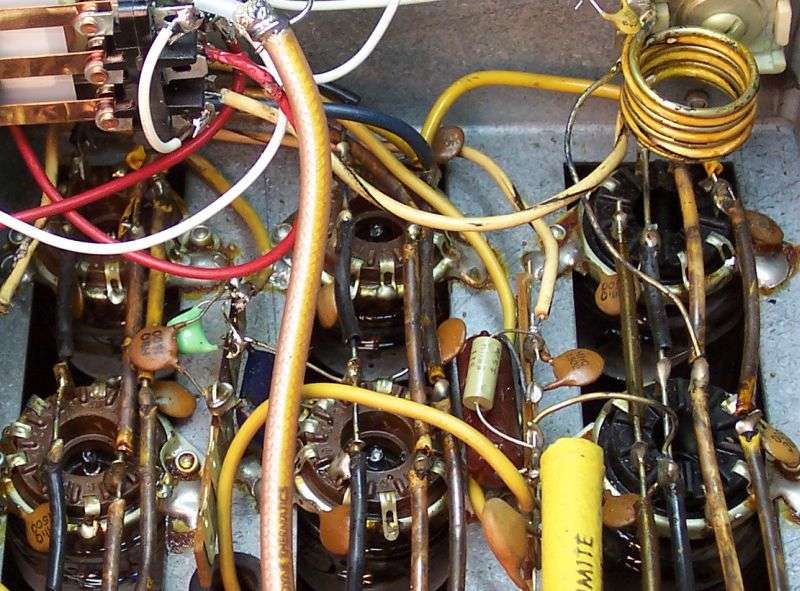

After a moment's thought, it penetrated that you probably have the newer version, with all the tube sockets mounted on a big pc board.
Only pic I have showing grid chokes is from the original version, with the tube sockets mounted to the chassis deck, and wired point-to-point. The driver choke is the gray tubular part just to the left of the middle driver-tube socket. The final-side grid choke looks different, lighter green It's been replaced with a substitute.
To find the grid chokes on the top side of the pc board, find a foil trace that joins together pin 2 on each driver-tube socket. Might also have pin 8 connected to pin 2. They will lead to a tiny axial-lead RF choke like the gray one to the left of the middle driver-tube socket, just above the yellow Z-28 choke.
The final grid choke will have one end connected to a trace that ties together pins 5 and 9 of each final-tube socket.
Haven't found a pic of that.
Damage from a tube surge may be visible, may not. Only way to be sure is either measure the inductance, or substitute one that you know is good. If there is no change, that wasn't it.
The grid choke on the final tubes fails more often than the one on the driver tubes.
