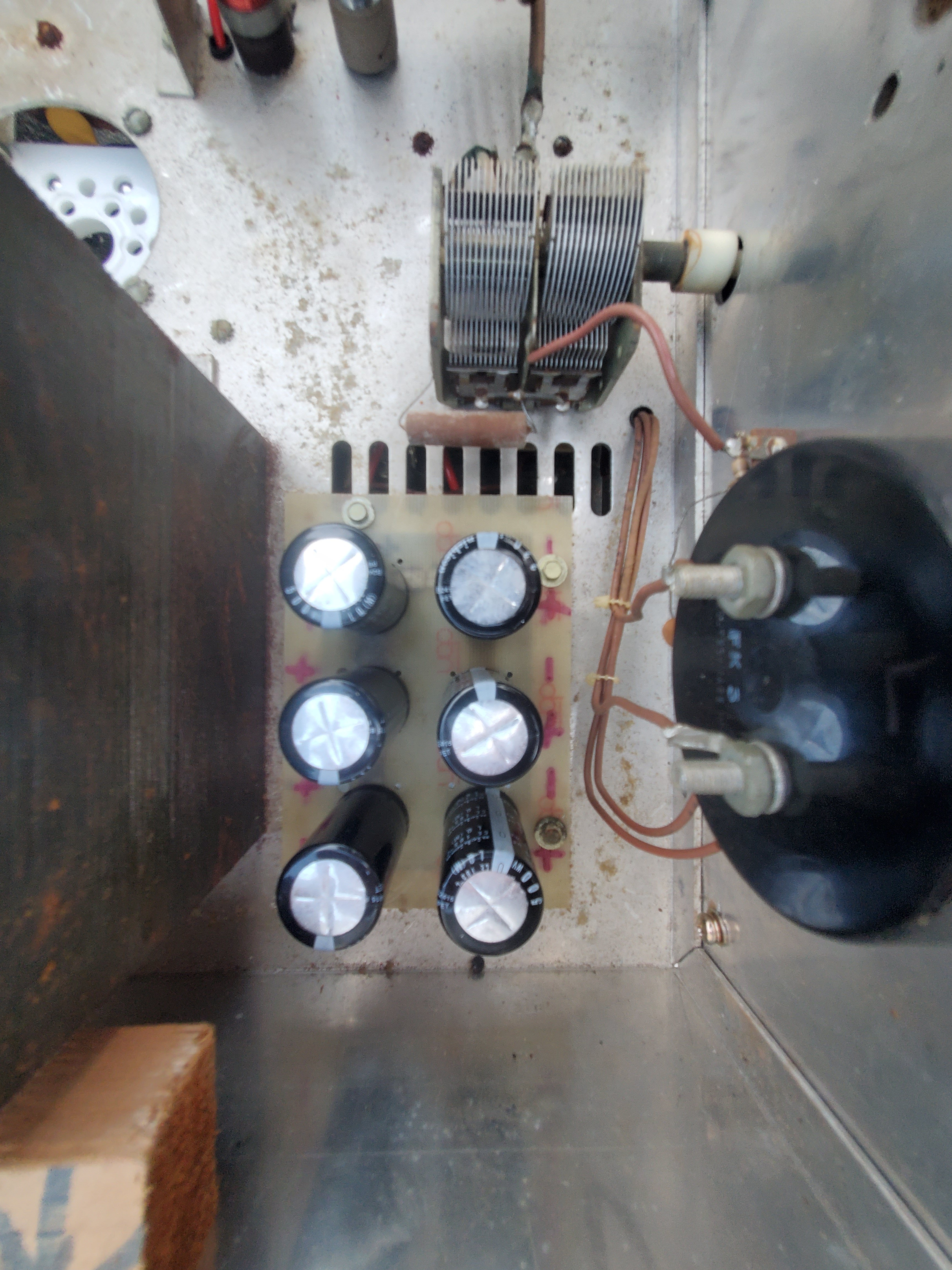

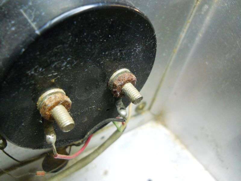

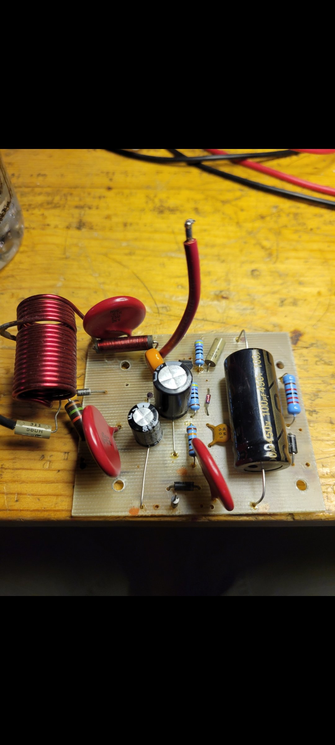

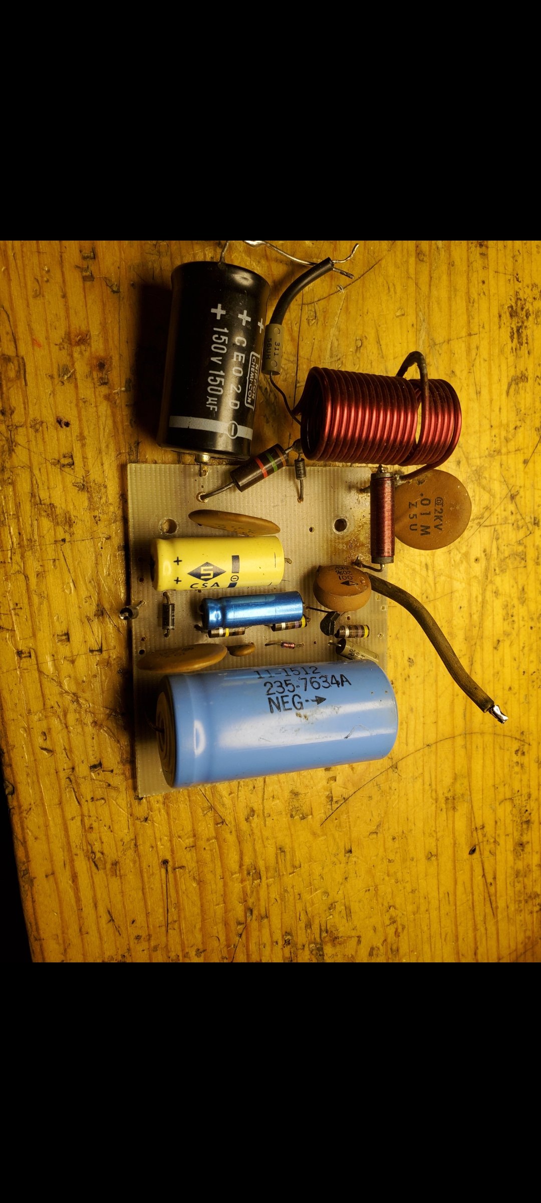

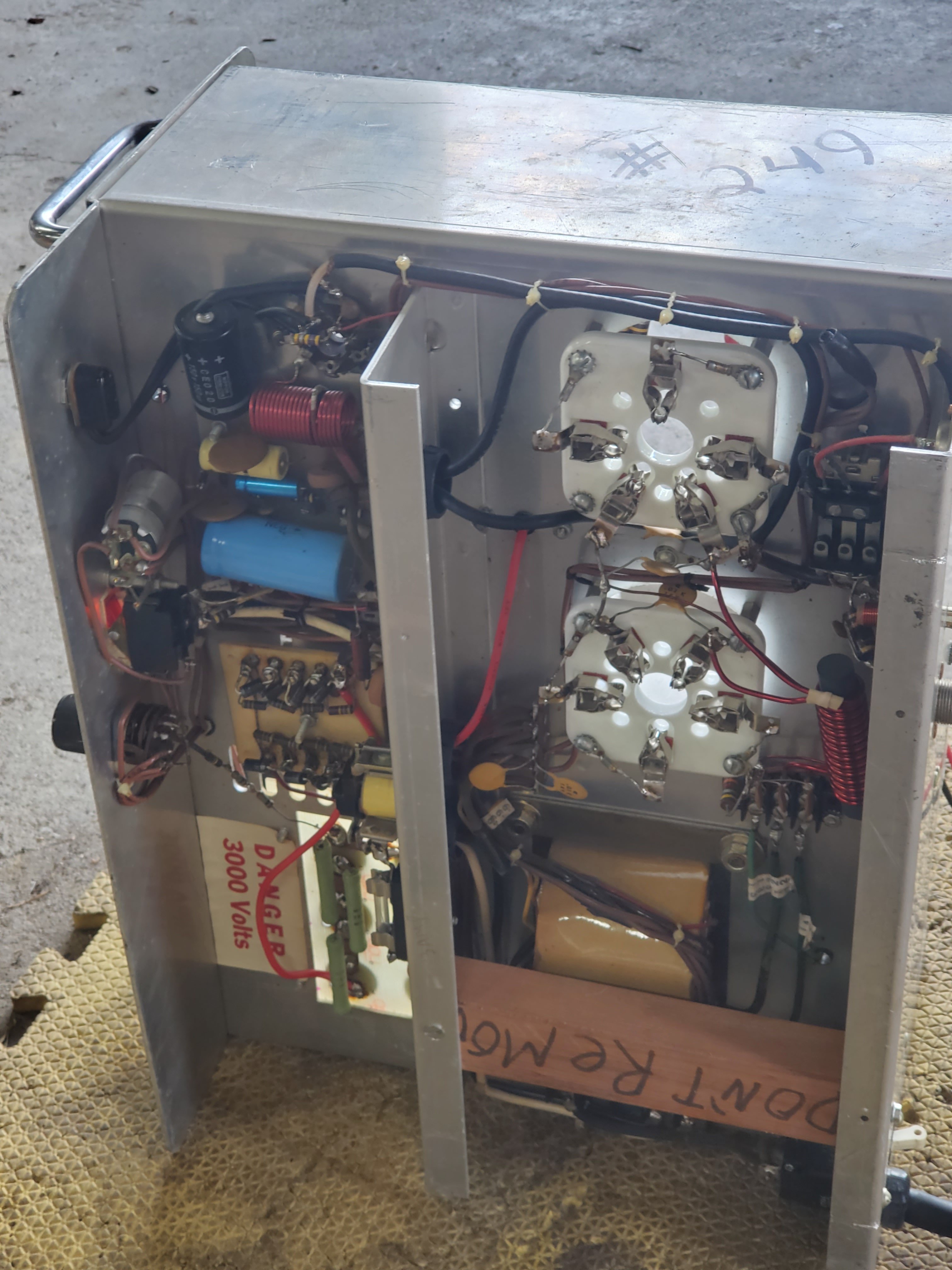

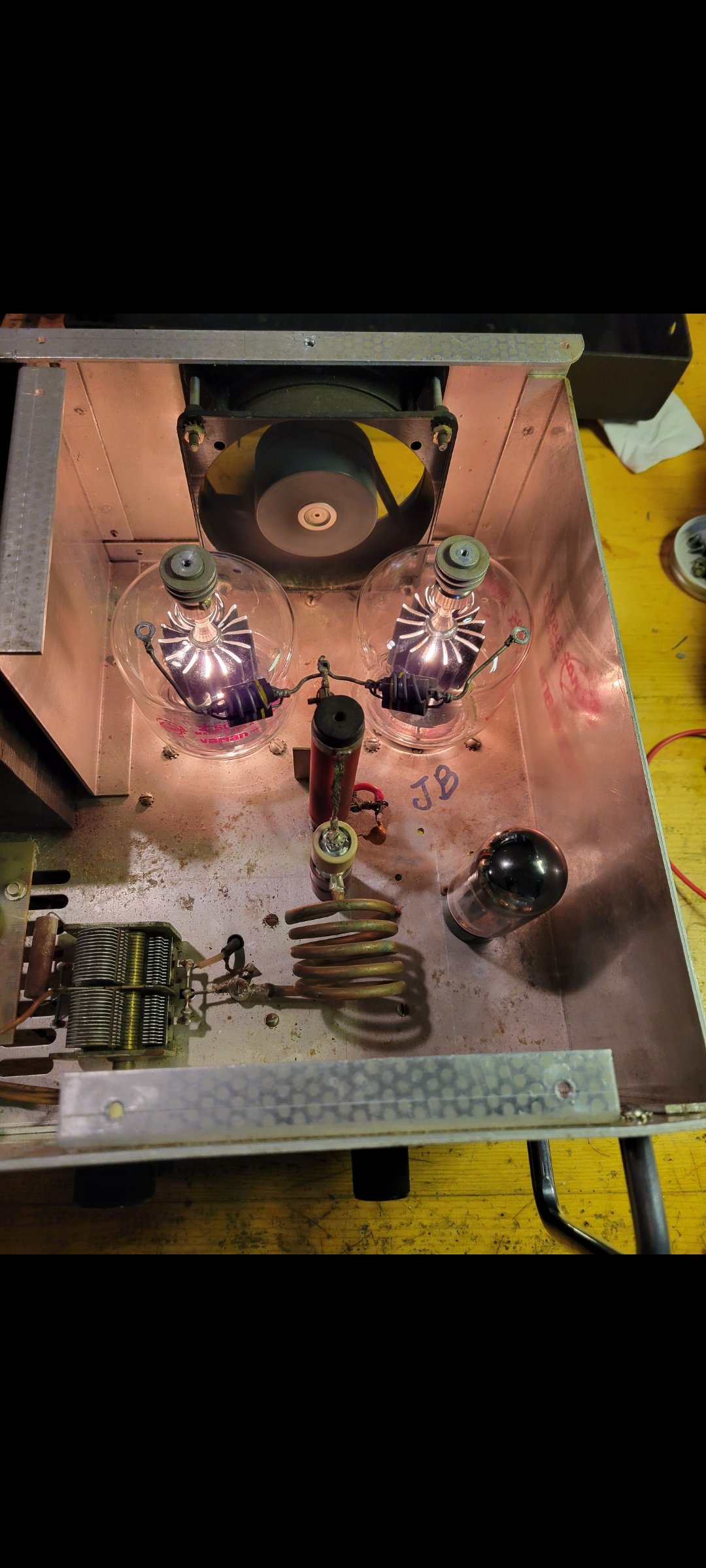

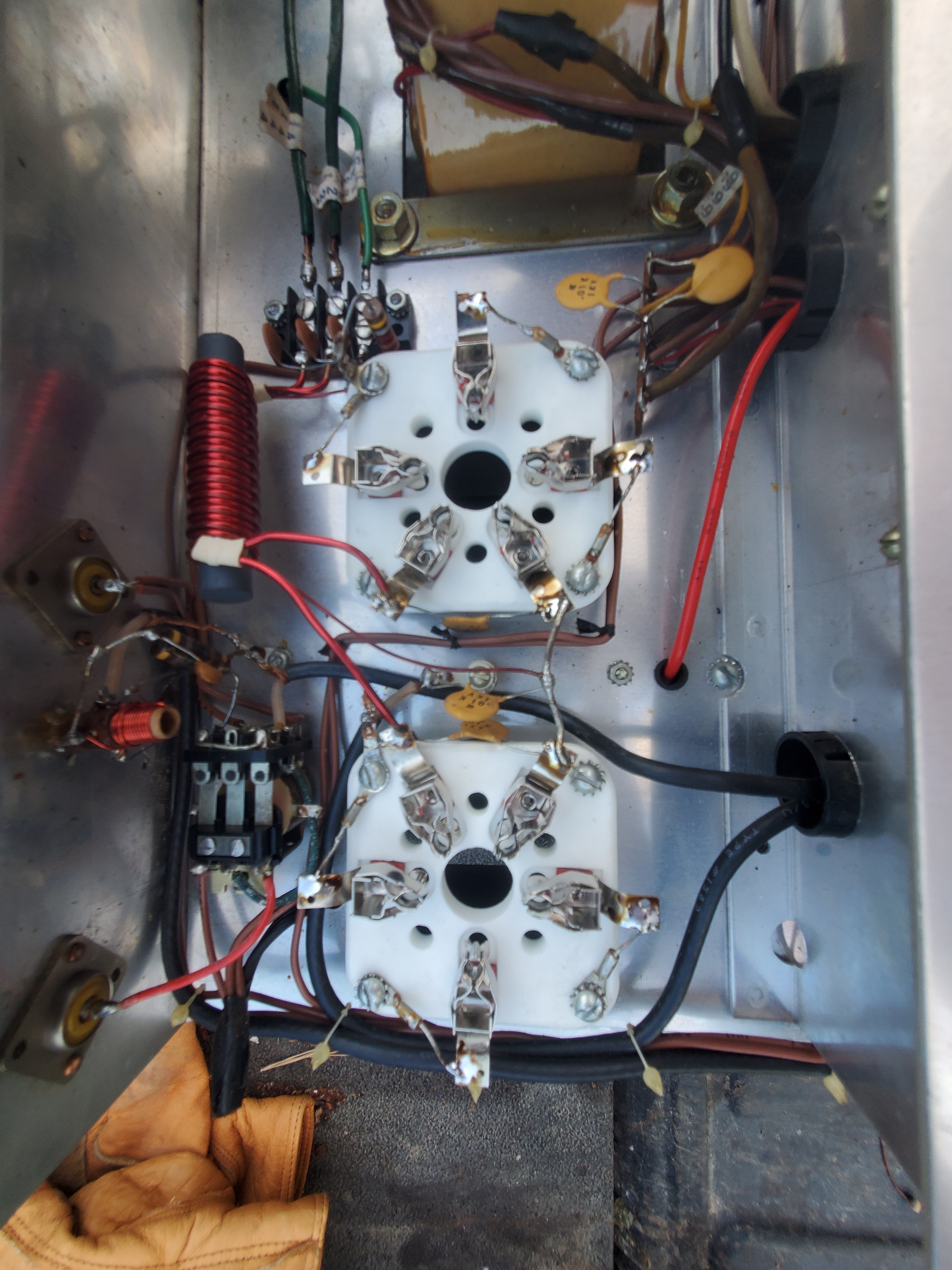

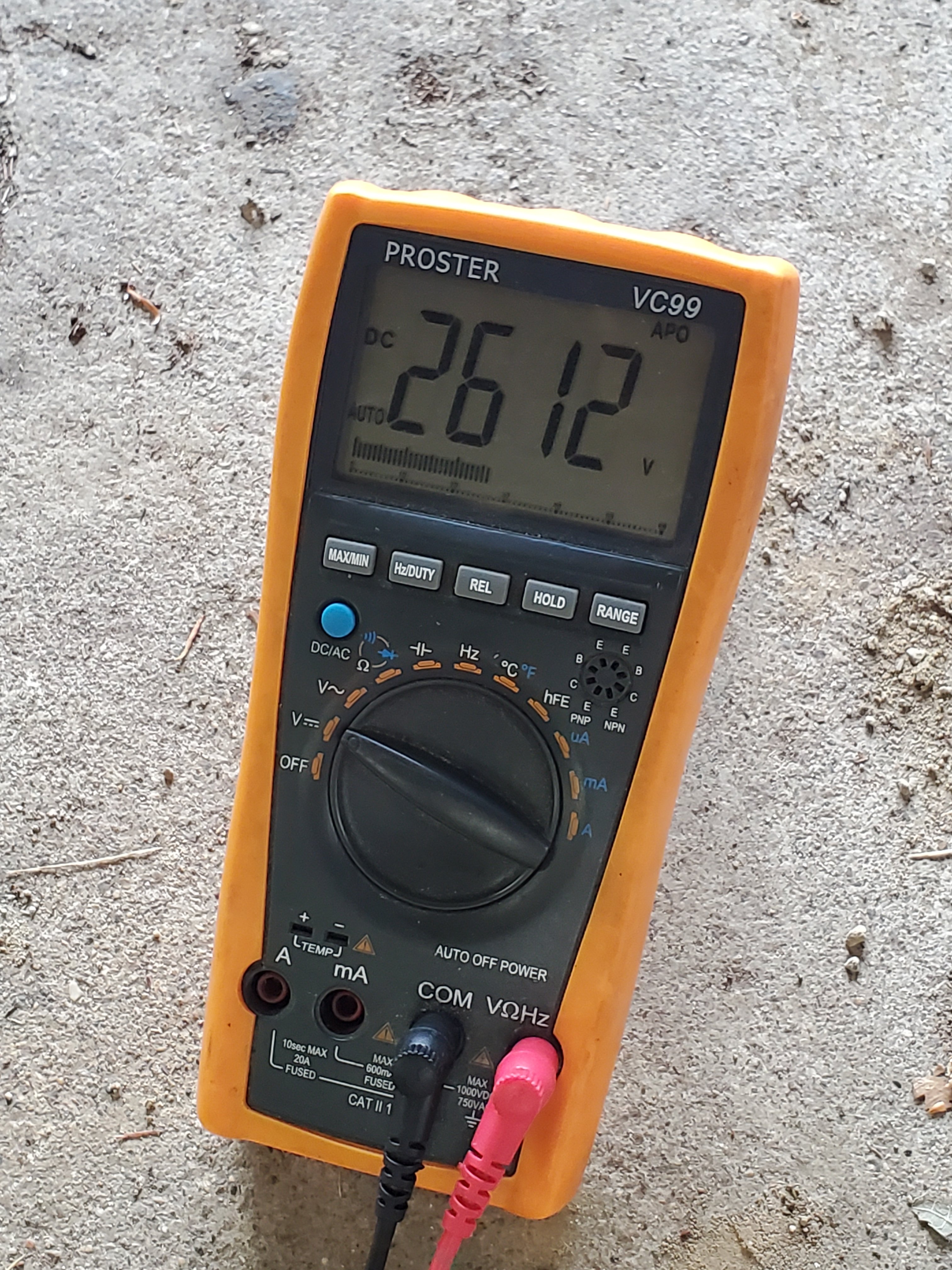

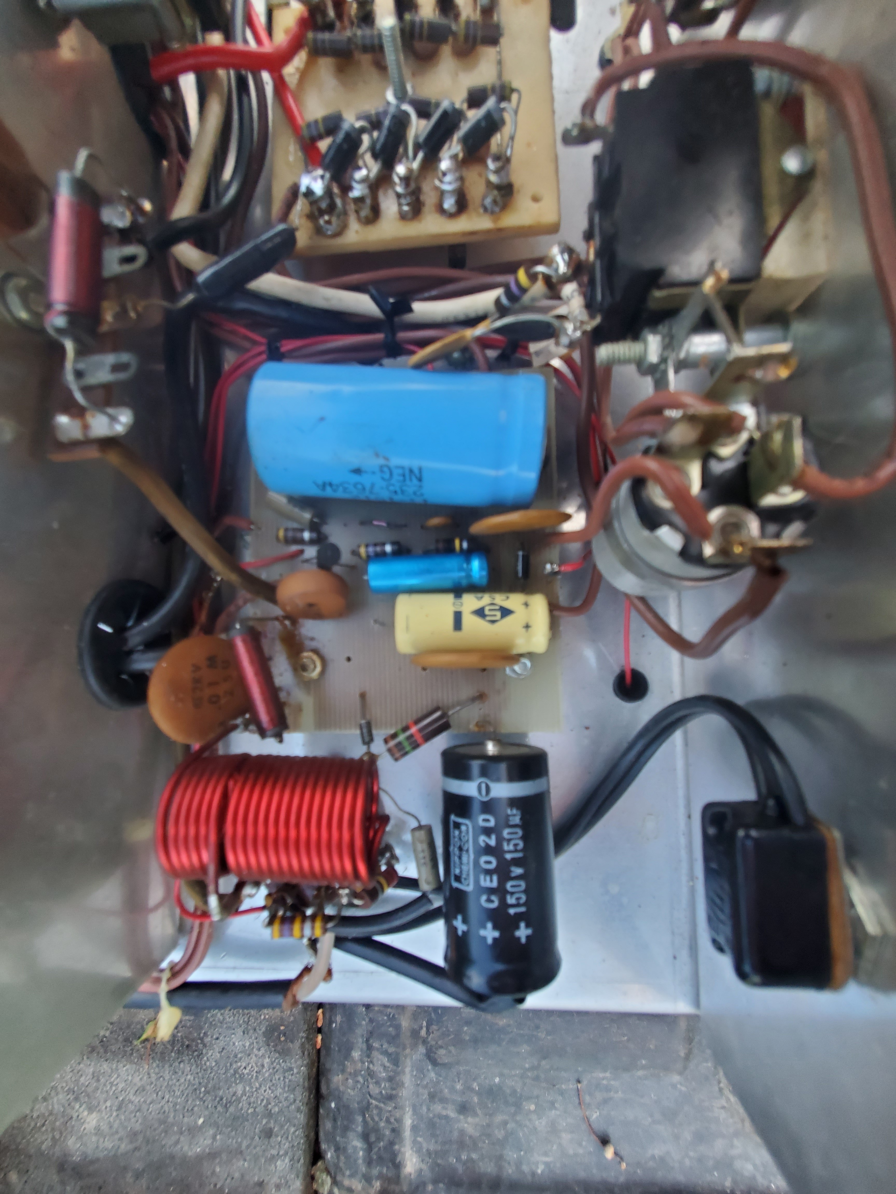

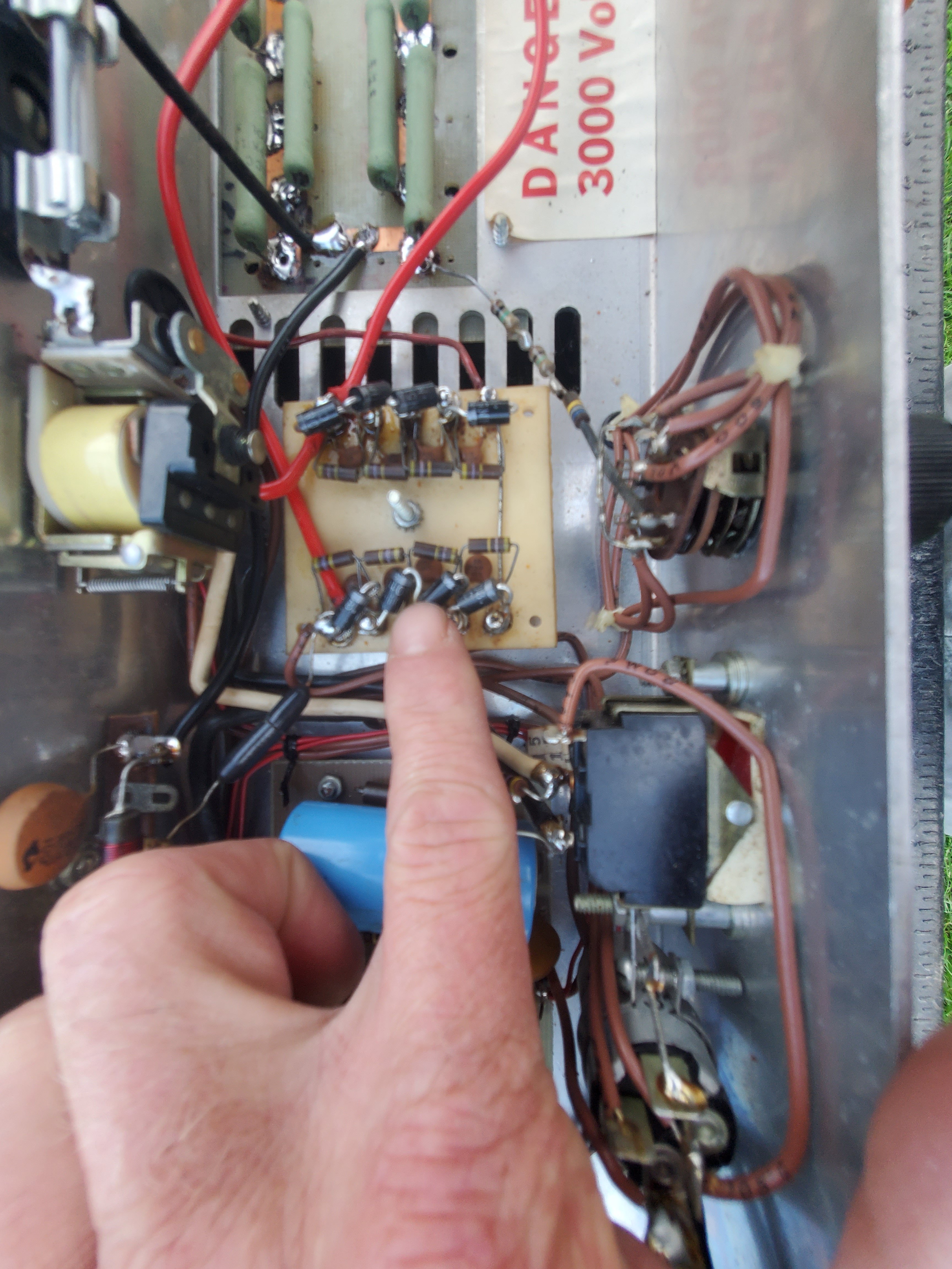

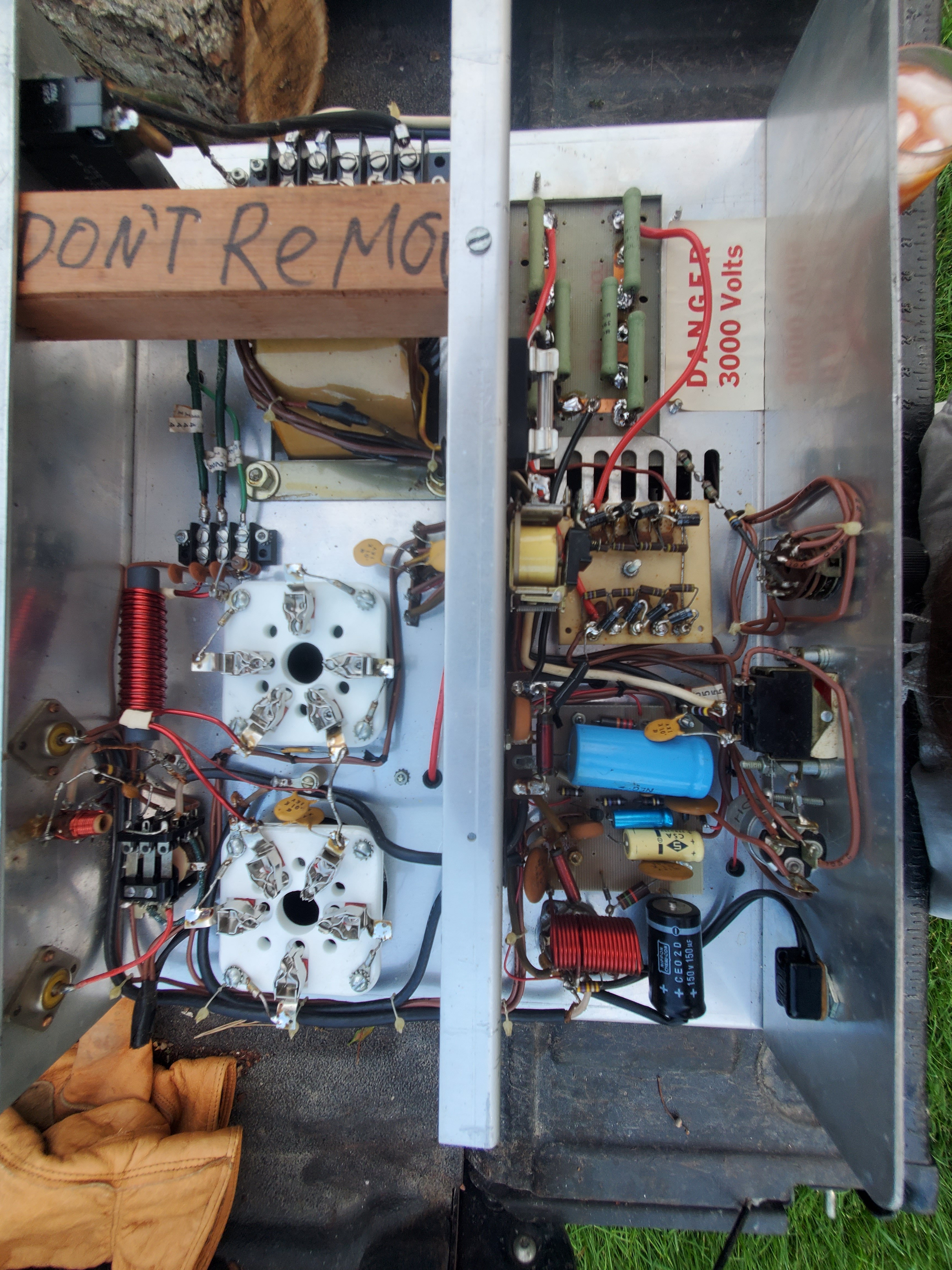

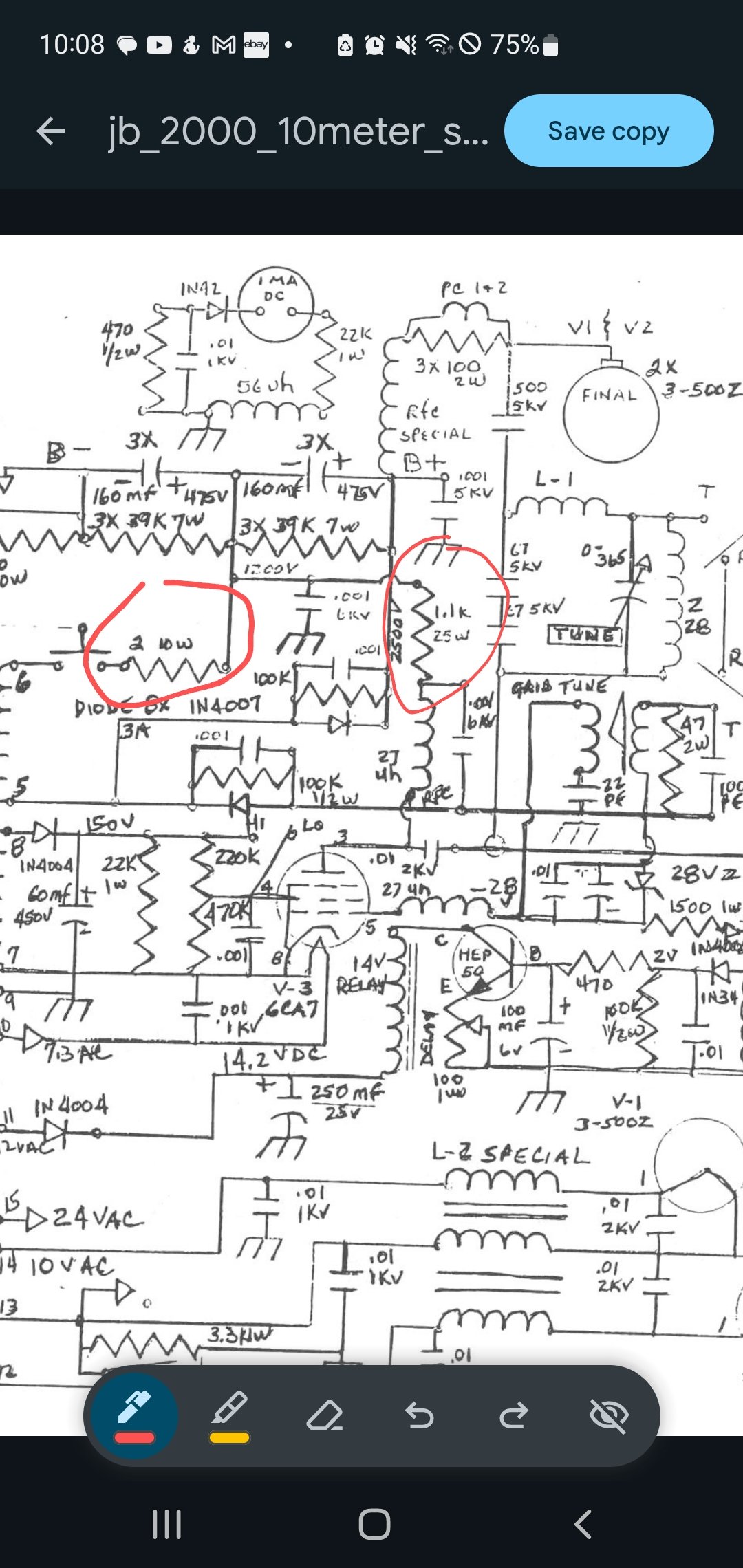

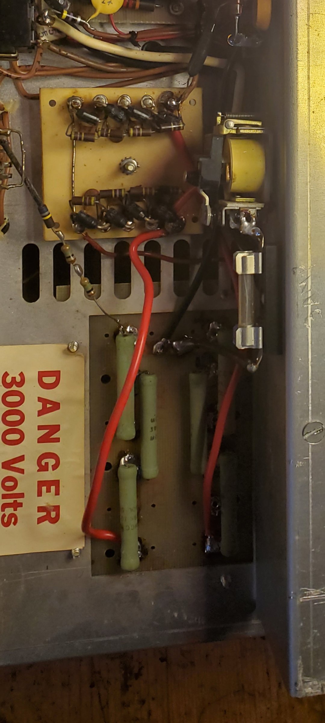

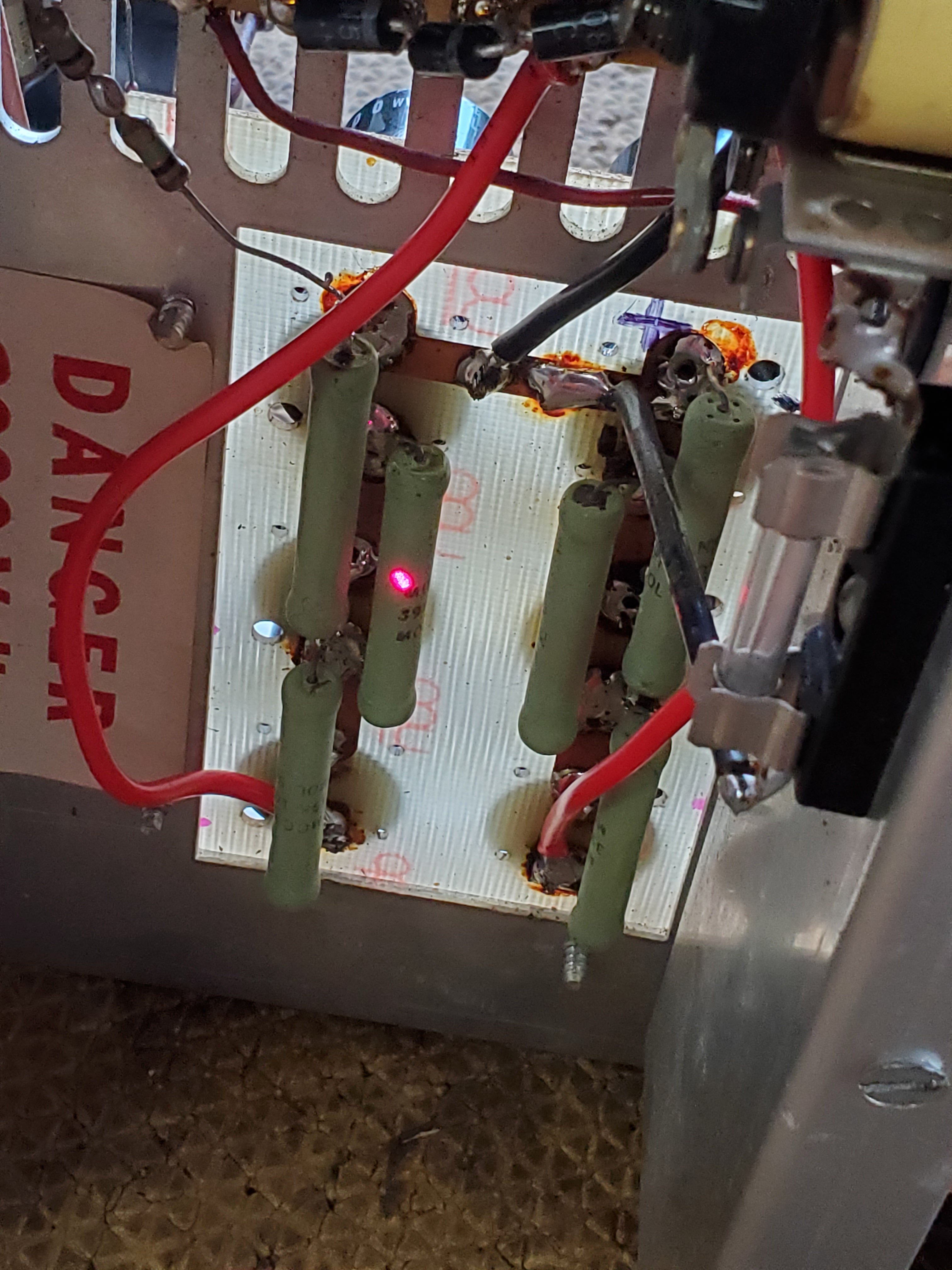

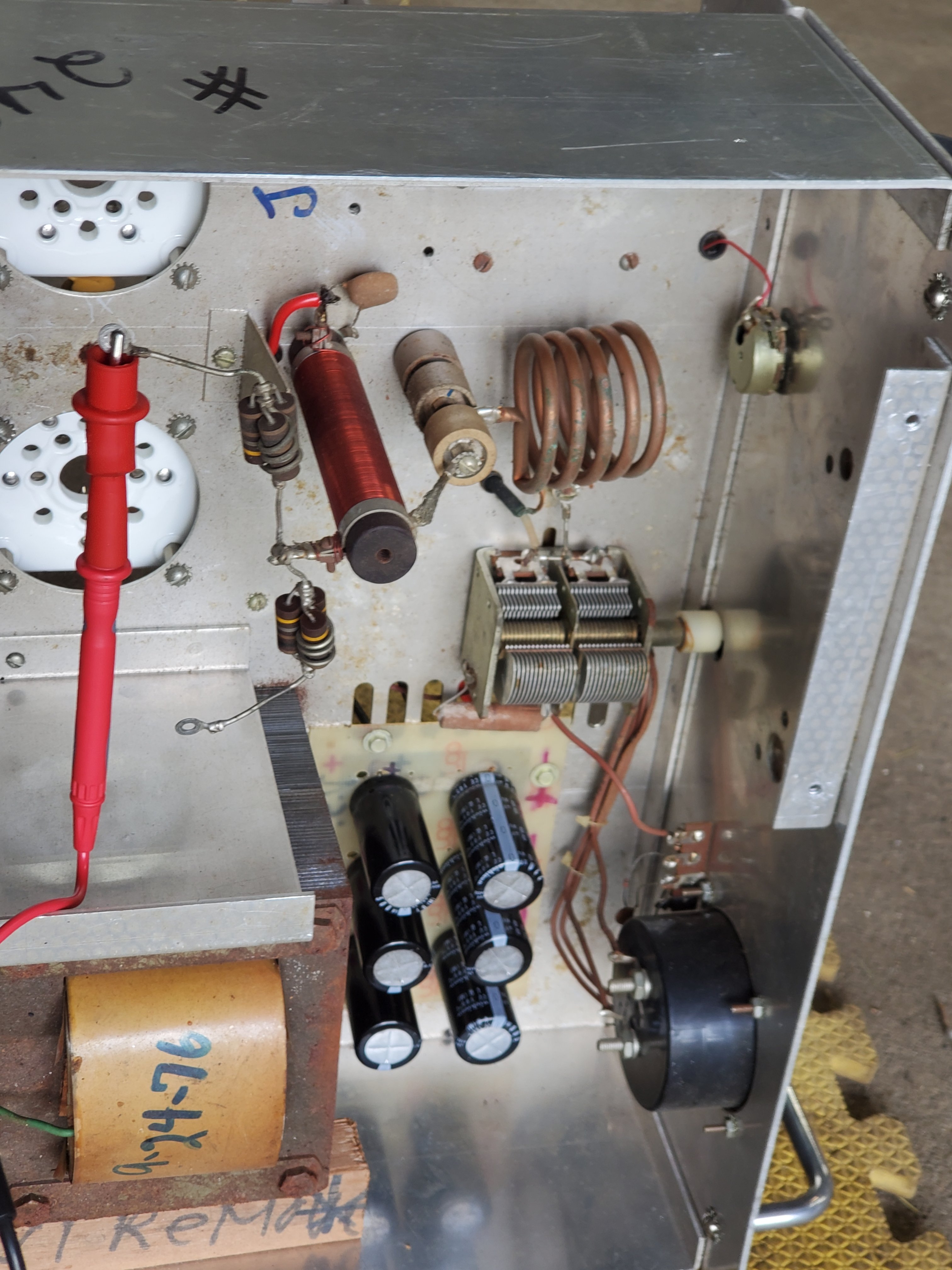

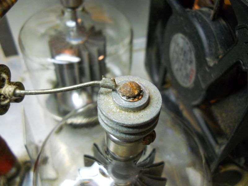

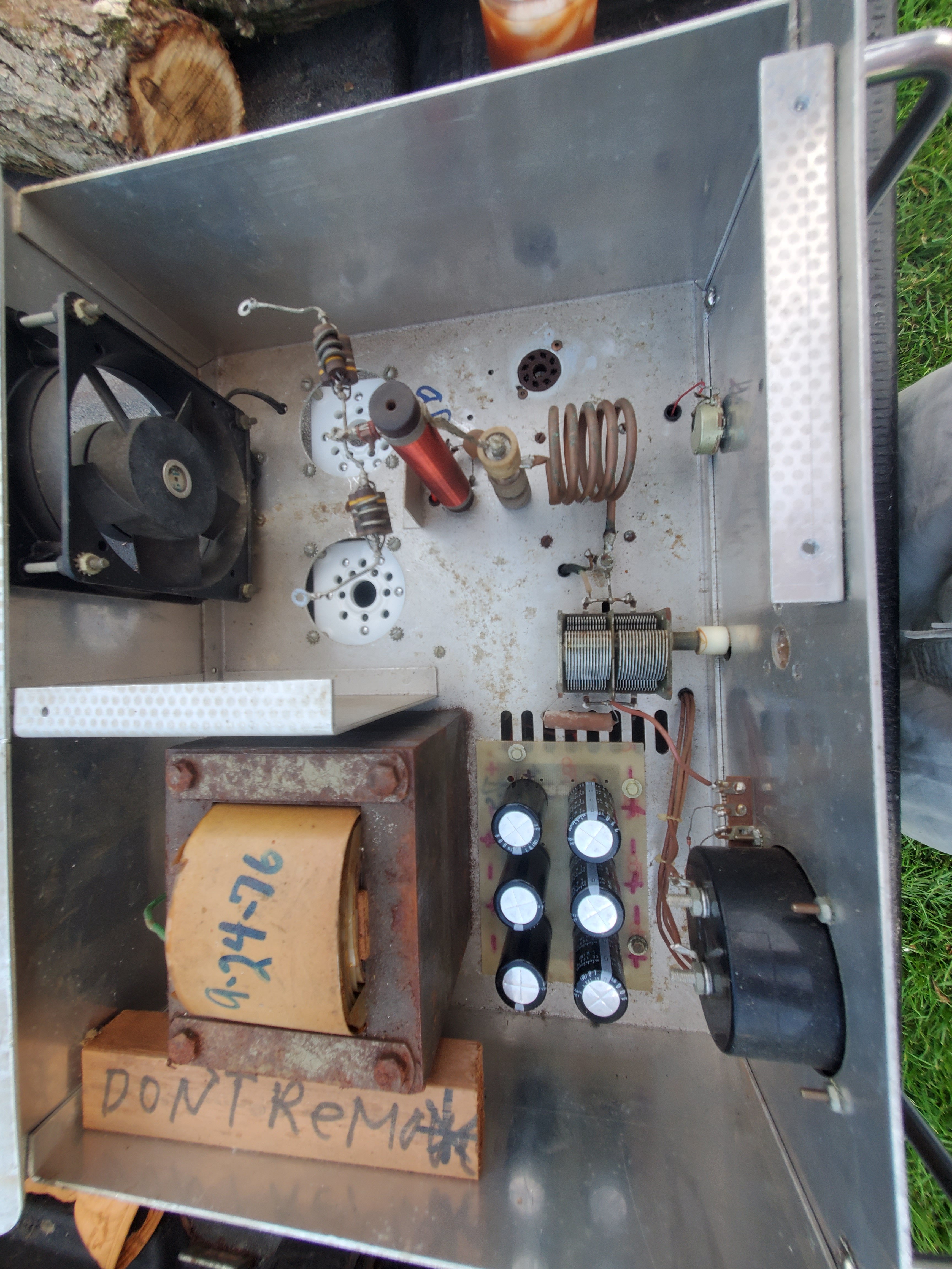

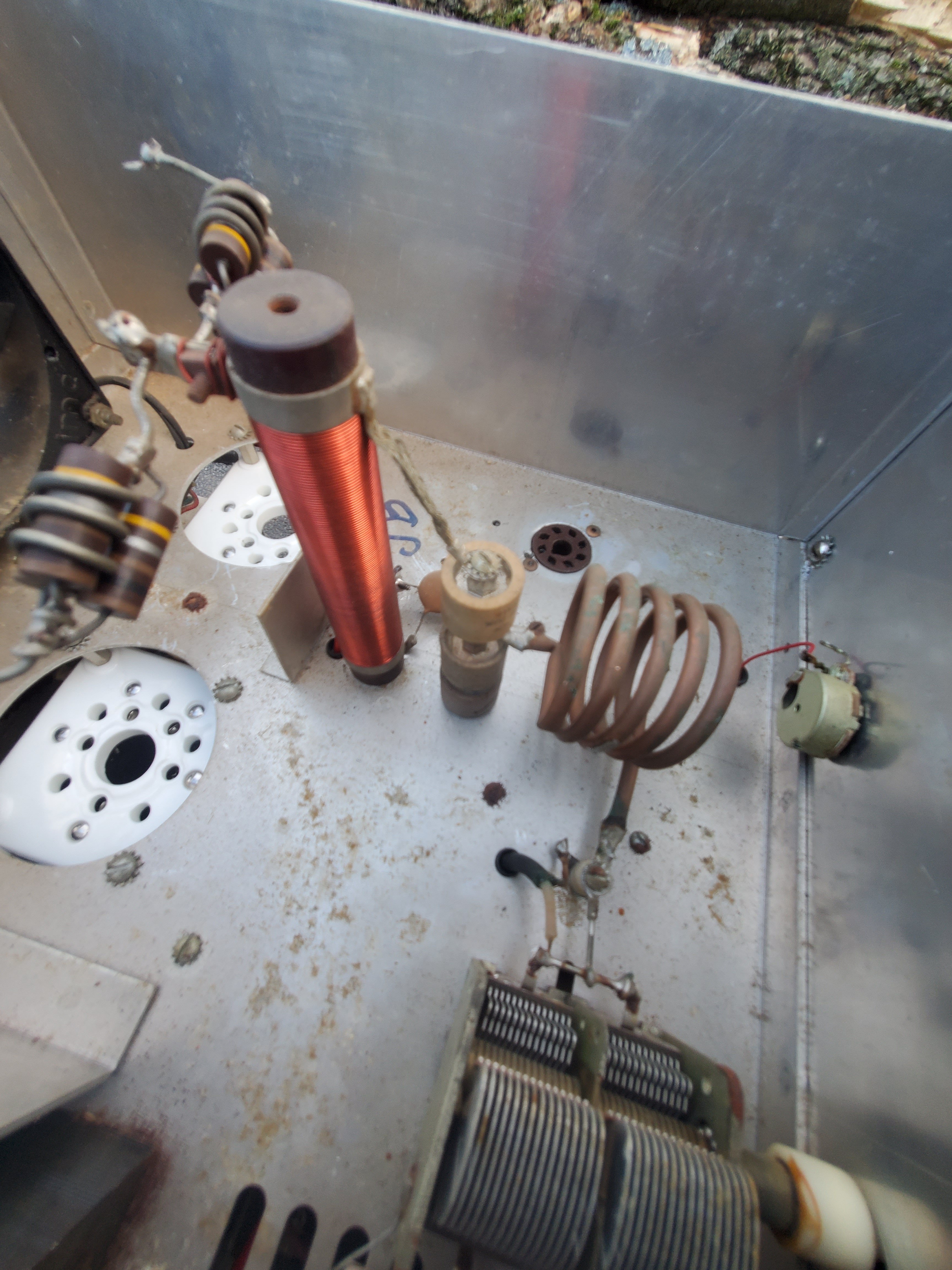

Hi all, I recently got ahold of this old JB 2000 and I am attempting to get er going and am having issues with it. Things I have replaced on it so far are HV caps, 3-500z tube sockets, and all the rectifier diodes. When I replaced the diodes all 4 on the side my finger is pointed at were all shorted, the other 4 tested good so I am guessing my problem is on this side ? I powered it up last night with no tubes installed, the HV delay clicked in fine and had over 2000 vdc to the plate section, but somthing just didn't seem right and seems I am smelling somthing hot but it is hard to tell with the fan running but I know some of the 39k 5 watt bleeder resistors are getting upwards of 200 degrees f. However it seemed ok then I heard a snap sound so I shut it down and knew it wasn't fixed and somthing else was up, so I let it bleed down and looked it all over and saw absolutely nothing. This unit still has the driver and I am kinda suspecting this board to be the possible suspect, the keying / driver board ? It has some old caps on this board but no continuity across the caps and my cheap 2 in one scope tester sees them as capacitors. The unit hasn't popped the 3amp fuse coming from the HV relay and it hasn't popped the breaker on the rear of the amp either. But somthing is popping, what about those door knob caps on the cap choke area ? The rear of the case says 10-80 but I haven't seen one like this so I am not sure that's the original cabinet and not sure the transformer is original either. Any info or recommendations would be greatly appreciated !!!! Thanks
